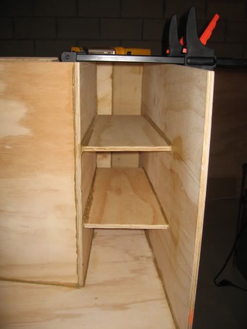

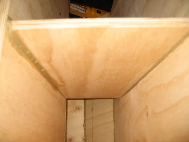

Welp! After thinking about it more, I just decided to PL it. I also used my gloved finger to smooth and push it into the gap from the top and bottom.
Forgot to mention, yesterday I glued in the panel 8/9 reflector using some more creative clamping techniques.

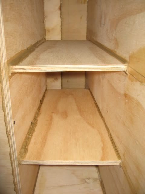

Both panel 6/9 braces installed. As mentioned previously, I filled the gap with PL. It appears to be a pretty darn solid joint! The final panel (10) will be installed tommorow. Than comes the bracing and other side installation.

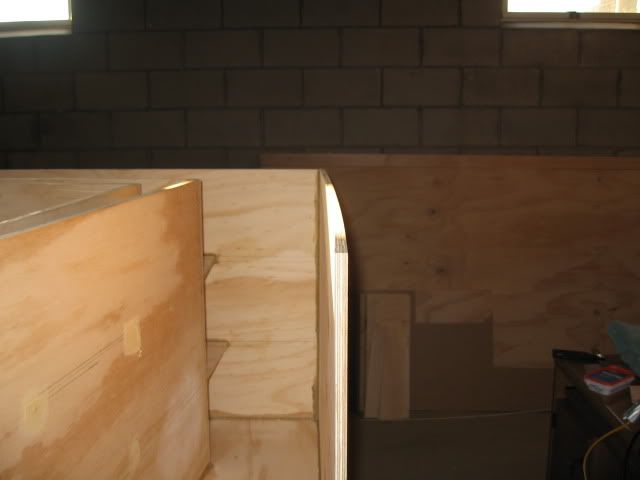

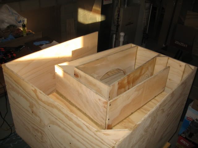

I installed Panel 10 today. It' is noticeably warped on the top side opposite of where I glued today, even to the naked eye. Tomorrow I'm going to install the panel 9/10 Reflector and see if my precut (36x36) opposite side panel fits. I have a feeling I may need to either do some mass clamping/squishing on the sides or perhaps recut out the side panel for it to fit.
Tommorow I'm going to Ace Hardware too to check out the Varathane Cabrenet. I am thinking about doing the same think MaxMercy did with his, using duratex in the mouth area and stain everywhere else.
When's the best time to Duratex the mouth area? After the vertical mouth braces are installed but before the other side panel is glued?
