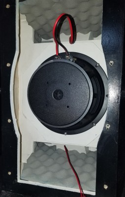

It's probably too dense and will over damp the cab.

by howiez
Well, this foam is too dense, but here is where I was last night before I discovered my module screws were a gasket too short to engage the T-nuts... Anyway it was looking good. listened a bit with module 'stuck' in place with my sticky foam gasket. I bought a mattress pad today to replace the pictured foam, but it's unravelling/expanding for a day.

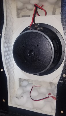

by howiez

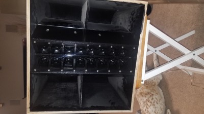

Ok, I have new foam now, seems soft/open cell enough.
Got the two modules buttoned back up, and started a listening test before I finish the ousdie of the cabs. I had one done and was listening while I wired the other. Thought is sounded good but I wasn't blown away. Then I plugged in the second and it was incredbibly brighter. So now i'm stumped. I tested a butload of piezos. I tested each array after they were all soldered up and they both seemd to sound the same. They both work, but one is much louder/brighter than the other. Now i'm thinking I have a bad component in my crossover. Since I have them bi-wired, i moved my cables to the other jack and switched them both over. Same sound, same volume. I guess i'll be tearing back into them...

Seth, i'm pretty sure i've ruled out phase and wiring to the module. I can direct wire them with position 2, and I pulled the wires and bypassed the switch. Both cabs sound identical to me, and my 24yo son said he can't hear a difference. I'm pretty sure I either melted the high pass capacitor while soldering or hot gluing to the board, or i have a bad component. It's always possible I swapped the two resistors by accident. They are physically identical and my old eyes may have missed the lable while hot gluing LOL. That we'll check as we pull that crossover back out to test this weekend.

And the mystery is solved. I had swapped the two resistors in my circuit. They are marked with microscopic values my old eyes can't read and I must have nudged one while i was hot gluing and grabbed the wrong one. I've desoldered and reversed them. Time to fire them back up and confirm with a test. Since (if i understand correctly) those resistors are attenuators, I inadvertently made a massive attenuater by swapping them....

They're not attenuators. High pass filters don't work with piezos, because they're a capacitive load. The 30 ohm resistor provides the filter with a resistive load that allows it to function. Placing the 4 ohm resistor in that position would have raised the filter knee frequency. Piezos also have falling impedance with increasing frequency, approaching a dead short at ultrasonic frequencies. The 4 ohm resistor provides a minimum 4 ohm impedance to protect the amp from runaway oscillation at those frequencies.
