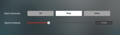

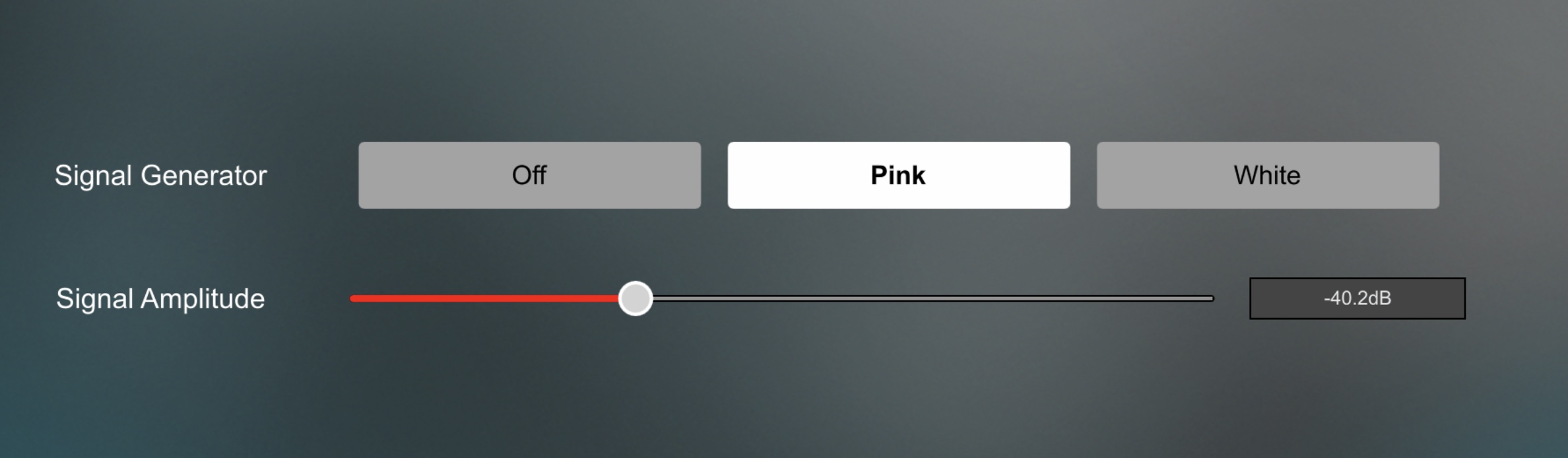

pink noise setting.

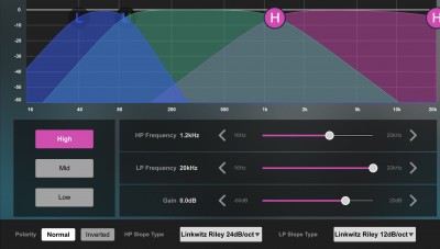

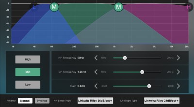

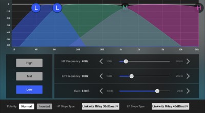

#137 Post by RYNO20 »
These were the xover settings at test.
Sub was off
Right channel was off
EQ was off
Only thing on was xover and limiter.

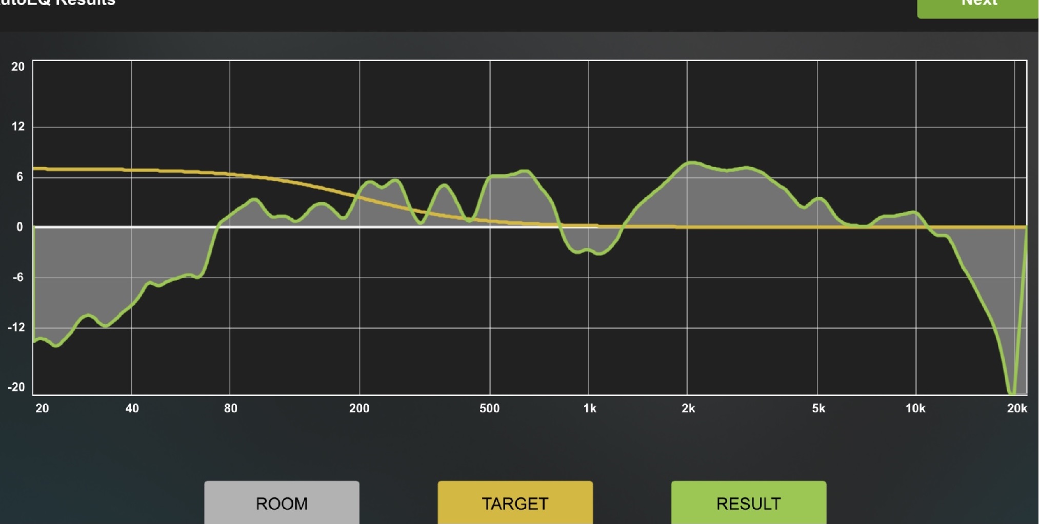

This is what running the wizard EQ auto set
With all speakers going.

RYNO20 wrote: Tue Mar 09, 2021 5:52 pm D102E189-9CEC-48C4-9ABE-CB211A2516A7.jpeg
What curve did you chose? Flat, Band, Vocal? They may not call it that - some of the DRs use a name and others just show the curve. What were you trying to achieve?
Venue

I'm talking about the target curve that you are trying to achieve. Do you want the system dead flat? Or with a low end bump, a pull back in the 200 region, and a gradual decrease in the high end.....that's the "band" curve. I haven't used the Venue, but it should let you choose what kind of EQ curve you are wanting to achieve.
I have no target curve because I have no idea what it needs to be .
Yes it will even let you use a finger and draw a curve , but i tried the flat and didn’t like it , tried all of them on same song cd and one called venue sounded best.
That’s why I wanted to build DR 280’s or 250’s with horns for less distorted sound, which I accidentally accomplished by taking the cabs I have off the 1200 watt per channel amp to the 400 watt amp made a real difference.
Also played with the subsonic synthesis thing and wow it really makes that T-48 blast out the bass , enough that I can see limiter being tagged with the red light on DBX and yet the volume bar graph is nowhere near 50% .
Do you know... Is the green trace the measured response or is it the correction needed to meet the target curve (yellow)?

Seth wrote: Wed Mar 10, 2021 8:07 pm
Know is the key word lol hell no.
But it seems that’s what it means. Anybody out here got a DBX PA2? And can tell us?
