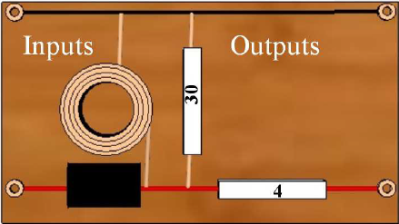

It does point to a too low impedance load, but I don't see how that could be. I don't recall how you're running it and don't want to search the entire thread, is it bi-amping just the SLA? If it's the tweeter high pass at fault one explanation is if the 30 ohm resistor isn't connected at one end. Without that connected at both ends the filter would present about a 1 ohm load to the amp at 5kHz.

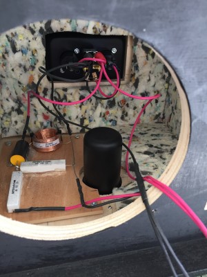

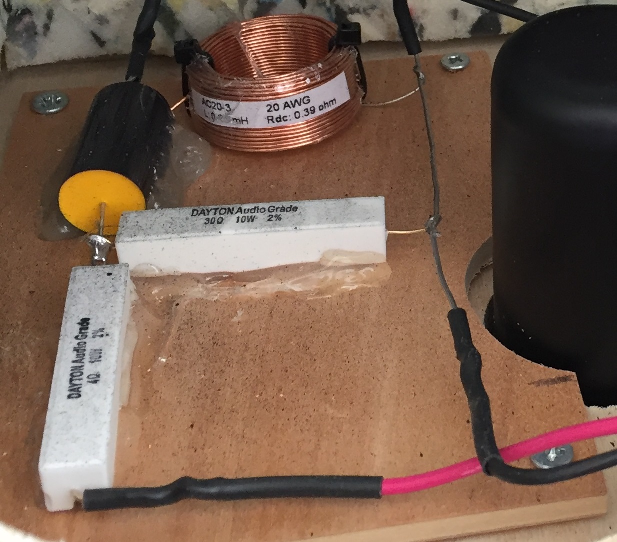

That picture seems to show the coil connected to the wrong end of the cap.

Re: SLA Pro - Powered
Actually... the coil is on the wrong side of the capacitor, isn't it? Looks to me, that could very well be the issue.

Hah! Missed this post.Bill Fitzmaurice wrote: ↑Sun Apr 11, 2021 1:25 pm That picture seems to show the coil connected to the wrong end of the cap.

I've lost track of who's cab that is, but if the coil is connected to the input side of the cap it's a miracle that it works at all.

That's mine and it indeed looks like the coil is on the wrong side of the cap......how the hell did I do that?Bill Fitzmaurice wrote: ↑Sun Apr 11, 2021 1:54 pm I've lost track of who's cab that is, but if the coil is connected to the input side of the cap it's a miracle that it works at all.
Starting to feel like a real newb.......
