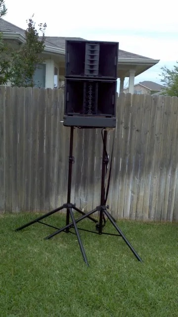

Keryn O'Shea wrote: Fri Apr 21, 2023 4:39 pm The Eminence adjustable top hat pole socket seems to be unavailable... anywhere. I don't like the idea of bolting a flat adaptor to the DR ground stacking bracket unless I welded the whole stand together for stability, even then I think it would be unstable. Apart from giant tripods like ACUAs, any ideas?
Yep, two stands a side with a flat piece of thicker ply between.
Add eye bolts to strap the bottom cab to the platform you've created.
Use the flat bolt on stand adapters on the bottom side, one per stand.
Twice as stable arguably.
Set up the stands so that the leg aiming at the cabs centre aim at each other.
That leaves the other two (outer) legs facing forwards and backwards for stability.
Find the cab centre of gravity for best positioning on the platform.
Use the floor stacker plate to adjust the face angle. If you do that, don't strap the ratchet straps down quite as firmly, or something will let go...

If you go to this link, on the 16th page and scroll down....you'll see how Mike D. did his.
viewtopic.php?t=19214&start=225

Bruce, probably where I'd seen it but forgotten! All credit to mike.
Of course, much easier as well with Otops rather than DR's...

From that thread

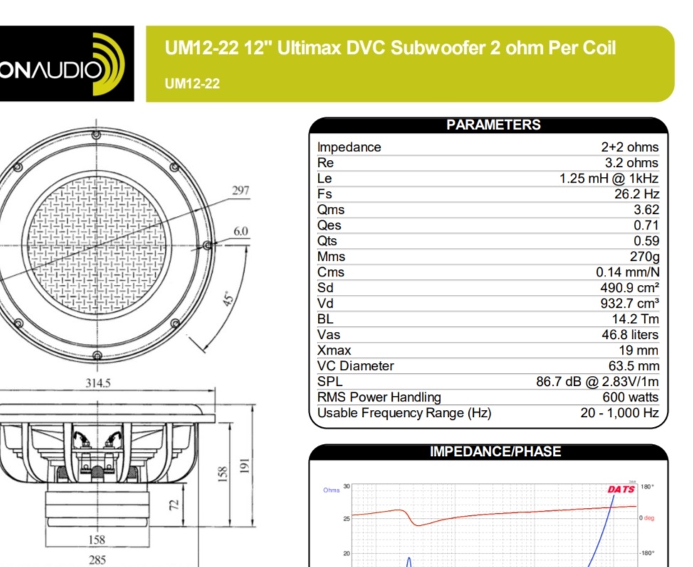

Good evening, would this 12" driver be considered Pro audio? Qts is off, looking for a Lab12 substitute available here, for T30. I feel it may not be up to the task..?
Re: Australian Options - Suppliers / Drivers etc
#144 Post by Grant Bunter »
Keryn O'Shea wrote: Fri Jul 28, 2023 3:29 am Good evening, would this 12" driver be considered Pro audio? Qts is off, looking for a Lab12 substitute available here, for T30. I feel it may not be up to the task..?
Mate,
It's very like the specs of the Lab12C, which is outside spec compared to a Lab12
Having said that, enough forum members have used the Lab12C for their builds, seemingly with success. You have to pay close attention to impedance and need 2 ohm stable amps to run a pair of cabs per channel.
The Dayton Audio driver you've put up is hard to argue as a pro sound driver with it's 2 +2 voice coil which is more commonly associated with Car audio, but it might be worth trying to break one and find out if the price is right...
edit: voltage displacement limit in the plans is for the 6 ohm Lab 12. If you go with a lab12C or something similar like the Dayton you put up, limit is lower (with the same achieved max output). That makes it very difficult to mix and match drivers limit wise...

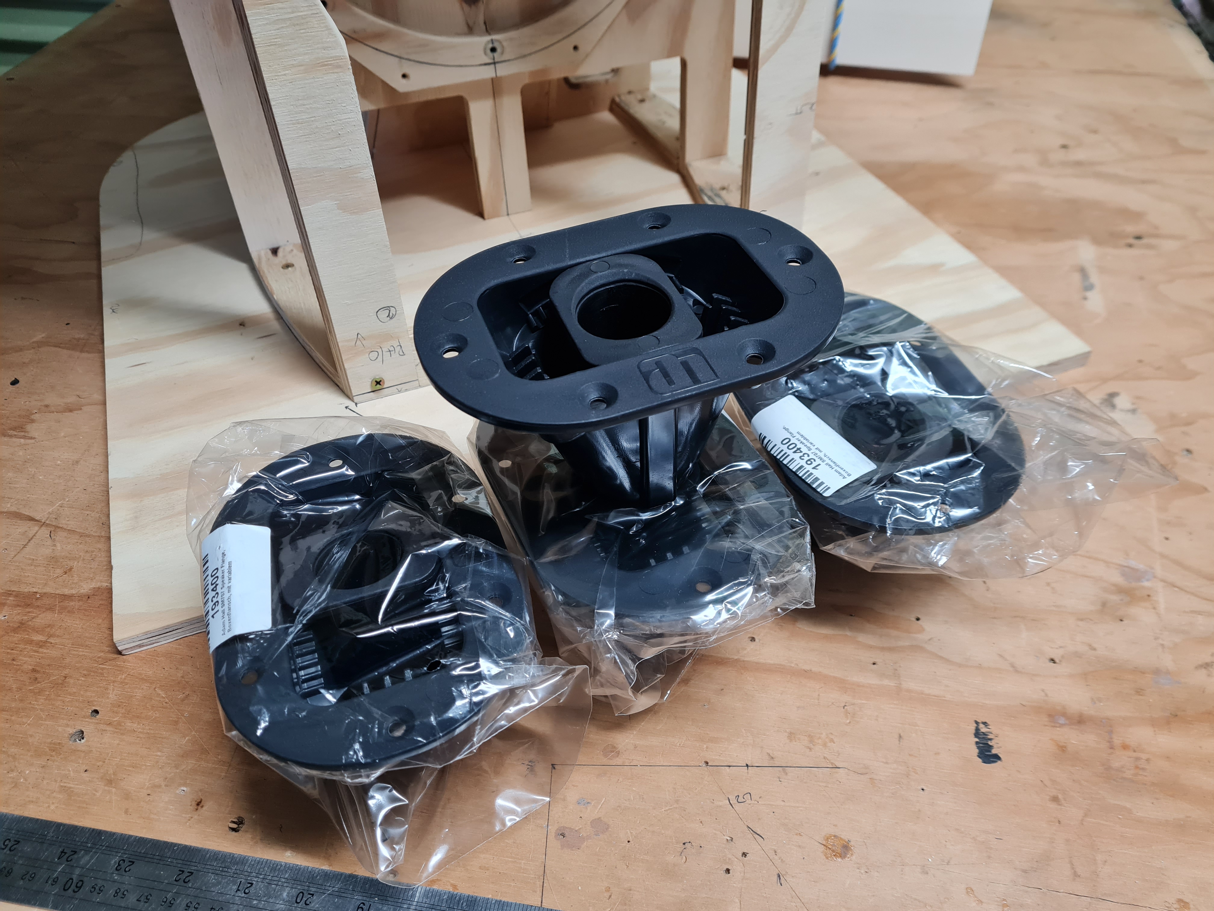

Good evening, here's where to grab the Eminence adjustable top hat
https://www.thomannmusic.com/adam_hall_ ... lansch.htm
If you really want them, don't look at the shipping price... or our dollar.. just press the button. I've ordered 4, and report back once they arrive.
