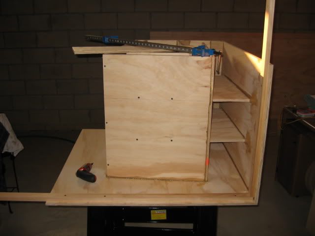

So yesterday I glued panel 9 to the THT. Since it's apparently going to rain all weekend, tonight I cut out:
- Panel 8/9 reflector
- Panel 9/10 reflector
- Panel 10
- Panel 6/9 braces

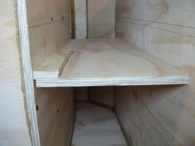

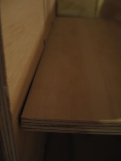

I test fit the 6/9 braces and discovered that panel 6 is pretty warped. I tried taking a bit off the brace to make it fit better but it still it didn't fit perfectly, having an 1/8" gap towards the wider side of the brace that gradually gets smaller towards the middle of the brace. The rest of the brace fits perfect. Unfortunately I think the only way to get this perfect would be to trace it which is going to be pretty hard if not impossible.
With that said, Do you think I should just add some extra PL and let it do it's work? Will this cause any issues structurally or vibration wise?
Here's some pics:
Getting Panel 9 ready:
Panel 6/9 Braces prefit:
Posts: 7687
#125 Post by Tom Smit »
Let PL do it's work :D
gdougherty
Posts: 2623
Location: Denver, CO
#126 Post by gdougherty »
That's why I use the braces to square up the panels as I build. The installation and bracing on the other side of 6 should have straightened 6 out unless you had to bow 6 in to meet that corner.
PL will hold it as is.

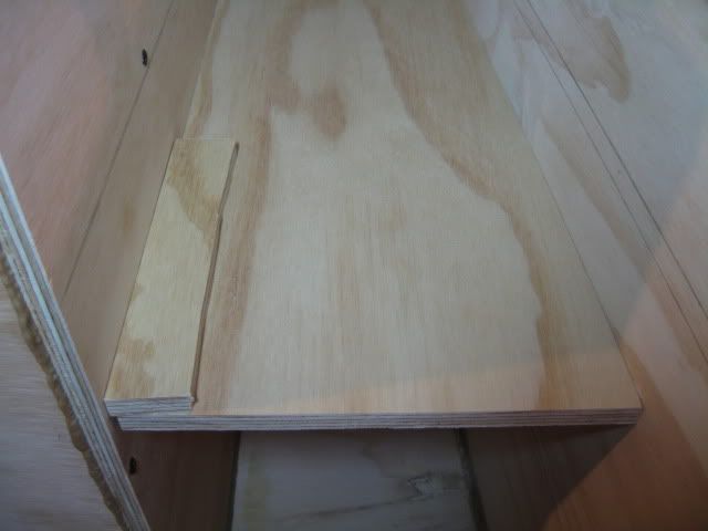

So if my interpretation is correct, it should look something like this (below)
Should I glue/secure the scrap piece to the brace first while test fitting and than proceed to secure the entire brace + cleat/scrap piece to the sides of the panels like normal?
I'm also assuming this extra bump in the bracing won't cause disturbance or extra turbulence in the mouth path?
Posts: 29105
#135 Post by Bill Fitzmaurice »
myn wrote:Thanks guys.
More trouble than it's worth. PL and forget it.
