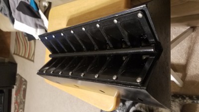

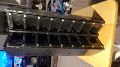

Module wood is pretty close to ready.
Sanded and applied putty, sanded that and painted and finse repeat ad nauseum. Still not smooth enough. I should just bite bullet and Duratex. I wasn't planning on Duratexing the mouth so I thought it might look funny.

Looks decent enough to me. What are you using for filler?

Seth wrote: Mon Mar 07, 2022 8:00 pm Looks decent enough to me. What are you using for filler?
Bondo spot putty

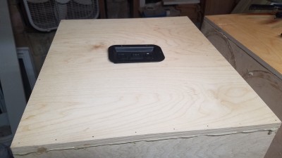

backs are glued on, so this weekend I hope to flush cut, round edges and fill nail holes. Then a coat of flat black and duratex.
Maybe I can get drivers installed and fire this project up this year...lol.

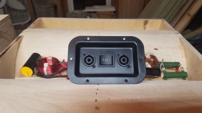

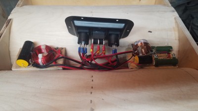

What is the switch for? Active vs passive tweeters?
Re: HowieZ DR200 build
Posted: Fri Mar 11, 2022 1:05 pm
by Bruce Weldy
matmonster58 wrote: Fri Mar 11, 2022 11:24 am What is the switch for? Active vs passive tweeters?
I'd assume it's for running bi-amped or through the passive crossover.
Posted: Sat Mar 12, 2022 9:18 am
by howiez
Bruce Weldy wrote: Fri Mar 11, 2022 1:05 pm I'd assume it's for running bi-amped or through the passive crossover.
Bruce FTW! I wanted to try crossovers, but also wanted to experiment with bi-amp since my Driverack can do L/M/H. If you're gonna be a bear, be a Grizzly? Nah, I just like to tinker!

Bi-amping with piezos gets you almost nothing. Because they're high impedance they draw very little current, so they consume very little power. The only potential benefit is if your amp is undersized, causing high THD. If that's the case bi-amping will be cleaner, but considering the sensitivity of the DR200 the amp would have to be 20 watts or less for that to be a concern.

howiez wrote: Sat Mar 12, 2022 9:18 am If you're gonna be a bear, be a Grizzly? Nah, I just like to tinker!
Then chunk the piezos and put in the compression horns.....Lower crossover and you can bi-amp to your heart's content!

The DR200 HF horn is too short for less than 2kHz use.

Bill Fitzmaurice wrote: Sat Mar 12, 2022 2:06 pm The DR200 HF horn is too short for less than 2kHz use.
Yeah, I was thinking 2.5k for the piezos.....but, no.....

Bill Fitzmaurice wrote: Sat Mar 12, 2022 12:05 pm Bi-amping with piezos gets you almost nothing. Because they're high impedance they draw very little current, so they consume very little power. The only potential benefit is if your amp is undersized, causing high THD. If that's the case bi-amping will be cleaner, but considering the sensitivity of the DR200 the amp would have to be 20 watts or less for that to be a concern.
Well darn I was having so much fun. I didn't figure power would be the issue, in fact probably silly for me to use a dedicated amp for piezos. I was only thinkging about the digital crossover in the PX2, simple as that.

One array module mounted and ready to seal a woofer chamber.
