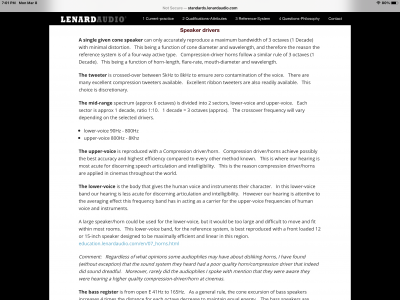

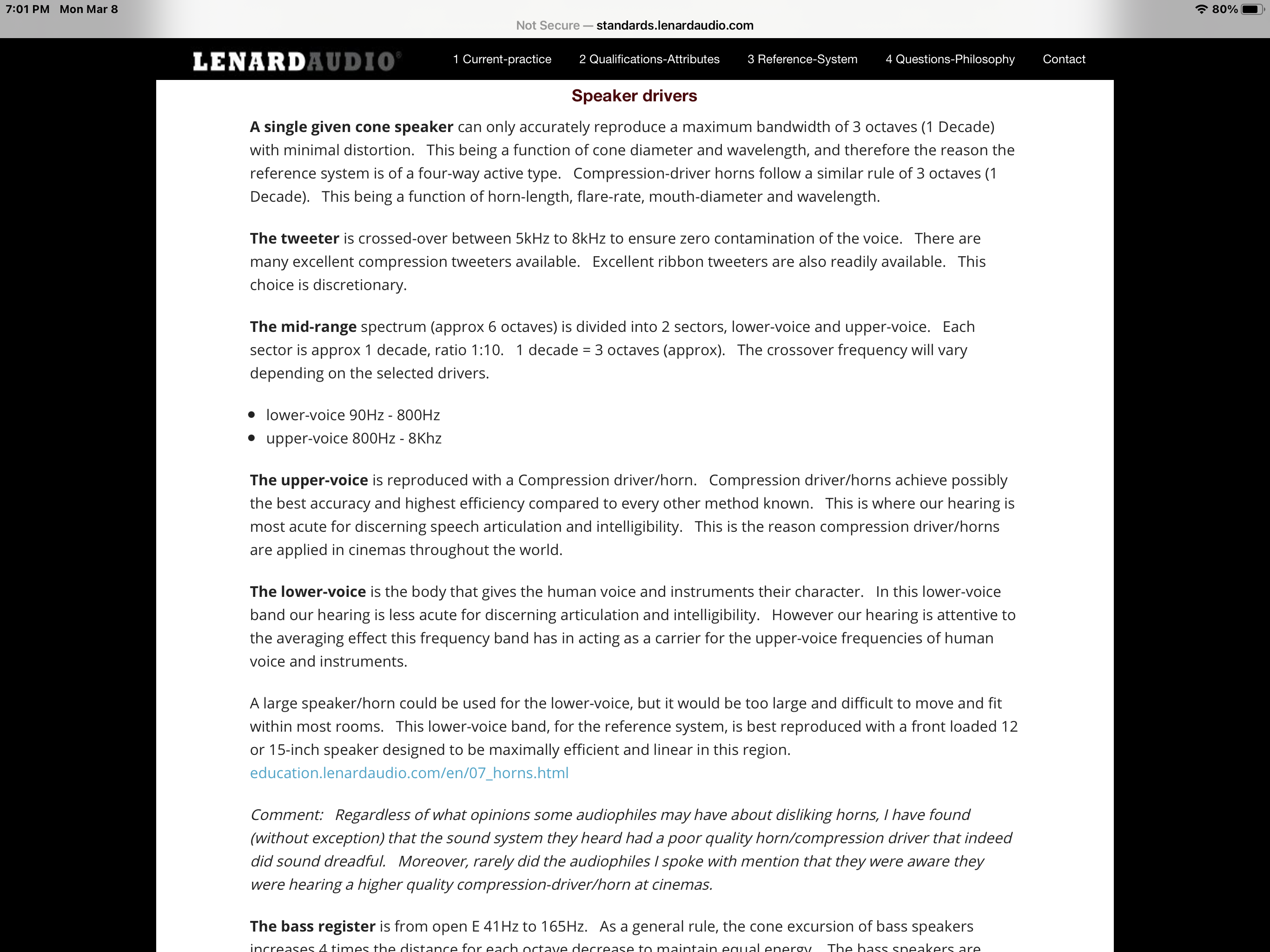

I’ve used this Lenard Audio advice for my experiments
That’s where I’ve got 15 inch woofer on my brain from and large compression drivers.

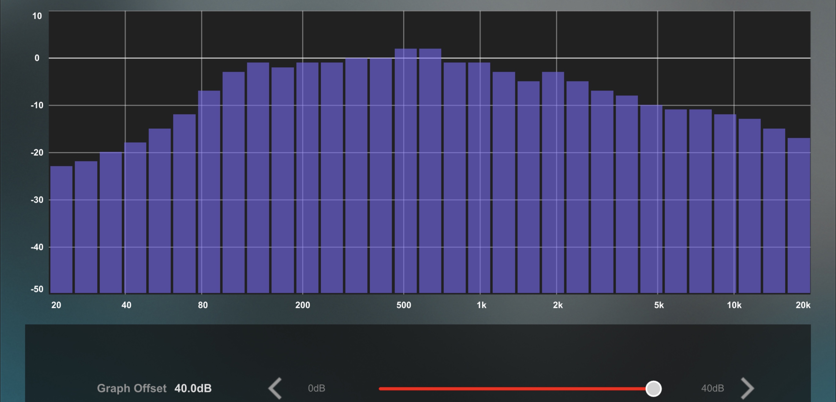

this is in shop with -40 db pink noise left channel woofer and comp driver
Did this come out like did I do it right?
39 inches in front of woofer.
It says in instructions that there are six different graphs opt1-opt6 but I don’t see how to select them.
