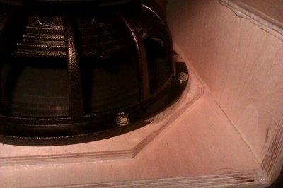

No I haven't dragged it outside. I've taken the view all is ok, since the second one has come out the same, apart from a very minor leak round the driver perimeter to which I applied PL in a momentary faux pas, see photo. Should have used sealant.

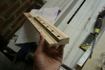

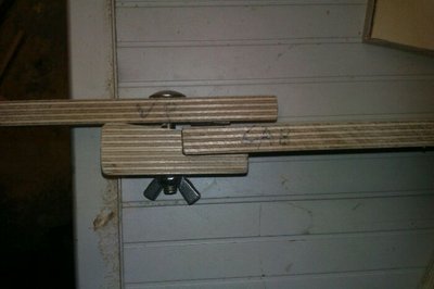

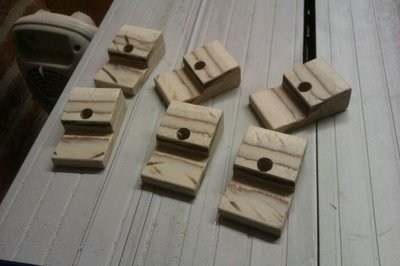

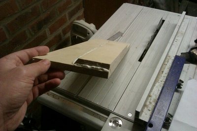

Made said V plate clamps. Bought 10-off each of M8x50 coach screws, large washers and wing nuts from screwfix for just under 6 quid. Bargain. So wanted to get on with clamping feet to prove it would work.
Photos:
- raw material, 2 bits of 12mm scrap glued together.
- after a bit of 'machining'
- 6 clamping feet
- coach bolt and clamp in action
- rubber feet on.

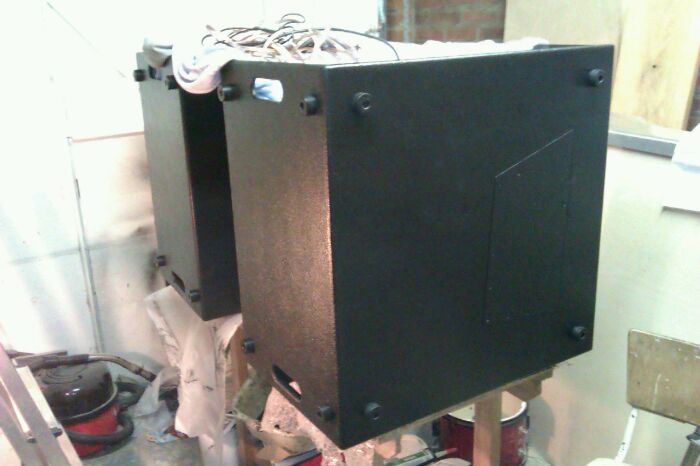

I believe the plans say the v-plate doesn't have to be perfectly flat (although it must be :wink: )
That Tuff Cab looks really good. Looks nice and even in the pics. Makes me dread looking at my bare cab till I get the other built.

You'll probably want to put the wing nuts on top instead of below....it's a pain reaching under there for the back ones.
