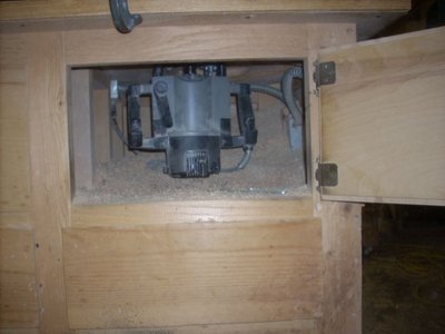

While we are at it, if you are thinking of having a dedicated router under a router table, this big Porter cable is a real workhorse. It has outlasted every other router we have tried and this one is worked as hard as any we have.

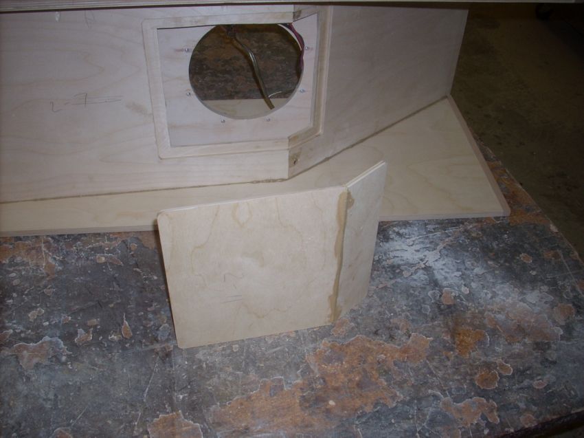

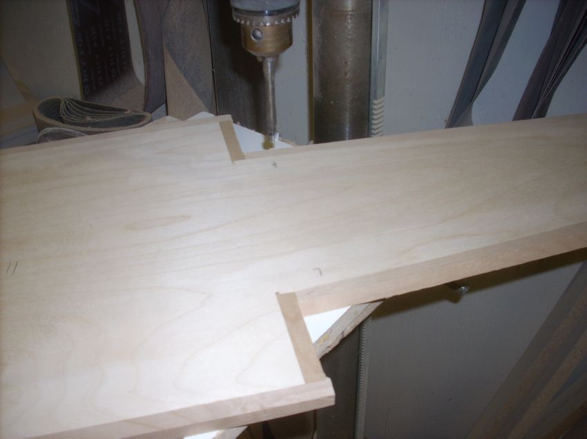

Here is the rabbit cut out on the skinny side.

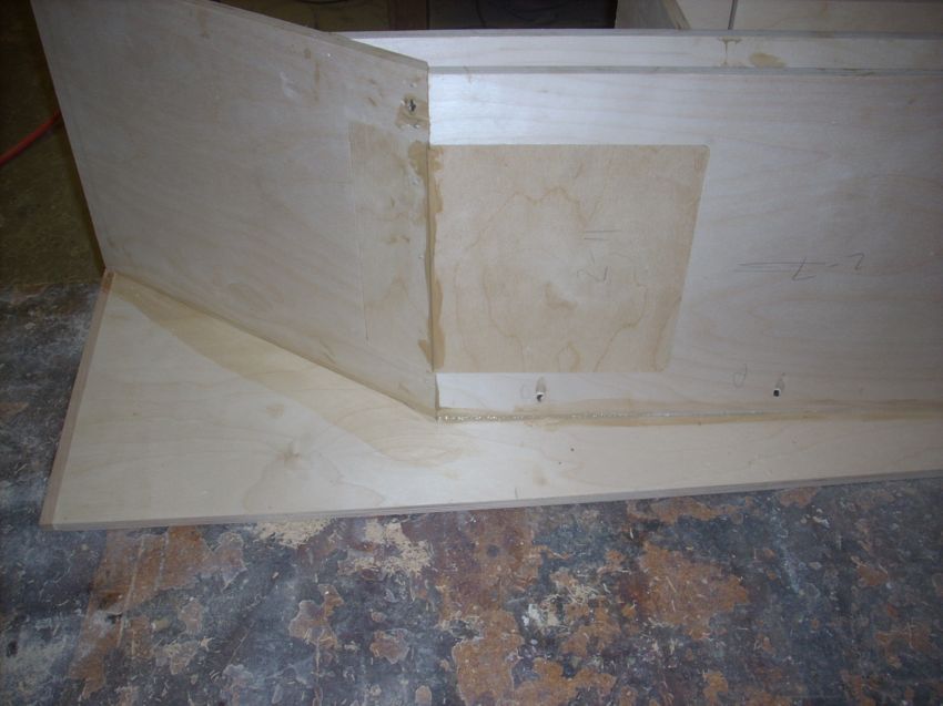

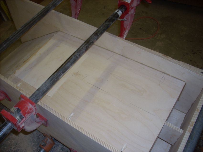

Now it is time to get those angles right - both pieces were just a little long. So it was many trips back and forth to the edge sander, slowly getting those angles just right. This panel will need to be air tight, so the fit needs to be on the excellent side.
After getting the angle and size right, it was time to put on the PL Premium and throw a few pins in to hold it together. I was very careful to only get it on the joint so that I could leave the pieces in so that they dried at the right angle.

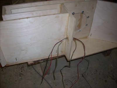

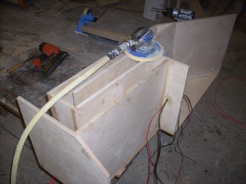

Next was adding the hole for the speaker wire into the top section.

Next was putting on the other side panel.
I hit the top edges with the pad sander - this sander has a fairly stiff pad so it works pretty well to flatten things out. Be careful doing this, it is easy go overboard and sand in a low spot. Low spots are a no-no, but knocking down that high spot is good.

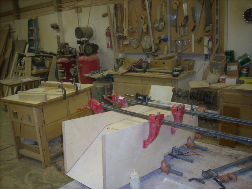

Had to dig out our horrible deep throat clamps. They are cheep Chinese junk and are super stiff. Basically have to hit the ends with a hammer for them to slide up the pipe. Thought I was going to break off the handle when trying to tighten them up. Hit them up with some tri-flow oil and that did help a bunch.
But they reached into where they were needed.

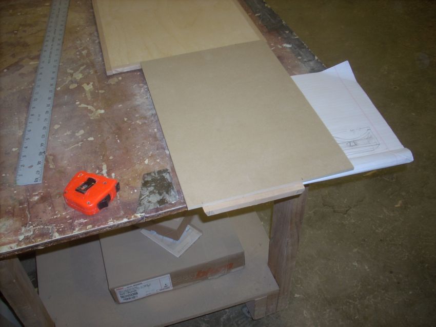

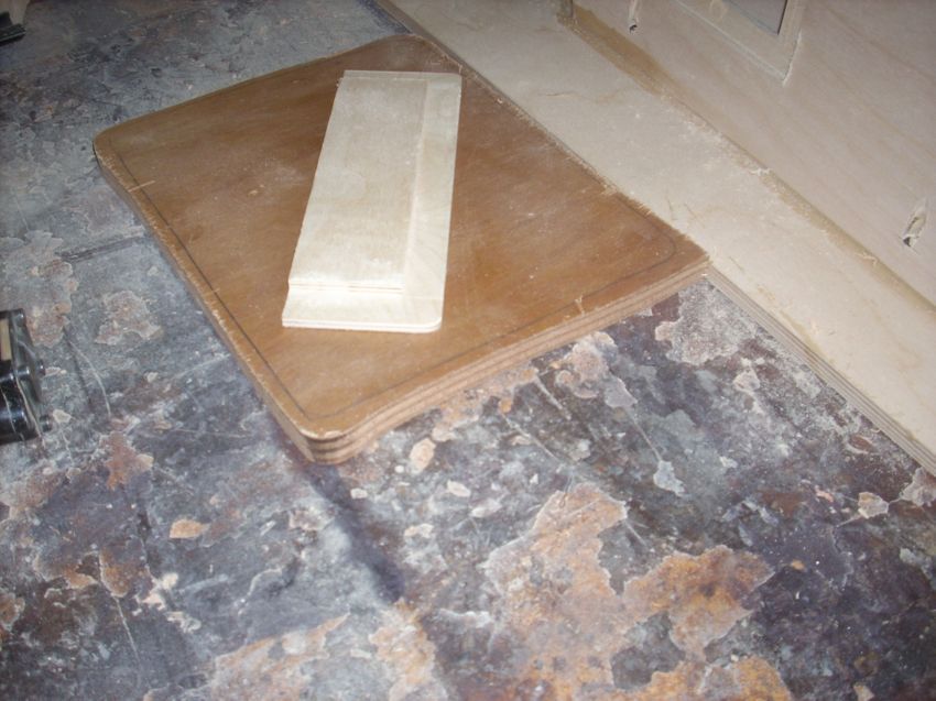

Last thing for the day was the pieces for the grill cover.
Laid out the size based off the front panel.
Marked the angle and rough cut it on the band saw.
Of course, the finished edge was straitened out by sanding to the line on the edge sander.

#130 Post by Boyd »
Umm, i could be wrong, but are those T nuts on the wrong side of the baffle?
2x Titan 48 18" wide 3012LF loaded
2x Otop 12 J-Array 3012HO Melded
Building:
2x Titan 48 36" 3015LF
But it Hertz
Re: Davids for Tom
#131 Post by But it Hertz »
He has the access panel on the horn side because he didn't want to be able to see it from the outside.
