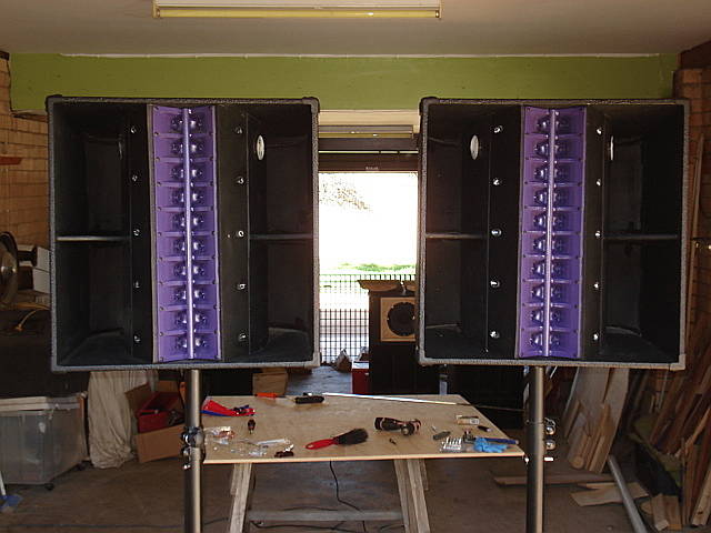

Cab 1 is now totally done. I used 3/16" T nuts for my modified module attachment.
edit: initially I was going to use coarse threaded hex head screws. They stripped out the radiata ply putting them in. So went to the T nuts.
Fully painted and all corners on.
As we speak, Cab 2's second coat of Rockard is drying and awaiting a module implant. Then just corners to go and this will be done as well.
Pics to follow.
I've decided these and the extra 2 x T39's will be finished before any further continuation on the 3 x W8's
Re: 2 x DR250 build, mostly based on March 2012 plans
#126 Post by Grant Bunter »
Ok, both of these cabs are complete as of today.
I was right, about three hours to get to here to finish Cab 2.
I'll let whoever is interested do the addition for time taken.
Please factor in the following for your own build:
I take a car out of the garage, set up tools, do the work, put away tools and then clean up, in each time segment mentioned. So if you can just get into it and only cleanup each day, remove about 15 minutes from each day of building from my time.
There is also a couple of hours involved in fixing my effup, err mistake, as well as doing my method of setting up and attaching the module(s).
I have an end result:
Testing and reconfiguration of my DCX (due to more T39's) in the next few days...
