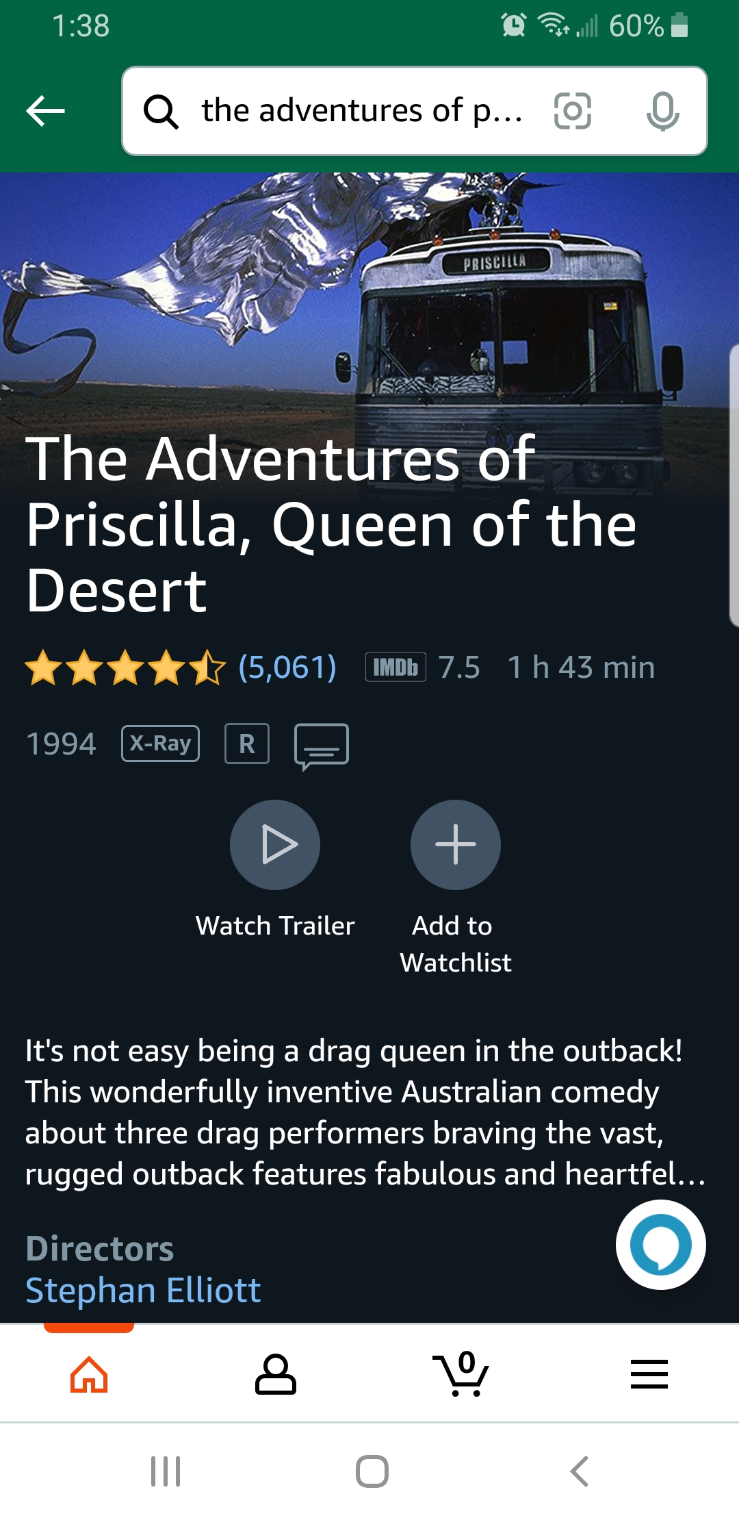

Definitely the womans firetiger leotard Seth! Though we have a different Priscilla here, it's actually the name of a bus in an awesome Australian movie.

Oh my... this bit of conversation has become even more humerous than I originally thought. I was thinking 80's hair band spandex, not drag queen spandex.
Added to my watchlist
