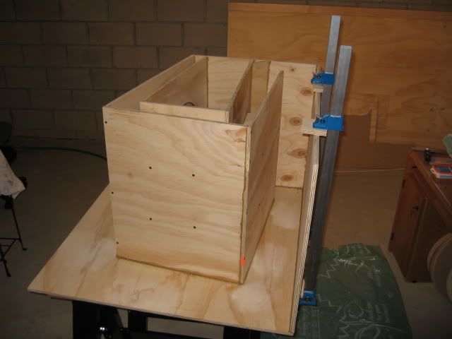

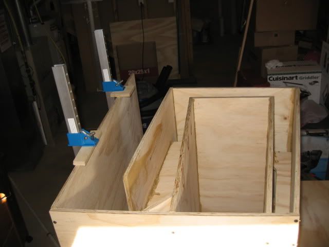

[== 07/16/2009 ==]
Brace 2/7 and Panel 8 Installed.
