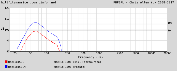

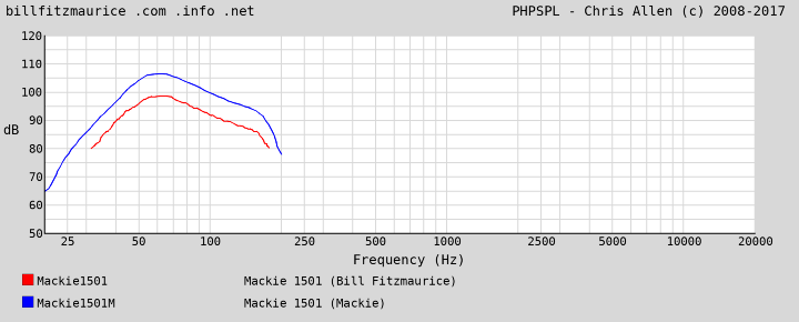

I don't understant Mackie1501 and Mackie1501M charts, because Mackie1501M chart is much more better. And one chart shows (Mackie), another (Bill..), which to belieave? What the difference?

harolis wrote:I don't understant Mackie1501 and Mackie1501M charts, because Mackie1501M chart is much more better. And one chart shows (Mackie), another (Bill..), which to belieave? What the difference?
Thanks.
It may have my name on it but the source was Mackie. All I did was to transpose their chart.
Re: Introducing SPL Chart
#114 Post by Chris_Allen »
The chart from Mackie's original documentation was stated as 1W/M and transposed by Bill. I sampled from Bill's hence the accreditation, the chart disappeared from Mackie's docs but then reappeared having gained 7dB. The new chart is stated as 100dB @ 100Hz reference, so I'm not sure if they were trying a marketing trick to make the cab look better.

harolis
#115 Post by harolis »
Thank You, Chris_Allen. Clear. :clap:
The chart can be found on page 11 of http://www.mackie.com/pdf/swa1501_om.pdf
Tomfoolery afoot. :cop:
I used the original Mackie chart as my source, it was 1w/1m. Their 'new' chart is not 1w/1m, and is as useful as tits on a bull. Speaking of bull... :roll:
