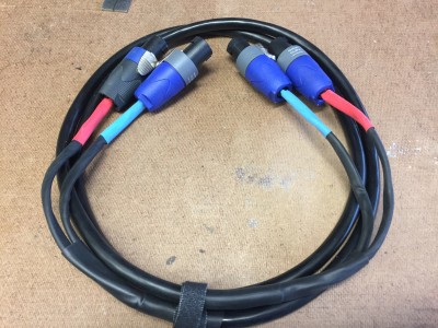

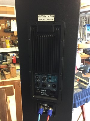

Got in my end of year supplies order......it was time to re-stock on connectors, etc. Picked up 6 ft. of 4 conductor speaker cable for the roundtrip path from the amp to the sub and back. 3 new NL2FX and one old NL4 (used pin 2+- for the output of the sub). I wired the pin 2 output when I had help on running my PA and I didn't want someone to hook it up wrong - this way, if it was wired wrong, it wouldn't work. So, I just left it. Thus, the return path is wired pin 2 on the sub end and pin 1 on the SLA end. It's a special cable and won't be used for anything else.
I labeled the Jacks, the switch, and the Amp presets (above the amp).
So, it was time to take it out and fire it up. Used a bunch of songs to get the EQ curve set for both Con Sub and Sin Sub (that's Spanish for with and without - hey, I'm in Texas, right?)
The SLA full range isn't bad at all. The sub helps to round it all out of course.
I'm not real happy with the amp. When I was first messing with it, it would cut out with a loud pop if I hit it too hard. I had turned on the limiter when I was first checking out the amp, so I figured that was it. When I started the real setup, I turned off the limiter......yet, it still did it with too much input. I was running direct into the 1/4" input from my iPod. I hope it's just an input limiter of some kind because I wasn't really pushing it all that hard. However, it did it once when I was testing it with the bluetooth input.....
Next test will be with a mixer in more of a real world setting. I hope it has the juice to get a little volume out of it. It's rated 400 watts at 4 ohms, so this rig is getting about 200. It should be getting louder than it is without clipping. Hopefully, with the correct balanced input, it will give me what I want. If not, it will be back to an amp and a driverack....

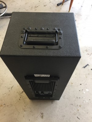

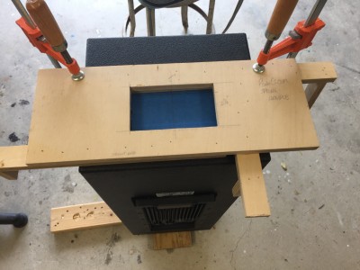

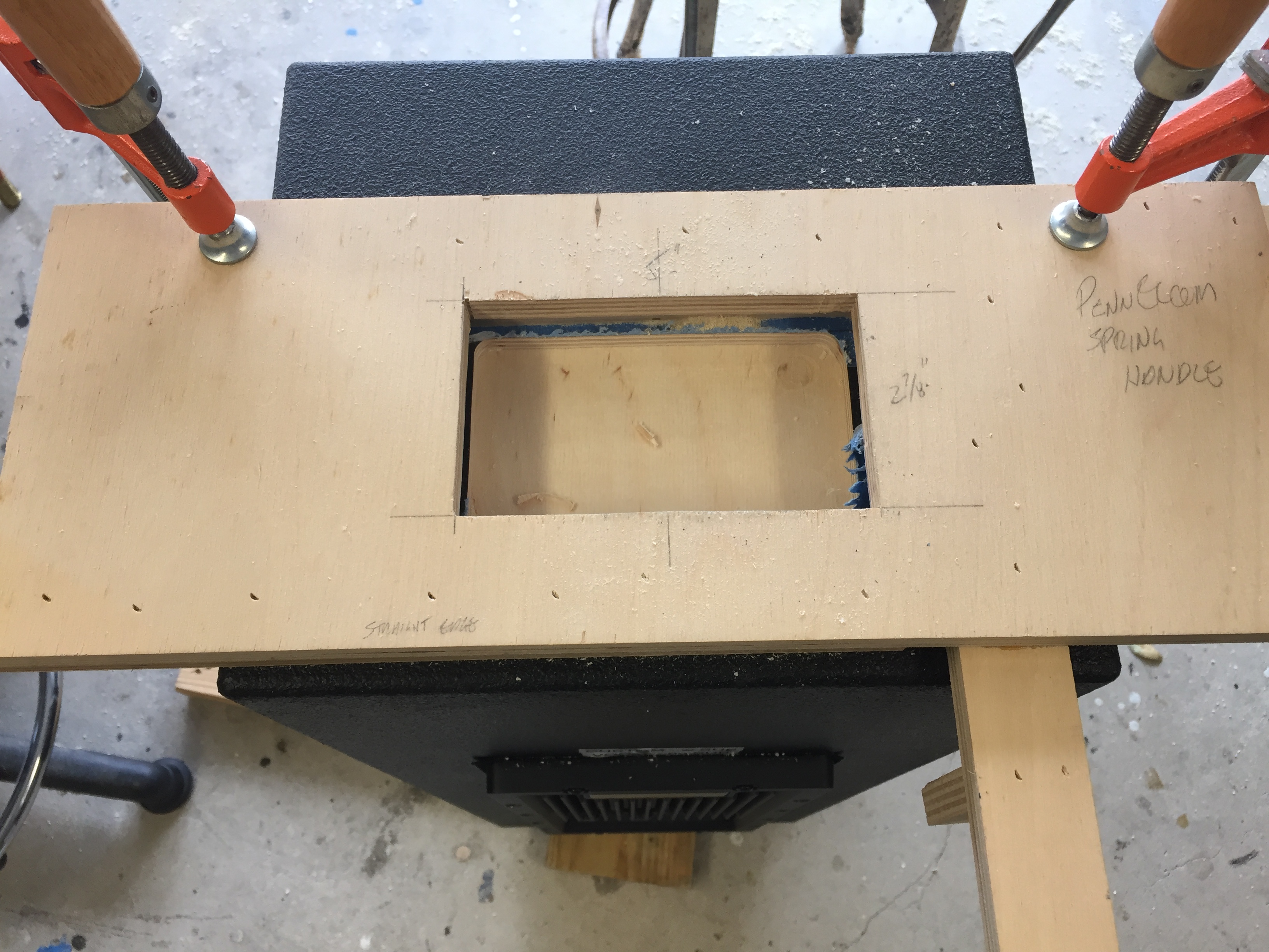

Getting ready to take out the Bose Killer on its maiden voyage tomorrow night. The SLA is really not an easy cab to move. The port/handles just don't work for me.
Fortunately, I've had an extra brand new Penn Elcom spring handle laying around the among the speaker building parts.

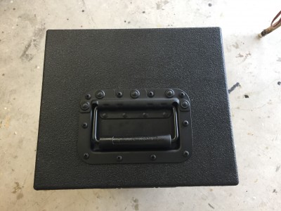

So, I drug out the router and my trusty template that I made years ago for putting handles on the top/end of my Yamaha monitors.....the handle location on them sucks.... Just did some measuring to get it where I wanted...... You'll notice that it's not centered on the top, but the pivot of the handle is. I figured that made more sense, since that's where you are lifting from. Now, I'm gonna' re-write that sentence because I just have to do this.......
I figured that made more sense, since cents are what aesthetics are worth and usability is worth dollars. Sorry.....but, how often do you get the use three different words that sound the same right in a row?
Moving on the the glamour shots......
Now to figure out how to get that T24 in my truck.....I think I'll enlist my wife.
