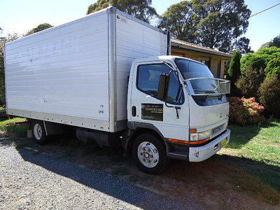

I have an 8 tonne pantech for my gear.
With generator, drums, backline sometimes (and a bed), I need that space. Mostly speaking, in the truck, I haven't started going up yet, so it's no stacking to this point...

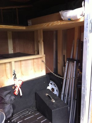

My whole rig - 6 subs, 4 tops, 6 monitors, amp rack, two mixers, mic box, cables lights, etc....all fit in a 6x10 Haulmark. The key is measuring the actual footprint of the trailer, then measure your gear. Build partitions to fit your gear.
I first built an L-shaped wall that allowed me to have a little compartment that was accessible from the side door....that's were the mixers, v-plates, mics, speaker stand, spare amps live. The subs start lining up on the other side of the wall. Later, I built an L-shaped shelf that goes over the subs the the end of the trailer that's accessible from the door to put my stools, tire jack, canopy, etc.
Everything has it's place and gets packed the exact same way every time. There are only two tie-downs needed to keep everything in place. I could go without them entirely, but I don't want stuff shifting around.

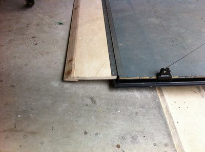

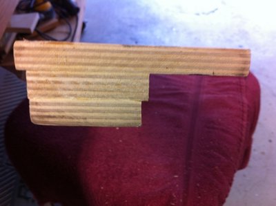

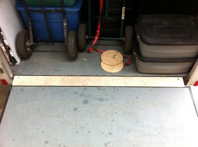

Also, build a ramp to flip over the end of the trailer ramp....(definitely get a trailer with a ramp and not back doors) And a spacer to span the gap between the trailer floor and the ramp Just build up some scrap BB to make it. This is a shot looking in from the side door. You can see the wall and the storage bin above.

Grant, gotta say I like your solution. Pretty much ideal if ya ask me. I've gotta assume there's a lift gate. What's that across your windshield?

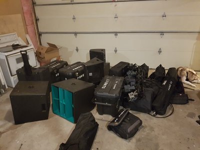

I used to say the same thing, who in their right mind would want to lug around a drum kit from party to party, now this is my typical load out NOT INCLUDING subs: (and yes I have to make room for the pooch, he comes along for load in) I, like you guys, am badly in need of a trailer. Load in/out at the gig is enough, it's too much to do again once you get home, and with subs I have to do 2 trips from the venue in and out as not everything can fit in 1 load in my truck.SethRocksYou wrote: ↑Fri Nov 22, 2019 11:40 am I used to point fingers and giggle at drummers... why on earth would you choose THAT as YOUR instrument? You gotta lug all those big cumbersome cases everywhere. CRAZY

No lift gate, just a ramp.SethRocksYou wrote: ↑Sat Nov 23, 2019 5:59 pm Grant, gotta say I like your solution. Pretty much ideal if ya ask me. I've gotta assume there's a lift gate. What's that across your windshield?

The "thing" is a windscreen saver. It's meant to stop stones and rocks making it to the windscreen.
It doesn't work, damned if I know how they get through the grill on it.
