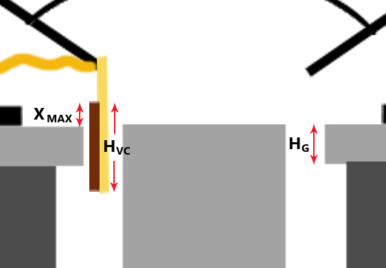

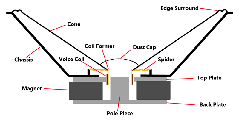

Take the LAB12 for instance, it's gap height is 9.5mm and the Xmax is 13mm. So, at rest, there is 13mm of coil above the gap, 9.5mm of coil in the gap, and 13mm of coil below the gap, which add up to a total coil length of roughly 35.5mm. So, the coil can move 13mm in either direction and maintain the same amount of coil in the 9.5mm gap/flux throughout the entire 26mm motion. Pushed beyond 13mm, say to 15mm excursion, now there's only 7.5mm of coil in the gap for the last 2mm of cone travel in either direction. Less coil in the gap equates to less length of wire in the gap, which further equates to progressively less and less coil in the gap the harder and harder it's pushed, taking more and more input for less and less output. But, again, in this scenario it only occurs at the last 2mm peak at either end of the entire stroke. The coil is still 81% in the gap at that peak and 100% in the gap for the next 26mm of travel until it gets to the other peak. Just on a hunch, I'd have to imagine that's not really that bad of a scenario. Perhaps quite common even. I think it's when people push way past Xmax that it starts to sound poorly and bad things happen. I could be wrong though.
Mathed out, the LAB12 has only 0.5mm of coil in the gap at Xlim.
Here's a cross section to help visualize it all.
Xmax, Voice Coil Height, Gap Height
Here's the pages they came from. Really good, quick, easy to understand reads. For sure recommend reading.
Xmax BL
