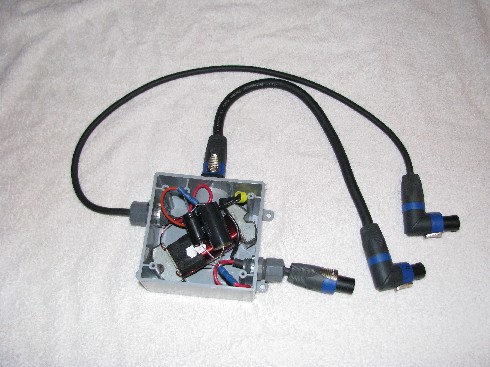

I've always wanted to try my J110 and T39 as a bass combo and I finally got a crossover built. I built it in an external box for flexibility. With a little trimming, the inductor fit just right in an FS electrical box. Pic below.
Anyway, the J110/T39 combo has a lot more bottom end than 2 J110s and sounds great in my garage. However, while testing I noticed something strange. I tried connecting the J110 and T39 full-range with no crossover and I can't hear any difference from the same pair with the passive crossover. Shouldn't there be an audible difference? Otherwise, why do I need a crossover?

You can't hear any difference because the low frequencies are omni-directional, so you can't tell where they're coming from, while midrange frequencies going into the T39 are filtered out by the horn bends and can't be heard coming out of it. If you had the volume high enough to cause the J110 to exceed excursion without the filter you'd hear that. But the secondary function of the crossover is to maintain an 8 ohm load; without it the speakers would be parallel wired and would be a 4 ohm load, causing the amp to deliver twice the current for no good reason.DaveK wrote:I've always wanted to try my J110 and T39 as a bass combo and I finally got a crossover built. I built it in an external box for flexibility. With a little trimming, the inductor fit just right in an FS electrical box. Pic below.
