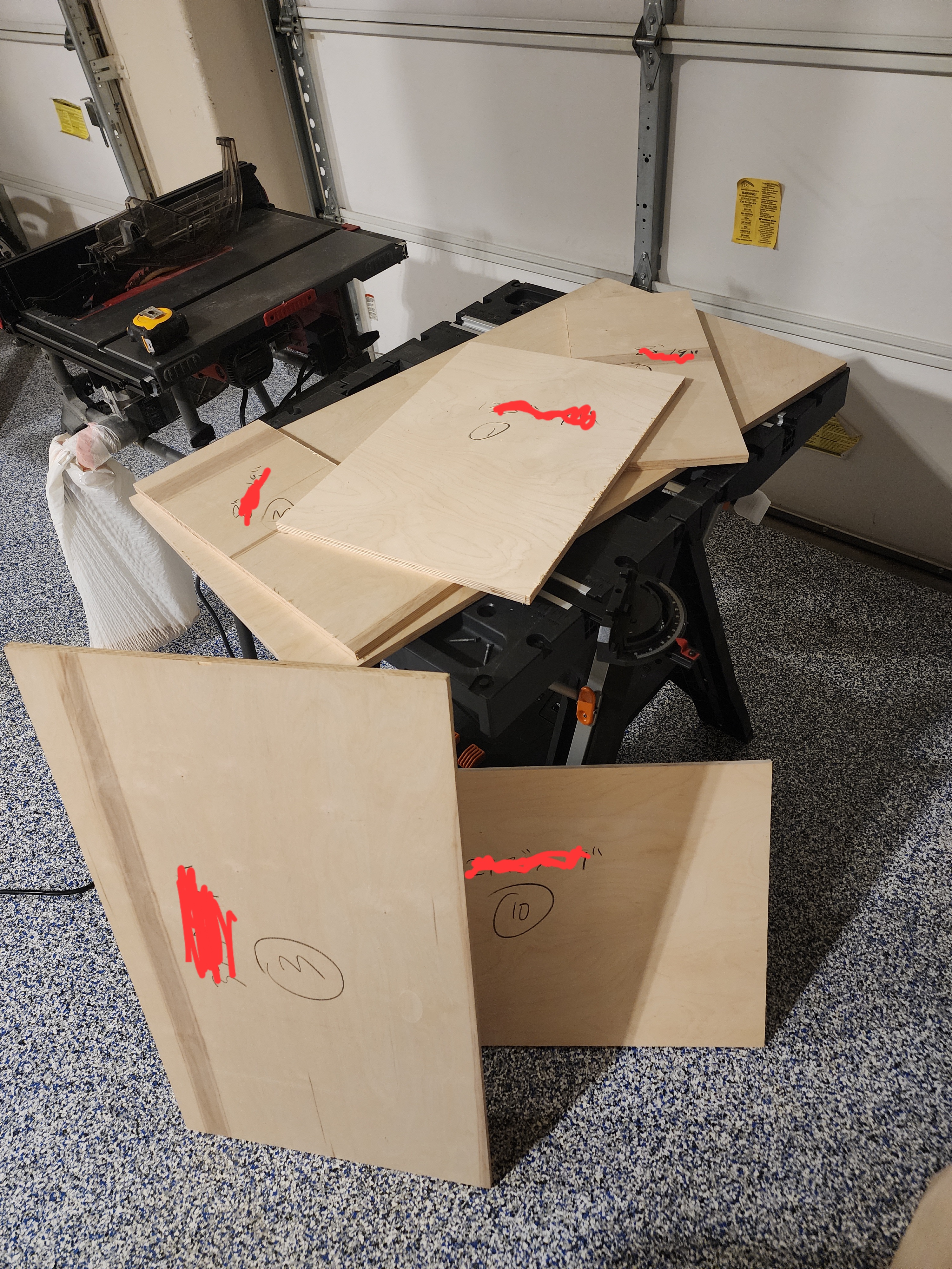

Started cutting some panels today, about 30% done. Definitely needed a second hand for these larger panels to be cut off the table saw so I had to call on my father.
A table saw definitely made things easier, I couldn't imagine doing this with a circular saw I feel like it would be Messier and take longer. Hoping to finish the panel rough cuts by Sunday.

66% done with the rough cuts. Hard to get it done during the weekday due to family. After a long work day I'm beat. I'm hoping by Sunday I can be all done with the rough cuts. Then I'll move on to my drawing.

Finally finished all the rough cuts.
In the plans it had stated to do all the width cuts together so the fence would be the same distance. Unfortunately I wasn't able to do that with the way cut optimizer planned my cuts. Most of my panels are we over 19 in, which is fine I could trim them to the final length. I believe I have one piece that's 1/8 under hoping that won't be an issue and pl could solve it hah.
Next up is to do my drawings my goal is by end of week

Joman116 wrote: Mon Mar 23, 2026 8:49 pm Finally finished all the rough cuts.
I think you'll be ok, just load up on the PL for that panel.
I had a similar issue with my last cutlist that made it difficult to rough cut all of the same width panels at the same time. It worked out in the end though.
