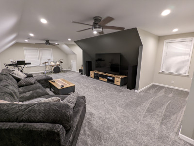

So first the space in question. The subs will go behind the TV and you can barely see the edge of a T39. For reference, the TV is 85".

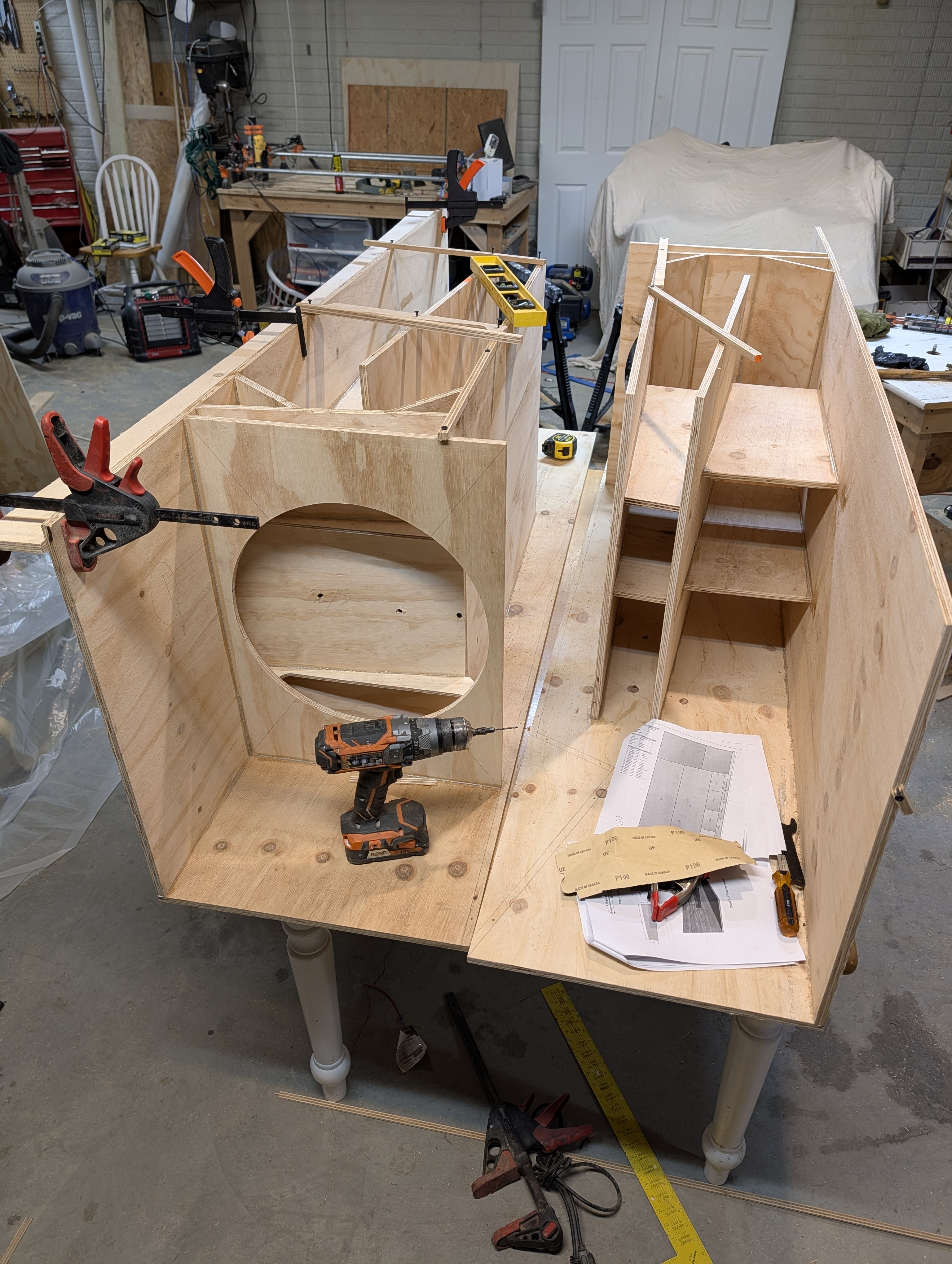

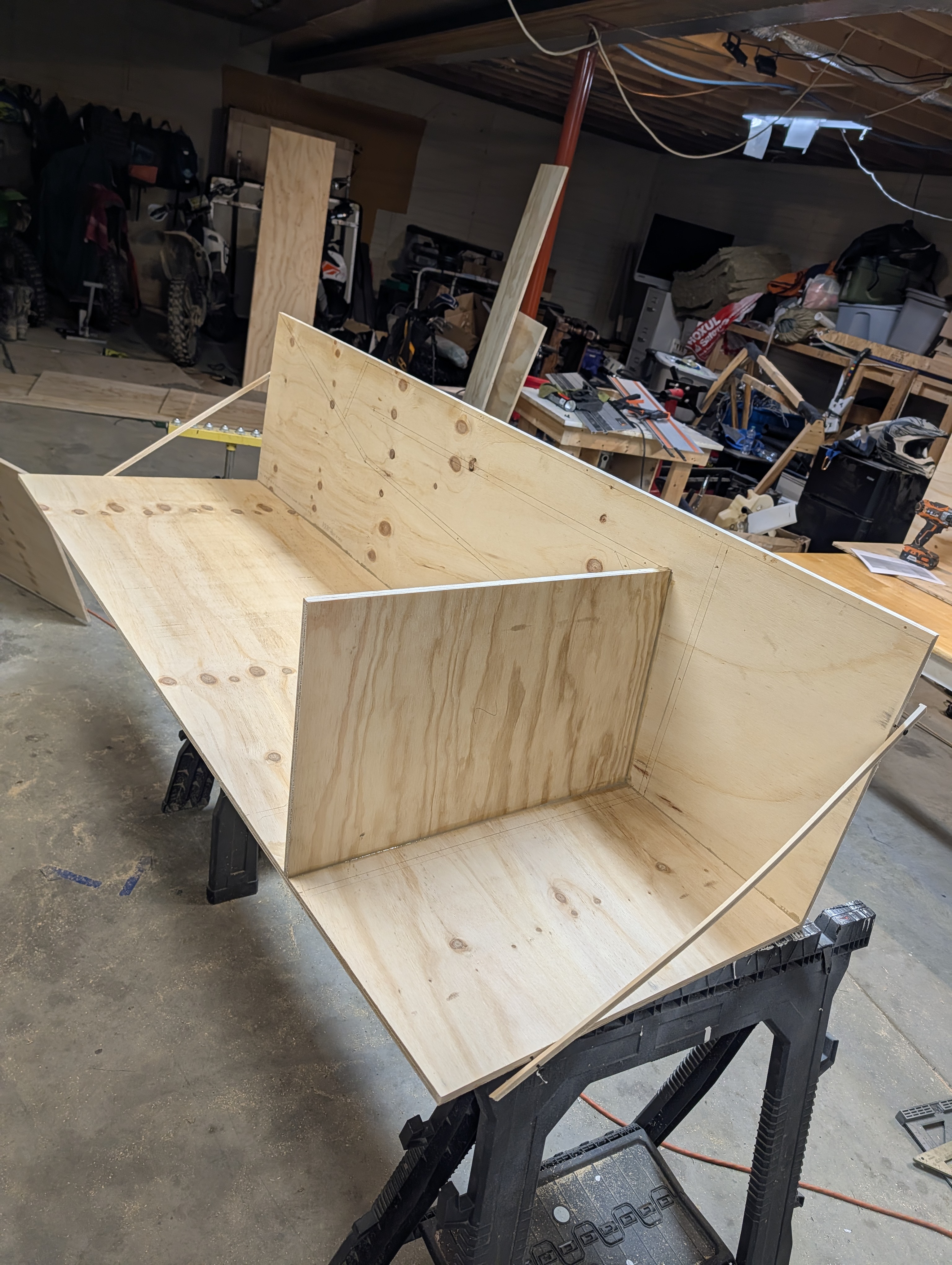

Getting started on first cab:

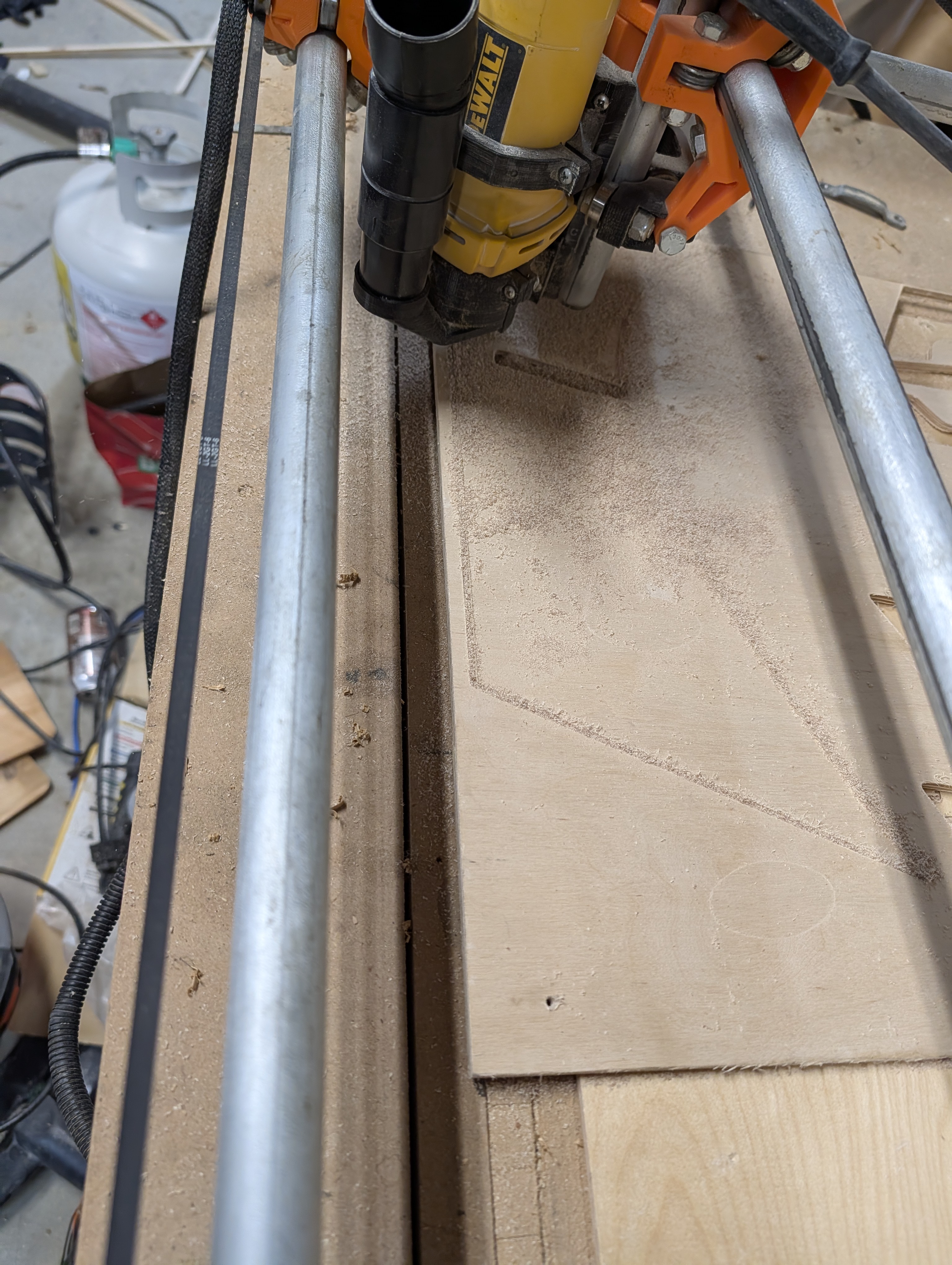

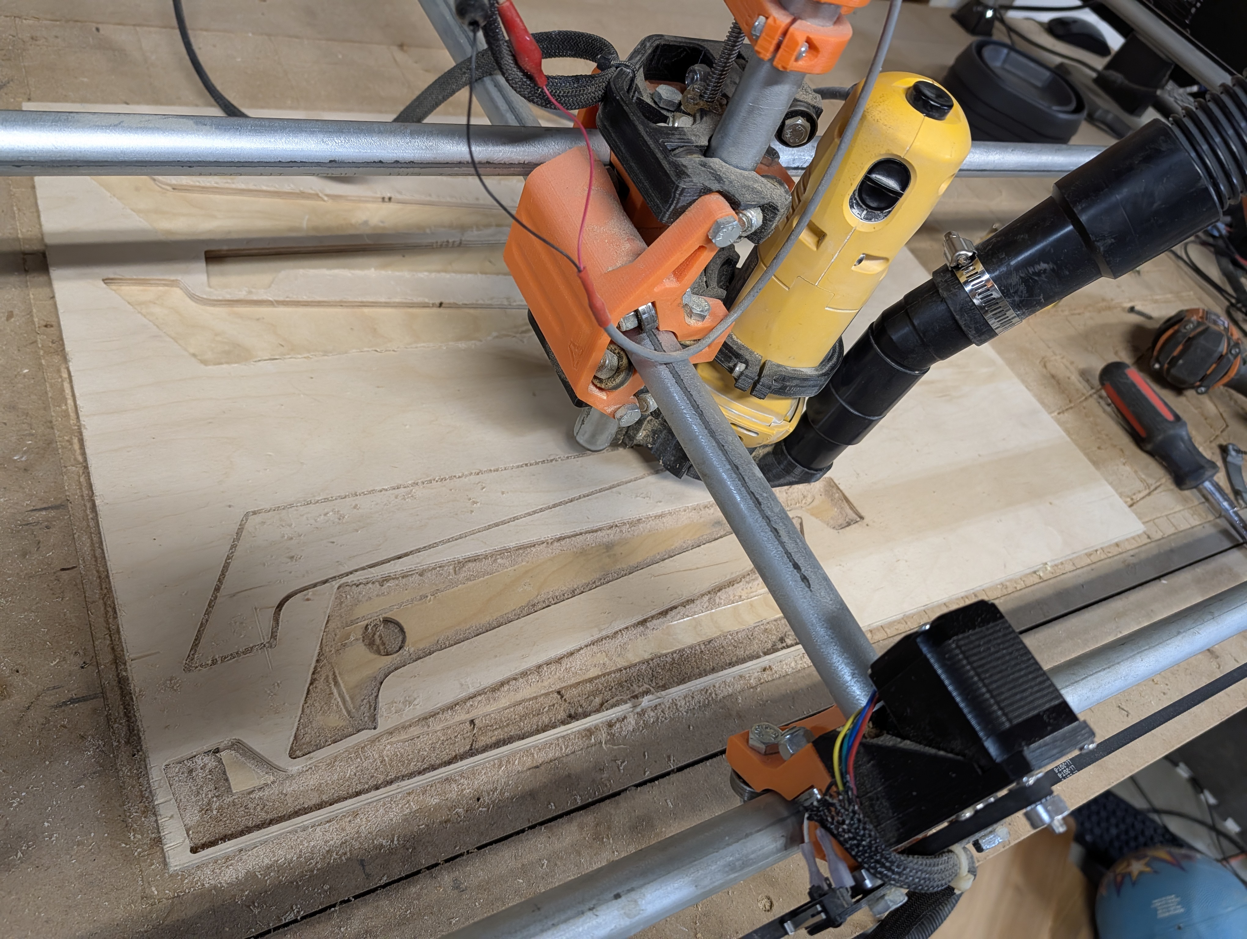

Using my MPCNC for the 2/6 braces. You can see failed attempt #1 in the top of the frame:
Making some good progress:

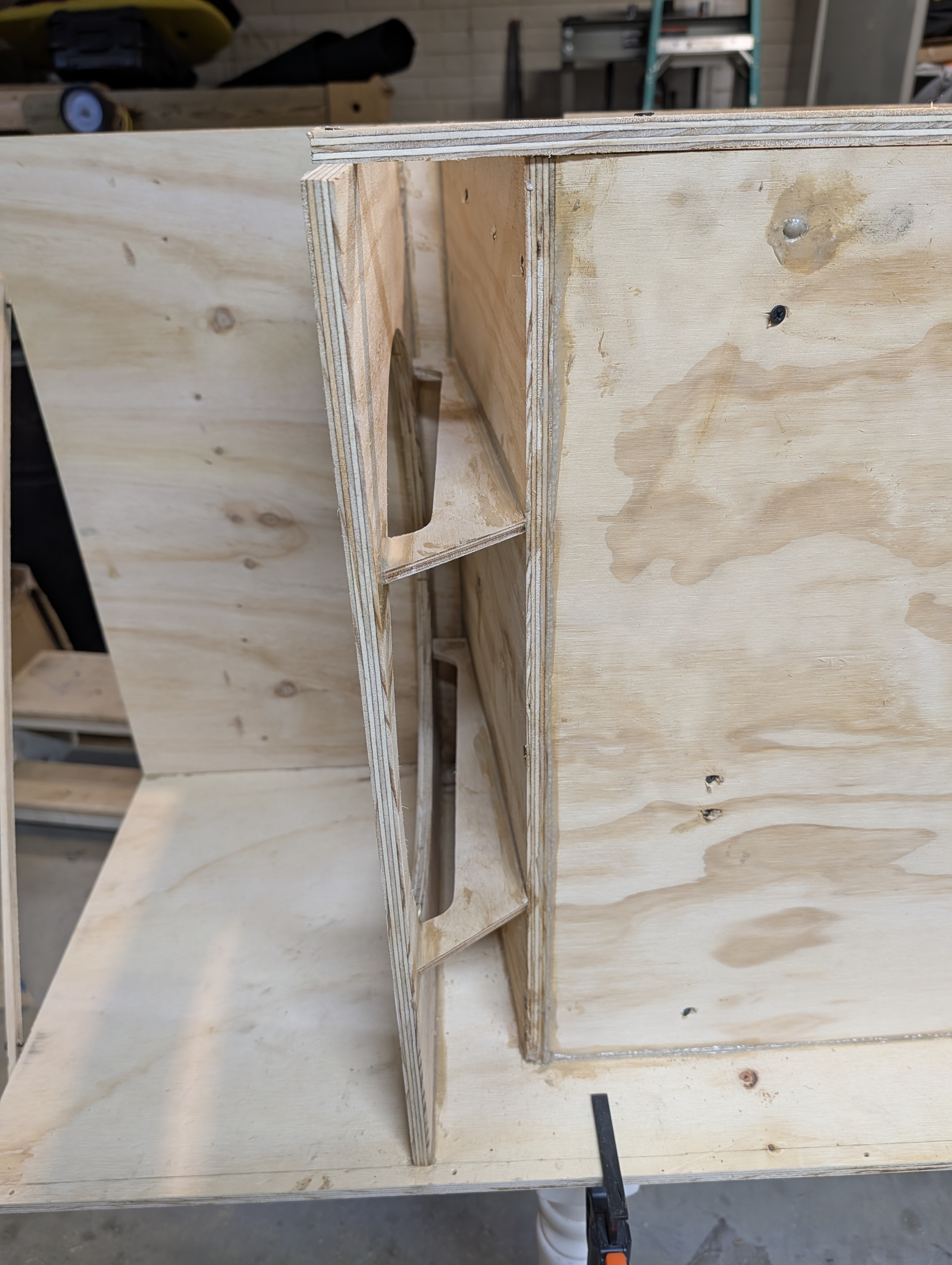

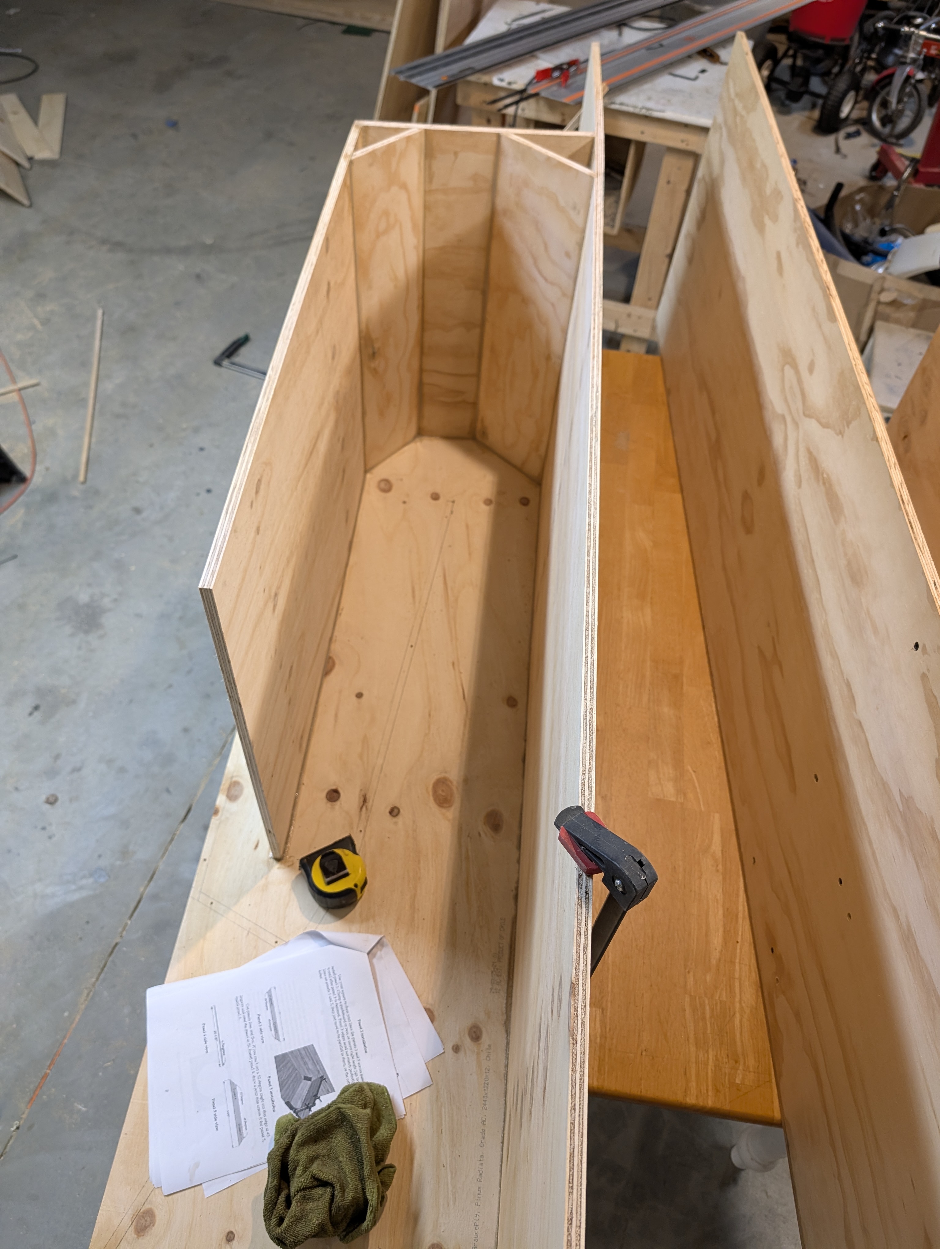

I got panel 9 and the 4/9 braces installed on both cabs last night. I forgot how time consuming the braces can be!

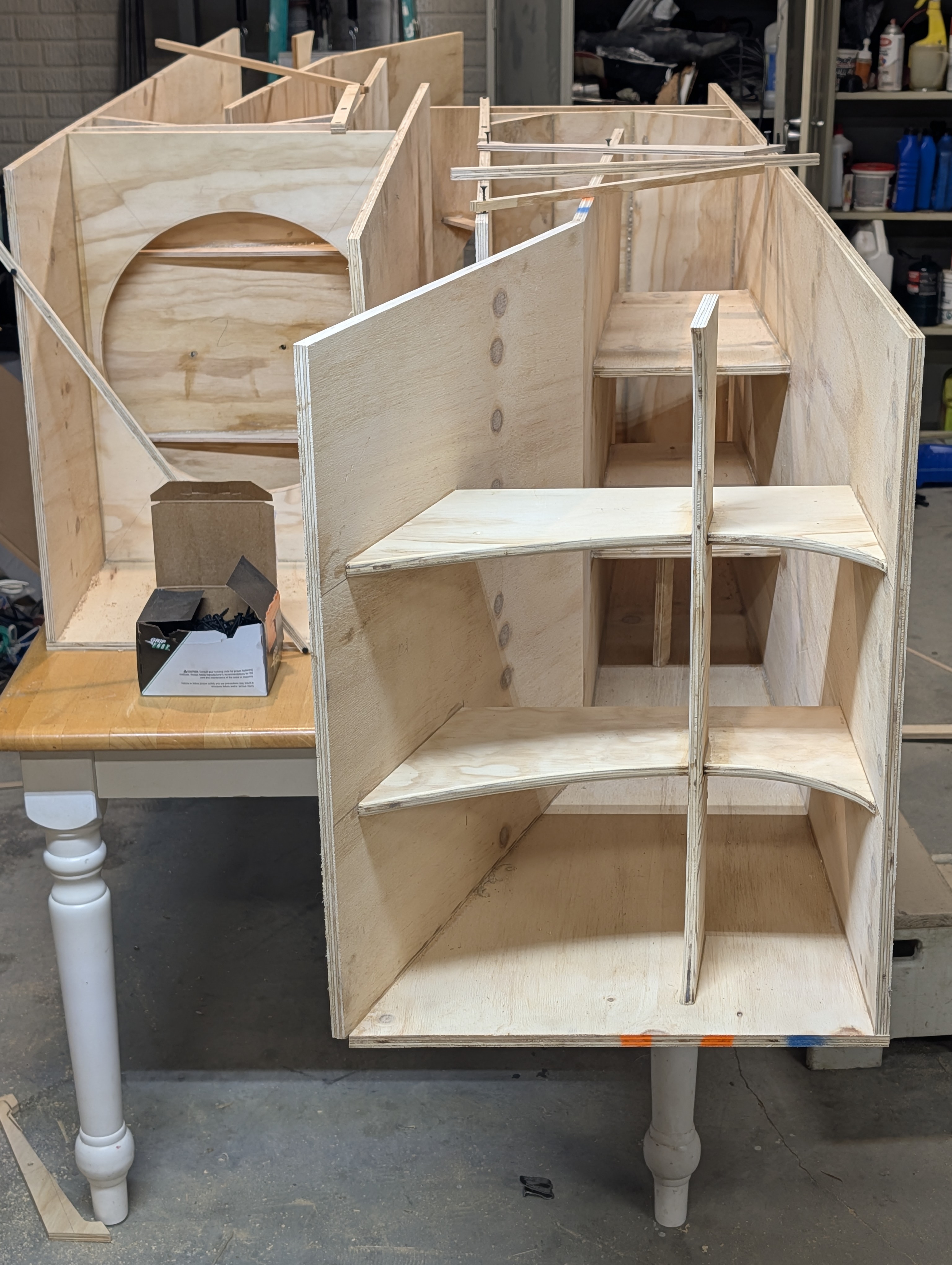

I got a fair amount of work done this weekend. Panel 10 in both cabs and all braces installed. Whew!
A little spray paint in case anyone ever looks under her dress :lol: I'll duratex everything else I can reach with a roller.
Side covers attached!
I've got one driver in, but haven't got the cover flanges, cover, or chamber braces made yet. I'll probably work on that tonight if I get a chance.

Joman116 wrote: Mon Mar 09, 2026 4:00 pm Looks great. What method are you using to get the "width" panels perpendicular to the side panels? I created right angle jigs with two sheets of plywood, but they are no perfectly 90 degrees.
Also, let me know if you ever plan to sell the lab12 drivers...I need another one for the second Tuba60 I will build later this year..
Thanks for the compliments. I cut as much as I can on the table saw with known square edges against the fence. I also used a homemade crosscut sled for some of the cuts. On the large panels that are too big for the table saw, I use a cheap track saw that I got off Amazon years ago.
I use a lot of plywood scraps to keep the panels perpendicular once they're in place. I'll measure the distance between the panels at the bottom (the side panel where all the layout lines are drawn) and use a plywood scrap at the top making sure the measurements stay the same between the top and bottom of the panel. Also be careful when installing braces because it's easy to make the panels get wonky if you wedge them in too far or not enough.
You can see my plywood scraps here keeping panels square:
