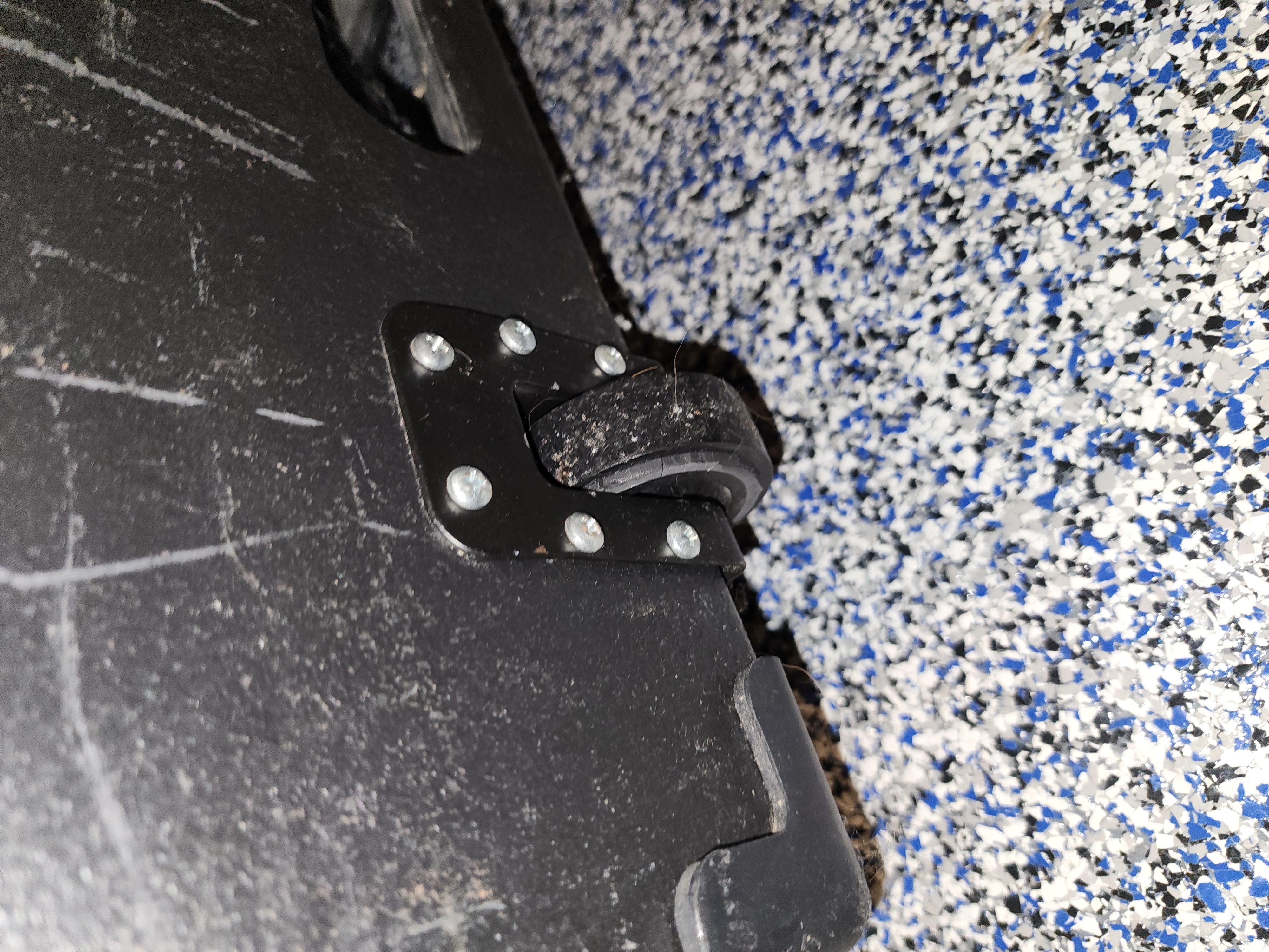

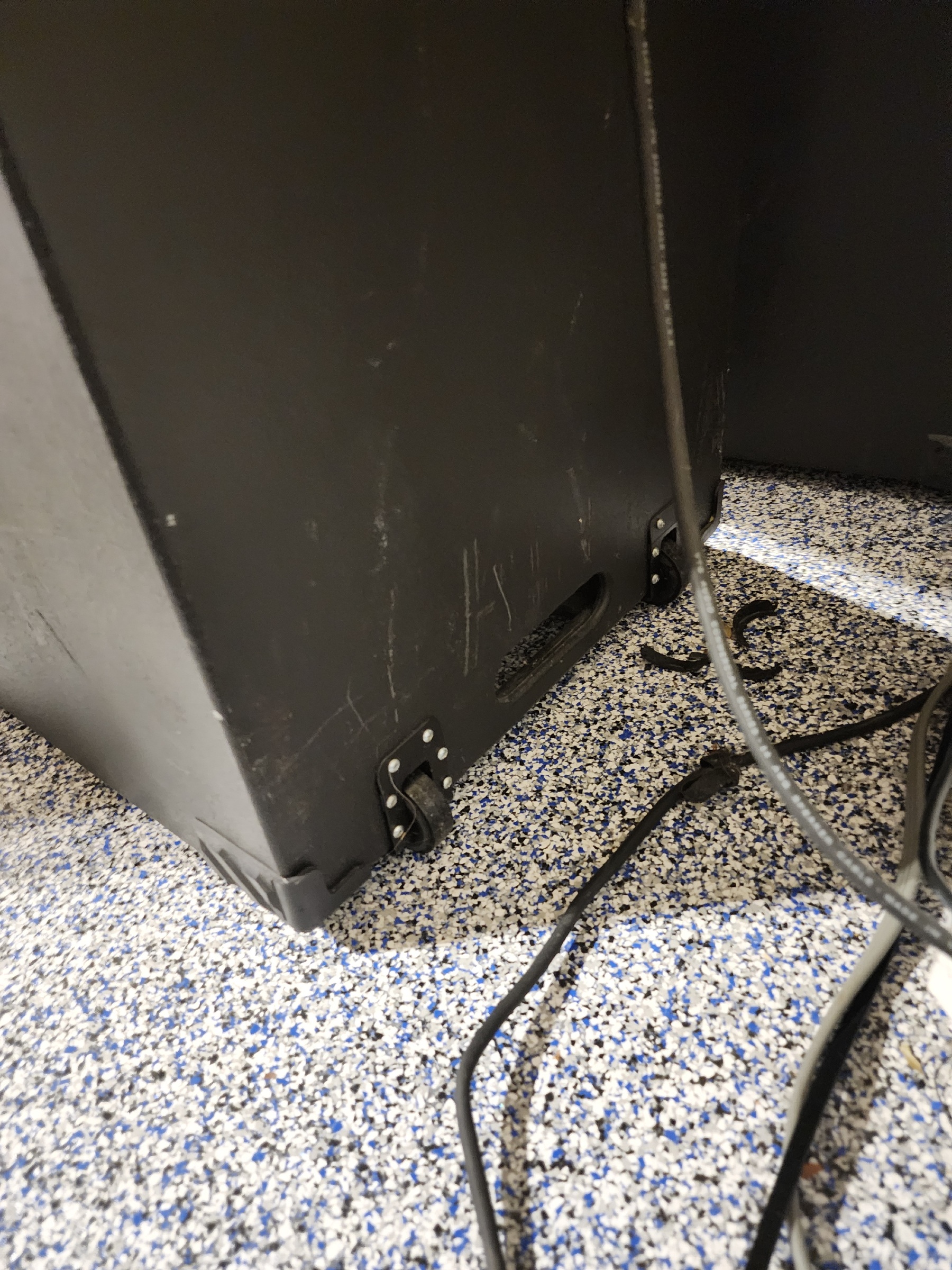

Hi team,
I have a pair of 20" T39s I bought used and the casters need replacement. See images, can you guys help guide me on a more robust Caster model /install guidance?

Anyone? I believe these are called "tilt/recessed" casters?

Bill Fitzmaurice wrote: Tue Dec 02, 2025 5:50 pm Check Penn Elcom.
Looks like the part I currently have on there is W2060K. Any other alternative that's a worthy upgrade?
Would the 3" offset the sitting alignment?

Just look around here and pick a beefier model. Replace both for future proofing and symmetry in rolling.
https://www.penn-elcom.com/us/flight-ca ... ge-castors
*I* like the looks of this one (tougher design, larger diameter rolls smoother over bumps etc), though the inner wheel housing width might require you to open up the currently vacant space a bit. You'll also have to make sure to keep the horn path integrity intact and not let any air move through whatever modification you may have to do.
