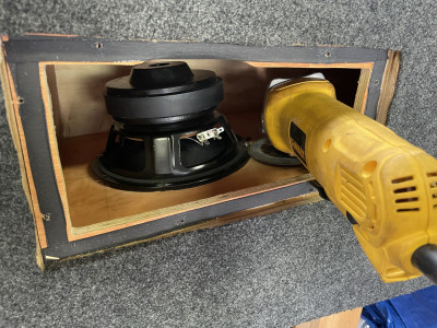

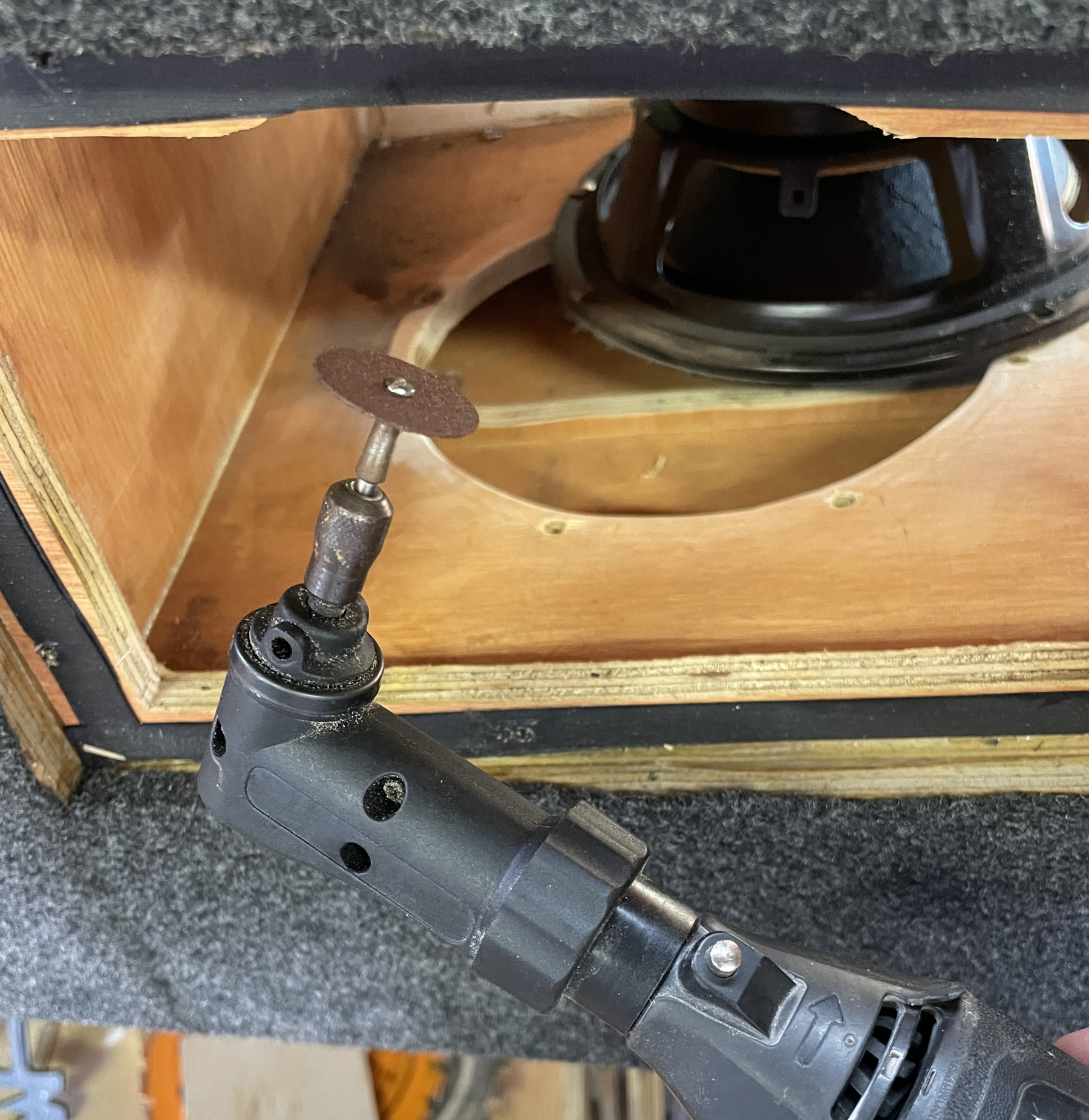

J_Dunavin
Posts: 1279
Location: Appleton WI
Re: auto tuba plans?
#5 Post by J_Dunavin »
Why oh why did I use Loctite on these 8/32 screws :slap:
All but three of them came out ok, had to get a little creative in getting the other ones out :chainsaw:
I just ended up using some much wider 10/32 t nuts and screws that I already had. Wood screws may have been better, but i only have one door on this guy and the t nuts are handy when your reaching around ... trying to blindly find the hole.
Thank you Seth, got the replacement MCM in there and we are back in business!
