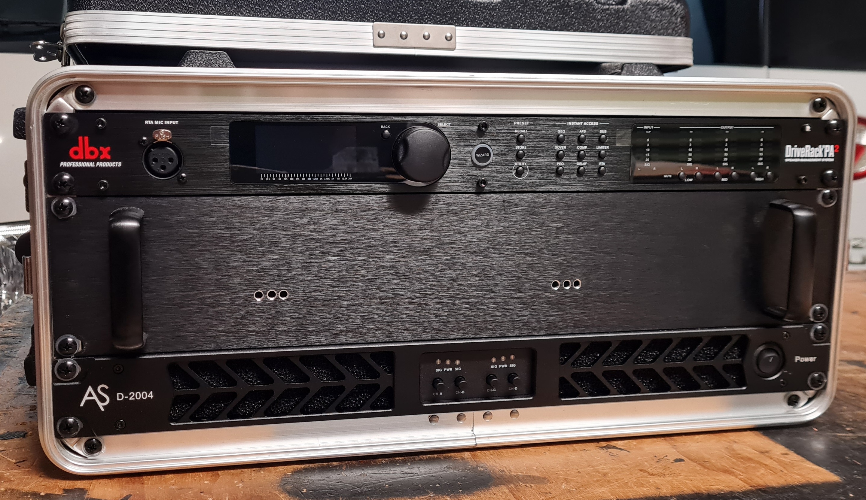

A CVR2004 for subs & mids, and a 2x800w amp l built with Wondom modules & a 60v DC power source for HF.

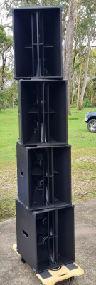

Is there any sense in spiralling the array for the nutters who want the be right up close to the stage, this for example, would be the LH side

Yes, you can spiral the array. For the best result the mouths of the HF horns should be in a vertical line. That will minimize any comb filtering of the highs. The mouths of the low frequency sections need not be on a vertical line as the wavelengths they pass are too long to require it.

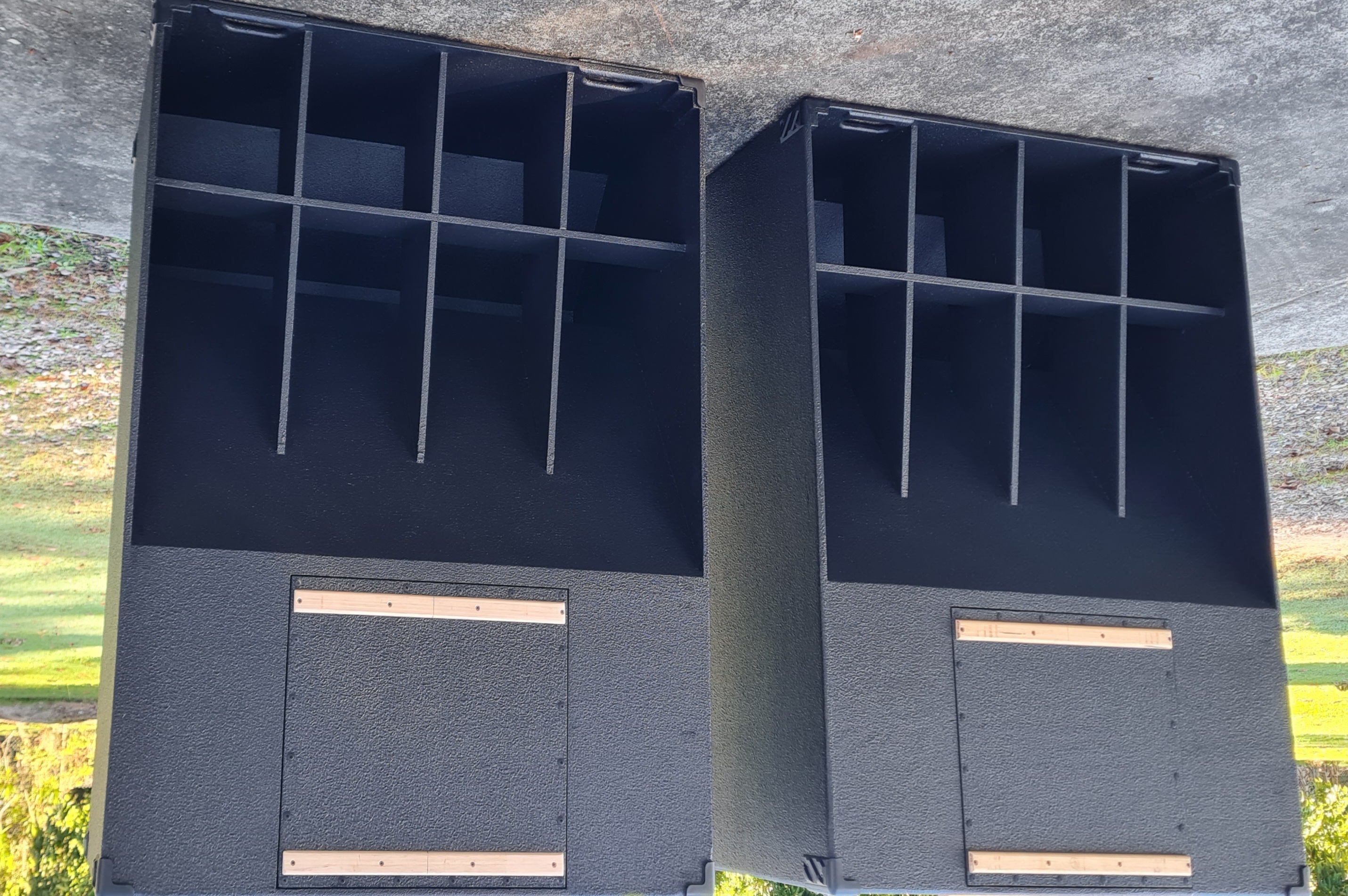

Seth wrote: Wed May 28, 2025 1:10 am You could aim them at the sky, at the ground, toward the audience, away from the audience... won't matter much at all outdoors.
If the T48s were to be setup outdoors in a line with the horn mouths towards the top..
There'd be no noticeable difference? This wouldn't look as appealing, but is easier setup as they'll be trucked out of the trailer upside down
Posts: 29105
Re: OTop8 dispersion angle and Bi-amping
#66 Post by Bill Fitzmaurice »
No measurable difference either, so long as the bottom of the cab is less than 1/4 wavelength from the ground. At 100Hz that's 85 Cm.

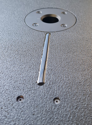

Bill Fitzmaurice wrote: Thu Jan 23, 2025 4:22 pm Black hot melt glue.
I finally got around to doing this, and it turned out much better than l thought! Great tip there, cheers Bill :)
