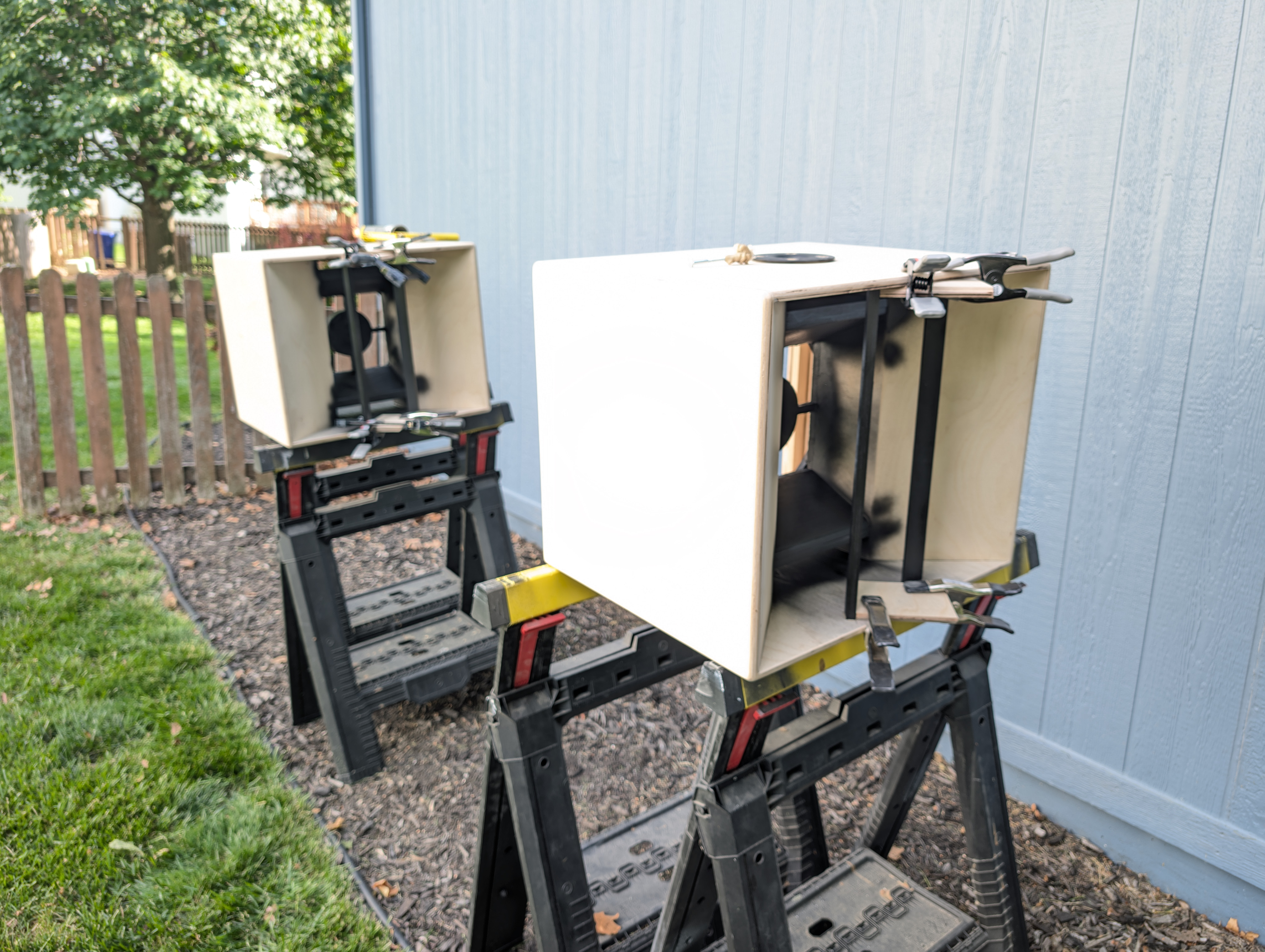

Thank you all! I have been sick this weekend, but had a bit of energy today so I got some sanding done. Nothing to take pitchers of. Next step is to get paint in the ports and such before attaching the melded array mounts. Should hopefully get that done tomorrow, then to continue painting the rest of the boxes in advance of the Duratex.

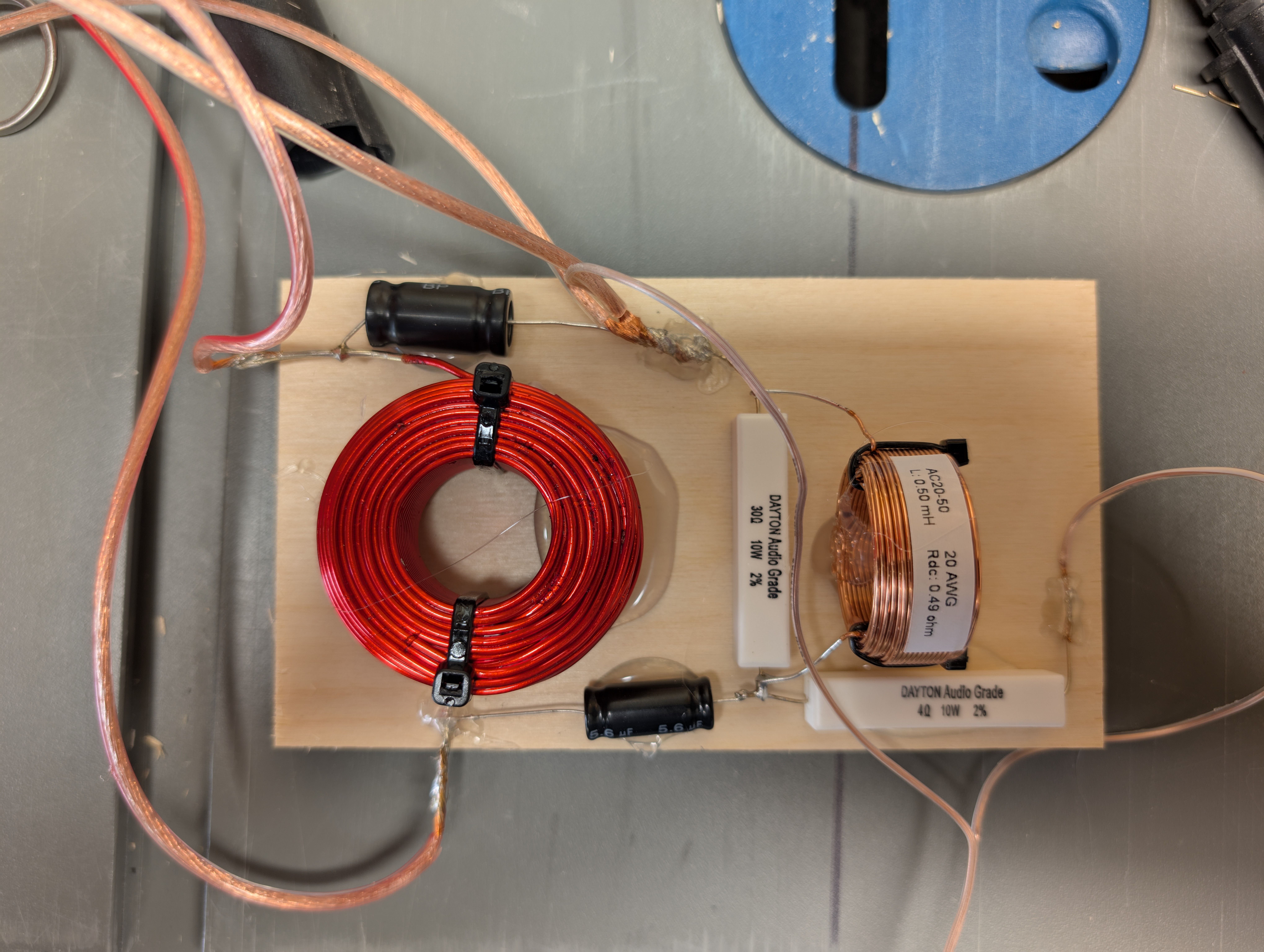

Thanks Seth! Many of those solder joints are ugly, mostly because my soldering iron tip was disintegrating as I was going. Portasol quality has dropped.
Got the crossovers built. They ain't pretty, but they'll never be seen.

Melded array mounts installed and initial bit of paint

The end is nigh!
One more coat of Duratex and then I can assemble everything. I got the crossovers tested and mounted to the rear panels (you can see them on the floor).
