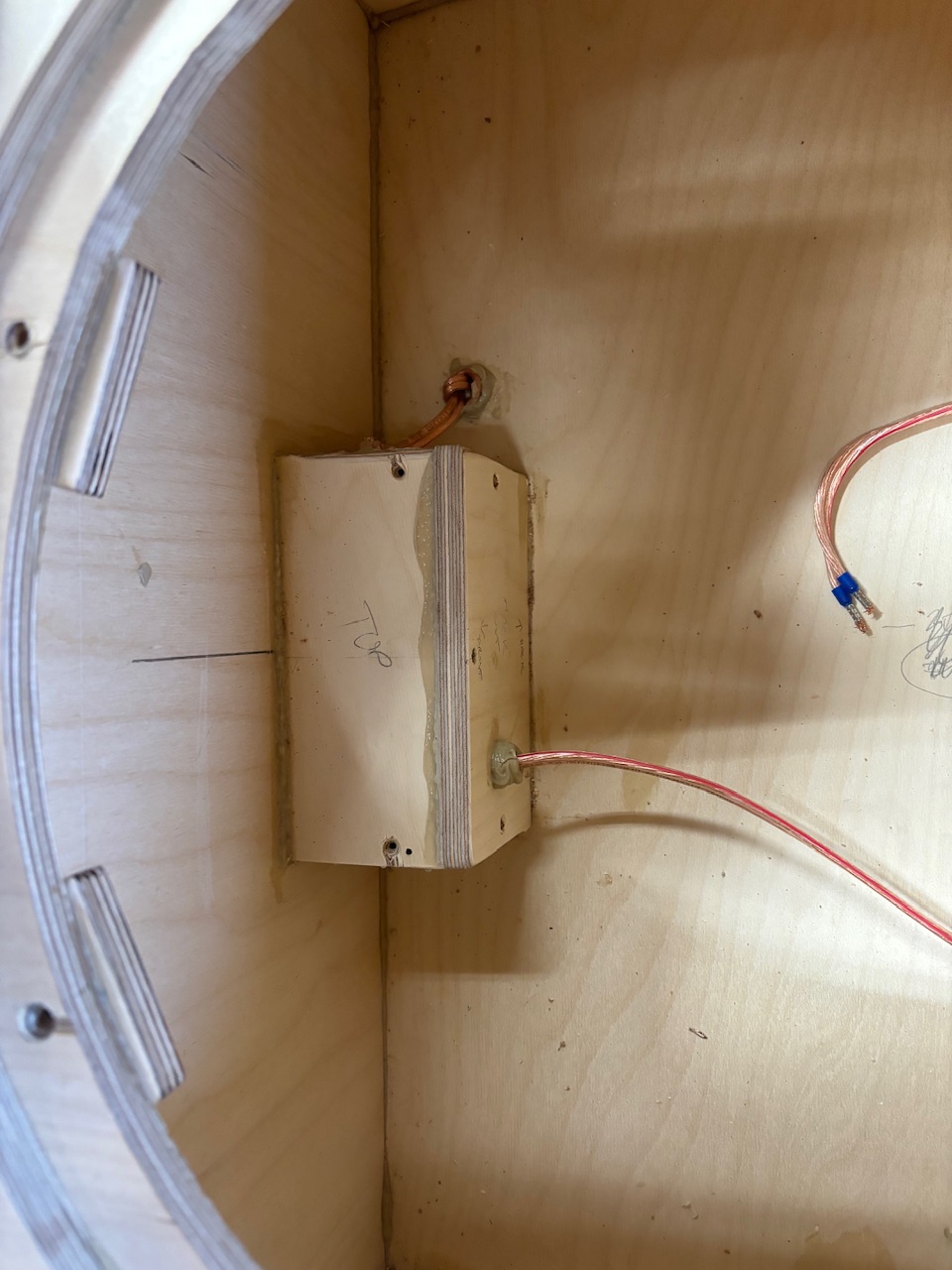

Re: 4x T48 and 4x OT12 build
Finally got around to doing this. Worked out great. Thanks again for that suggestion Kevin!Strange Kevin wrote: ↑Tue Aug 27, 2024 2:57 am If your jacks are far enough from the driver, there may be room to build a small dog house behind the jacks to seal them from the main chamber.

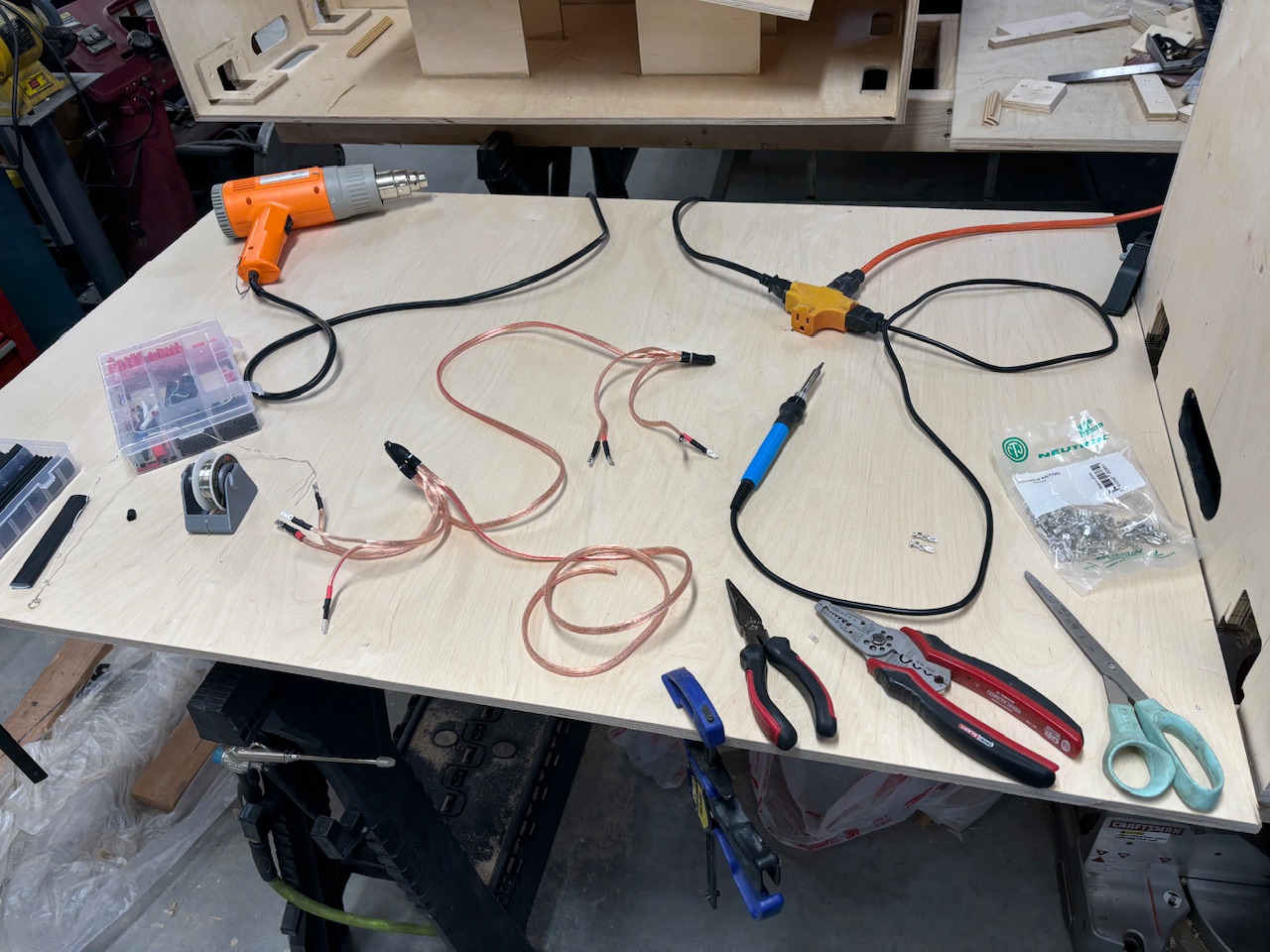

After soldering the wiring harness in the first two cabs with it glued in the cab I had the realization I could make it up and glue it in after testing it. So much easier!
I think by the time I’m done with all 4 of these subs I’ll have a decent idea how to do it!
I'm looking at the preassembled wiring pic and trying to make sense of it. My only intention is to help you avoid mistakes. So, if you're certain it's all good, don't sweat the question. But, if you're not 100% certain or are otherwise willing to humor my curiosity, would you mind walking me through it?
I see four female spade connectors on the left and four on the right, one duplex wire connecting them, and one duplex lead coming off the left set. What it looks like is wiring for two 4 conductor SpeakOn's, yet only one of two pair passed between the two connectors, and a speaker lead off the left set. Am I seeing that right? Maybe it just hasn't been completed when the photo was taken?
Dunno. Just trying to save you headaches down the road. To my eye, it looks like you'll want another duplex, for a total of four conductors between the two SpeakOn's.
Otherwise, it's all looking amazing. I like those doghouses.
Seth your right. Though I’m using NL4 connectors I chose not to wire these for the second (2+/-) terminals. All my speaker cables are two conductor (1+/-) and I don’t plan to change them out for 4 conductor cables. My amp rack is wired similarly. It was a compromise from how most might wire them I know but a conscious decision. If for some reason I find a need to go with 4 conductor cable from the amp I’ll just make a break out box to split them at the speakers.
Ohhh, I see what's going on now. Gotcha. Understood. Carry on my good man.dlv wrote: ↑Sat Oct 12, 2024 3:01 pm Seth your right. Though I’m using NL4 connectors I chose not to wire these for the second (2+/-) terminals. All my speaker cables are two conductor (1+/-) and I don’t plan to change them out for 4 conductor cables. My amp rack is wired similarly. It was a compromise from how most might wire them I know but a conscious decision. If for some reason I find a need to go with 4 conductor cable from the amp I’ll just make a break out box to split them at the speakers.

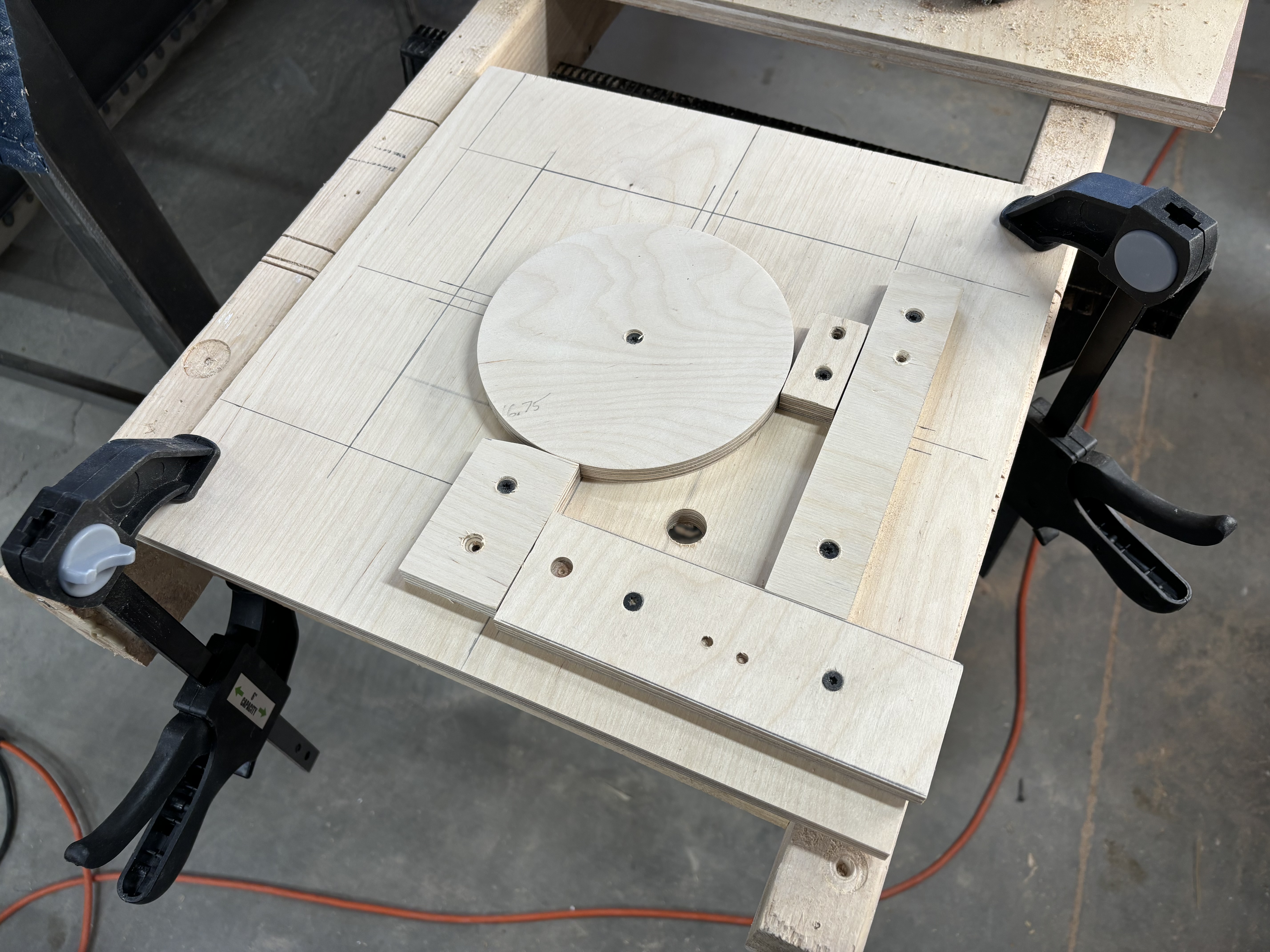

Finally! First cuts on the OT-12s! Have one final side to put on the last T48 and then some sanding and finishing before painting. Also still need to make the grills.
But I need some tops to test these things out with!!! lol
Very first thing is make some circle templates and a template for the baffle.
Using a 6" circle template and some scrap to jig out the baffle template:
The finished baffle template:
And a nice clean baffle cut from it! The rest will be a piece of cake. Templates make this so much fun I might cut parts for 6 tops even tho I planned for 4.
One question about these baffles. Is there any need to square out the corners where the router bit leaves a 1/4" radius? I can't imagine it would affect the sound in any way. I like the look of the radius (though it'll be hidden eventually) so I'd rather leave it.
I find creating jigs with that method to be one of the most satisfying parts of a build. To take a bunch of garbage cutoff's and turn out a part that looks like it just came off the CNC table, such a sweet feeling. Especially once all the parts are made and look identical and perfect too. I love it!
Well done! Looks perfect!
