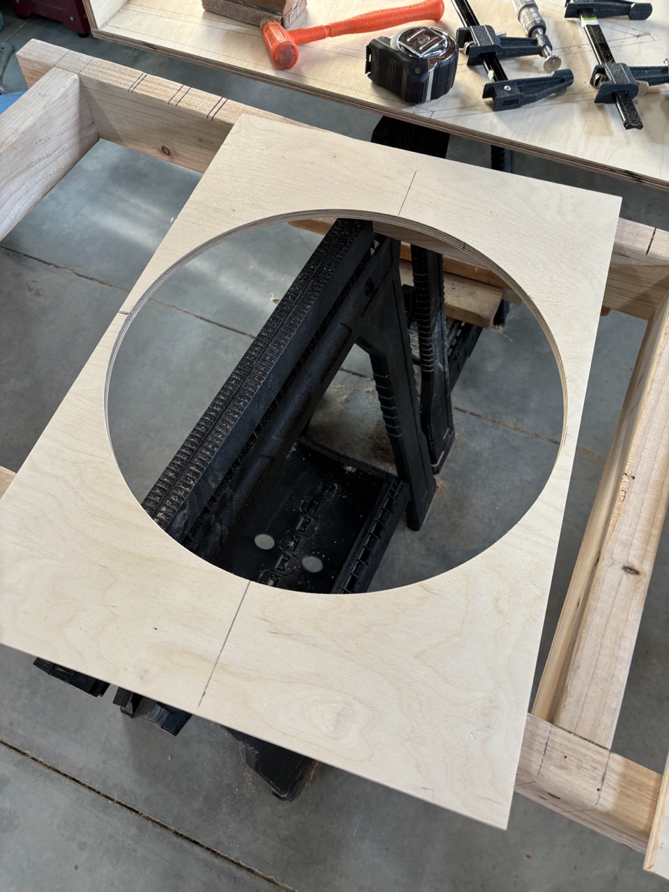

Have a question for Bill (or anyone) on the driver anchor for panel #2, the baffle.
Is there any reason the corners need to be cut on the 45's on the driver anchor? I'm looking at the plan and sketch up and seems like the corners could be left. That would give a lot more surface of the anchor glued to the baffle and seems like that would stiffen it some more.
Thought I'd ask before I glue the anchor.
Thanks!

Posts: 29007
Re: 4x T48 and 4x OT12 build
Weight. Leaving it square wouldn't make it any stronger, just heavier. Sure, it's only a few ounces, but a few ounces here and a few more there and it all adds up to pounds.

Ok. Got it. I'll carry on with gluing it then! Appreciate the guidance.

Well figured I'd post some kind of update. It's been slow. Definitely a good thing I'm building one cabinet first to work out the nitty gritty details. The plans are great, but there's still a lot of figuring out just how best to go about it with the tools you've got. I'm also obsessive about square and fit. So I do a lot of dry fitting to see what clamp & brace setup is going to work as well as checking alignment & fit.
Didn't help I made a mistake with the baffle cutout. I wasn't careful and cut the baffle hole 14" (the anchor hole size). So did some head scratching how to fix that, cut a new panel? I already had the angles cut perfect so to salvage it I got the bright idea to cut the baffle panel for the 2nd cab, cut it's hole correctly and then align it on the first baffle panel and use it as a template with a template router bit to re-cut the first panel's hole to size. That worked so well that I also cut the 2nd cab anchor panel and it's hole so I've got both to use for templates on cab #3 and #4 as well. Honestly I can't say enough about templates and template router bits. IMO even for 4 cabs it's worth taking a moment to cut a template for things like these holes, handles, etc. I got a new template router bit, my old one was dull. Now it cuts like butter and leaves a nice sharp edge.
Had a lot of fun getting the anchor hole lined up with the baffle cutout. I cut to just fit the driver so it was super tight. Even using the driver to align it took quite a few retries yesterday to get it just right so there's a bunch of screw holes to fill. An extra 1/8" of clearance on the anchor hole wouldn't have hurt at all. Especially since I'm using backers behind it. Good thing nobody will ever see in there!
But first baffle is done and glued in. Panel #3 and #4 are curing. I am assembling on my cutting table so for today that's about all I can do until this sets solid. Hmm a second table for assembly would have been smart. :wall:
