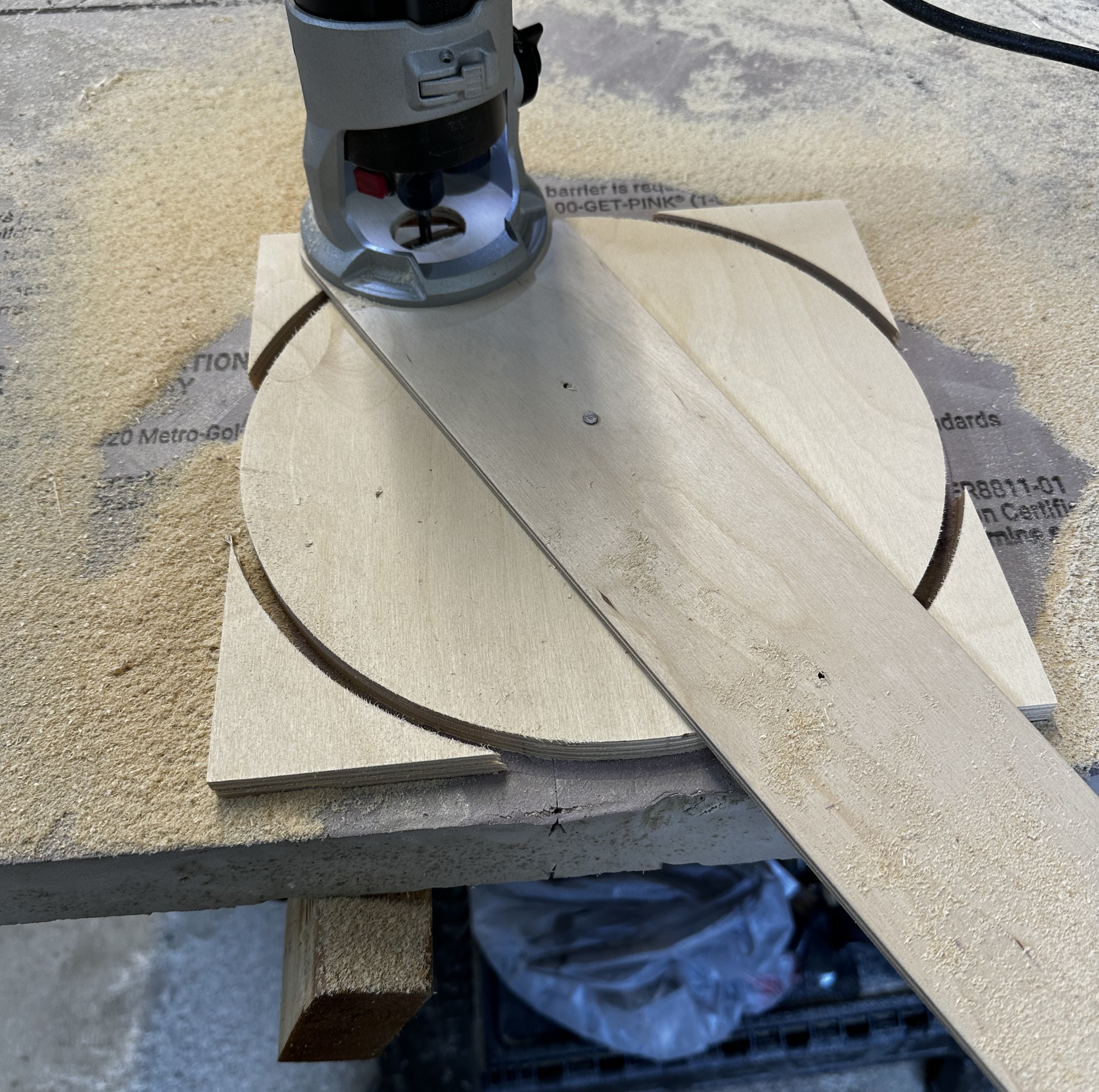

Ok, lets figure out how to make circles with the router since I have it out and then compare.
Oooolaaalaaa. Mikey likes it, he really likes it. It's messy but ooooh so smooth and finished. Drawing the layout per plans.
