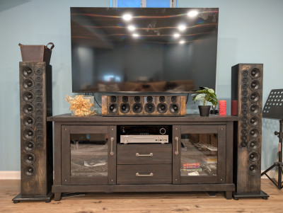

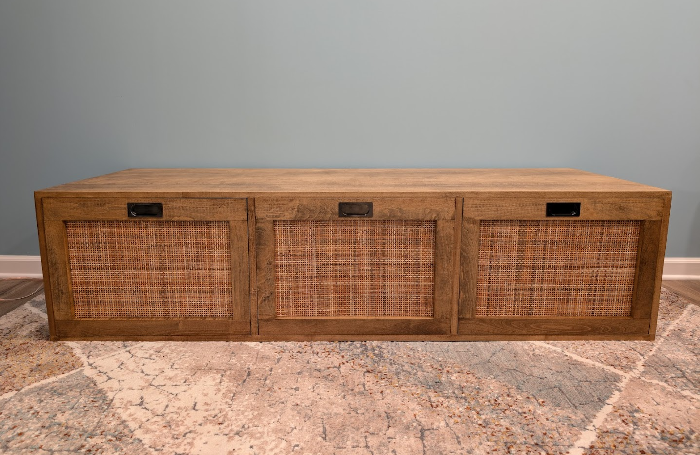

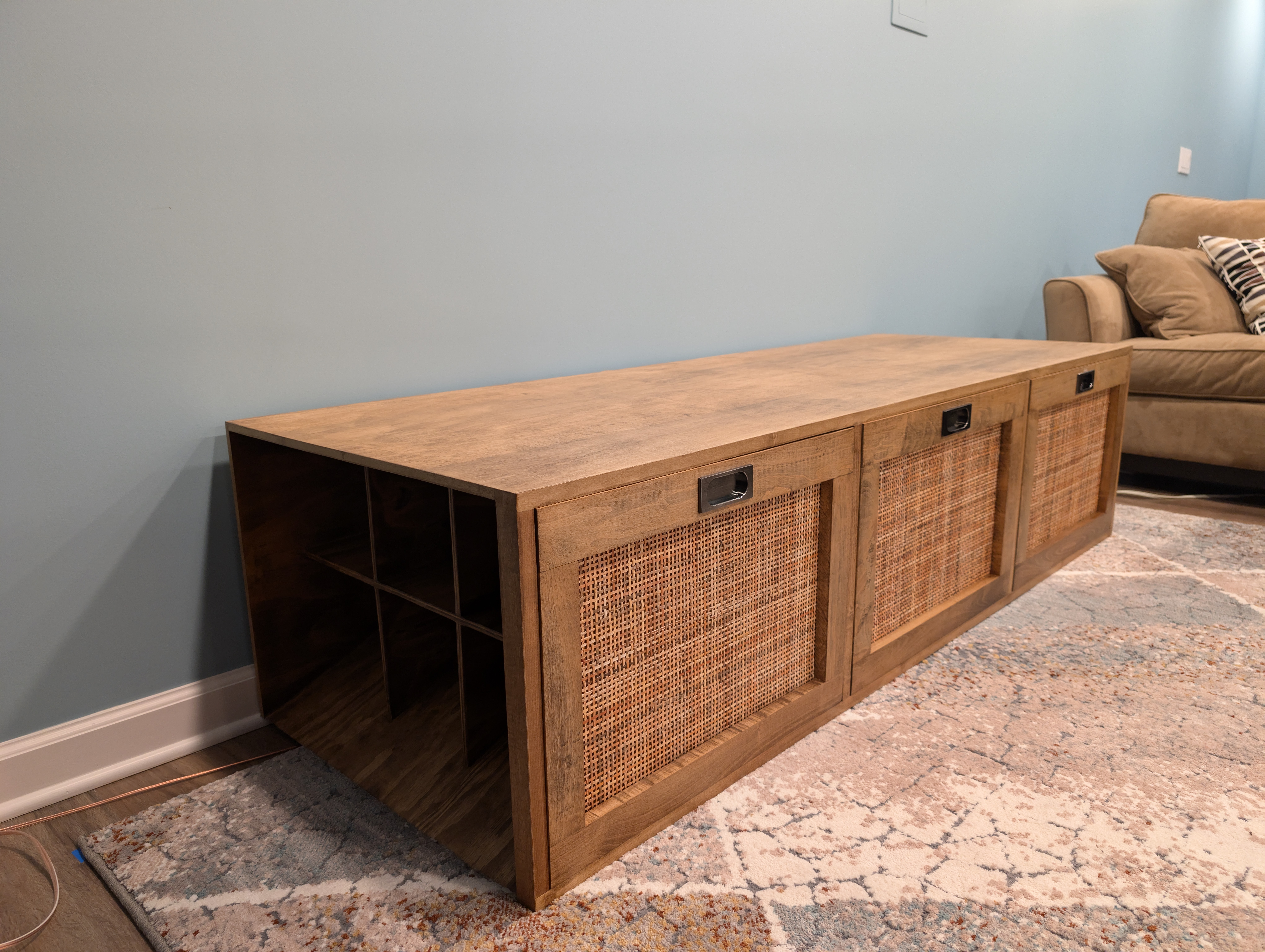

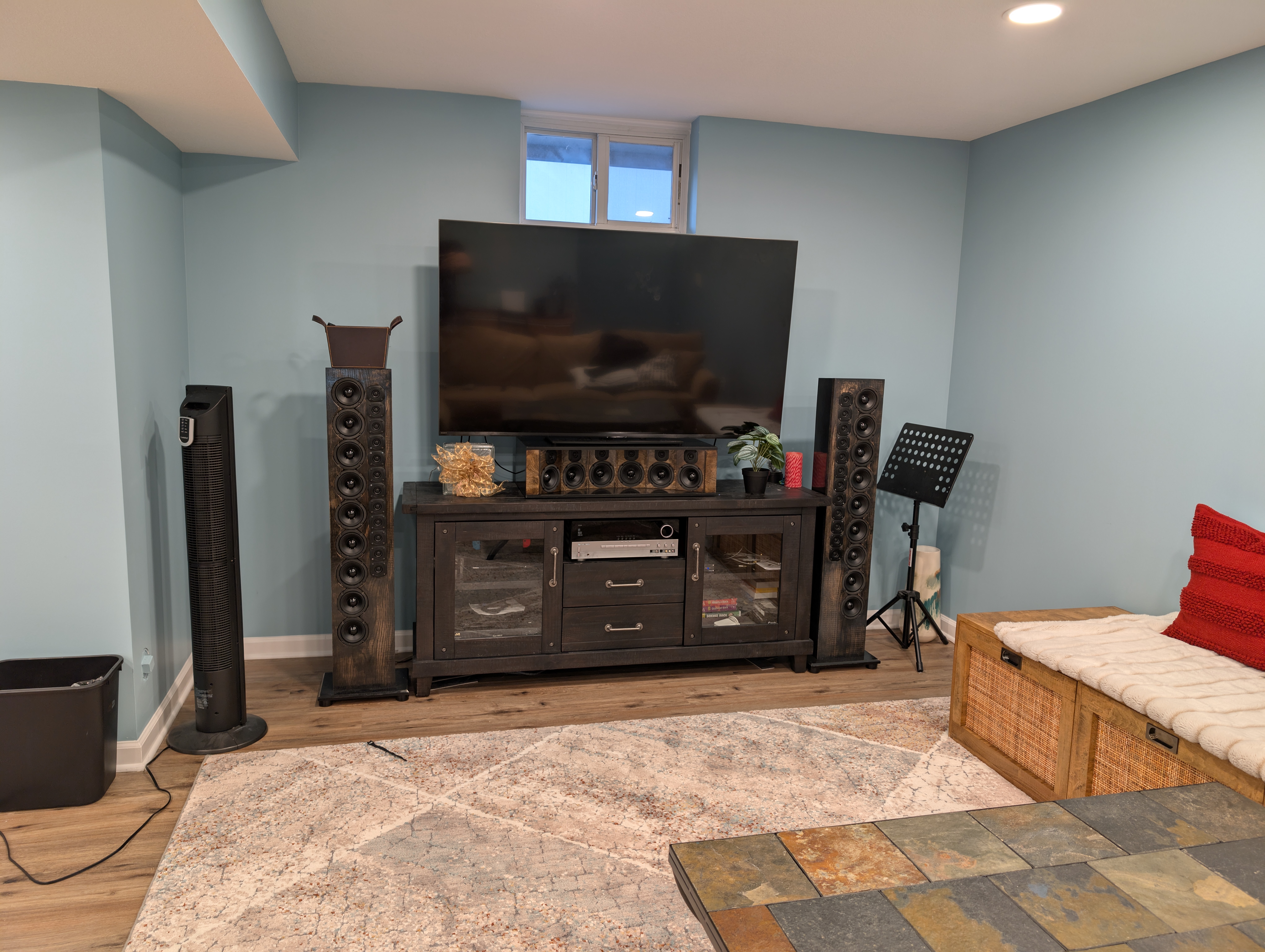

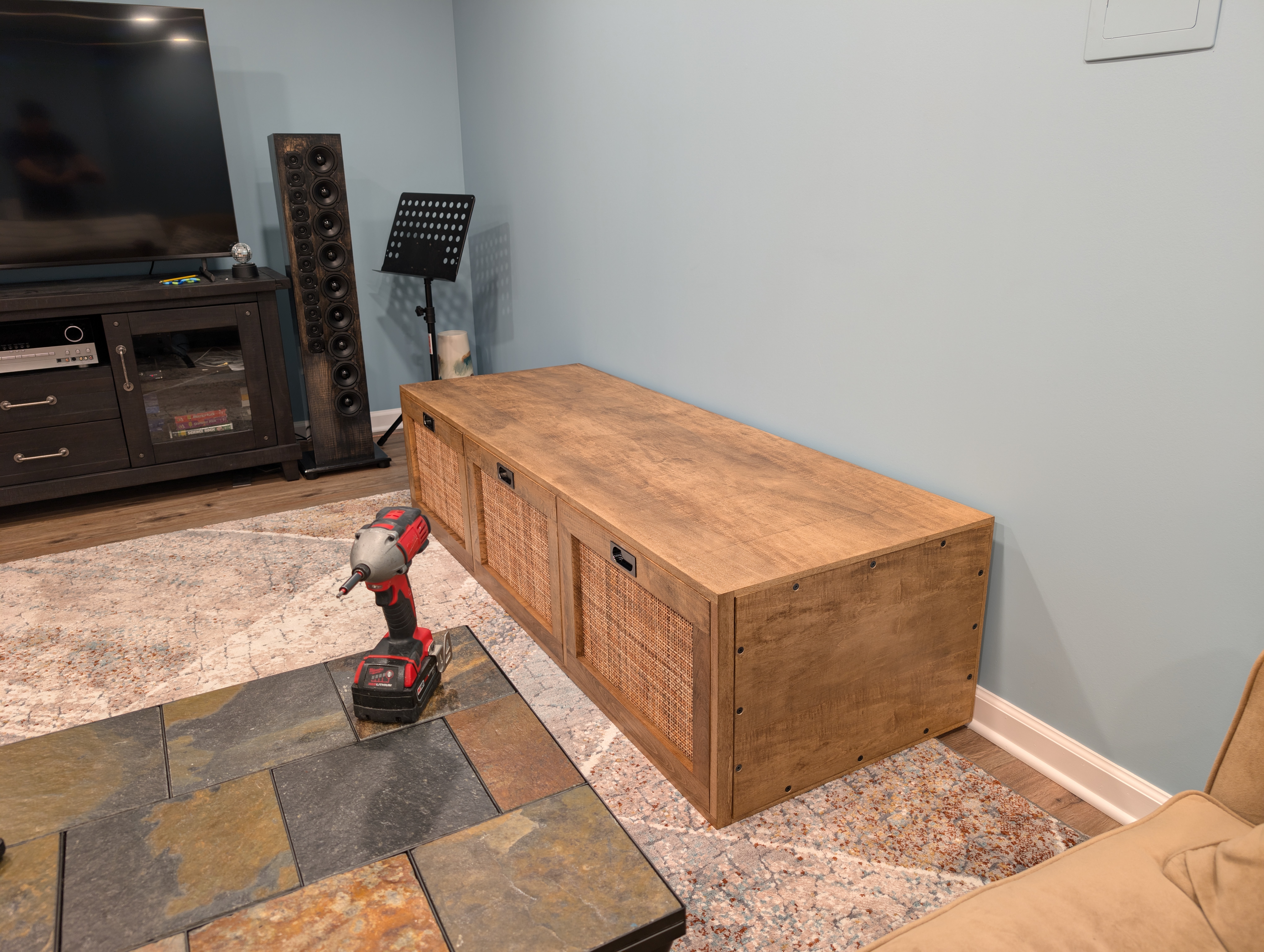

Finally got around to finishing the THTLP "storage bench!"
I do plan to do something about those black screws on the driver chamber cover, but for now they're fine.
Posts: 28967
Re: 24" THTLP with TLAH towers
Nice. But you need to lift the TLAH so that their middles are at or above head level, with the cabs tilting downward, not upward. I'd use French cleats on the walls.

#24 Post by Tom Smit »
That's a beauty looking bench!

#25 Post by shane2943 »
Bill Fitzmaurice wrote: Sun Nov 03, 2024 4:54 pm Nice. But you need to lift the TLAH so that their middles are at or above head level, with the cabs tilting downward, not upward. I'd use French cleats on the walls.
Yeah they are a bit low. I doubt very seriously that the WAF would allow them to be wall-mounted. They do sound great when seated on the couch though.
Tom Smit wrote: Sun Nov 03, 2024 11:12 pm That's a beauty looking bench!
Thank you sir!! Our youngest teen actually tried to open the "drawers" yesterday and was surprised when she couldn't. That's a success to me lol

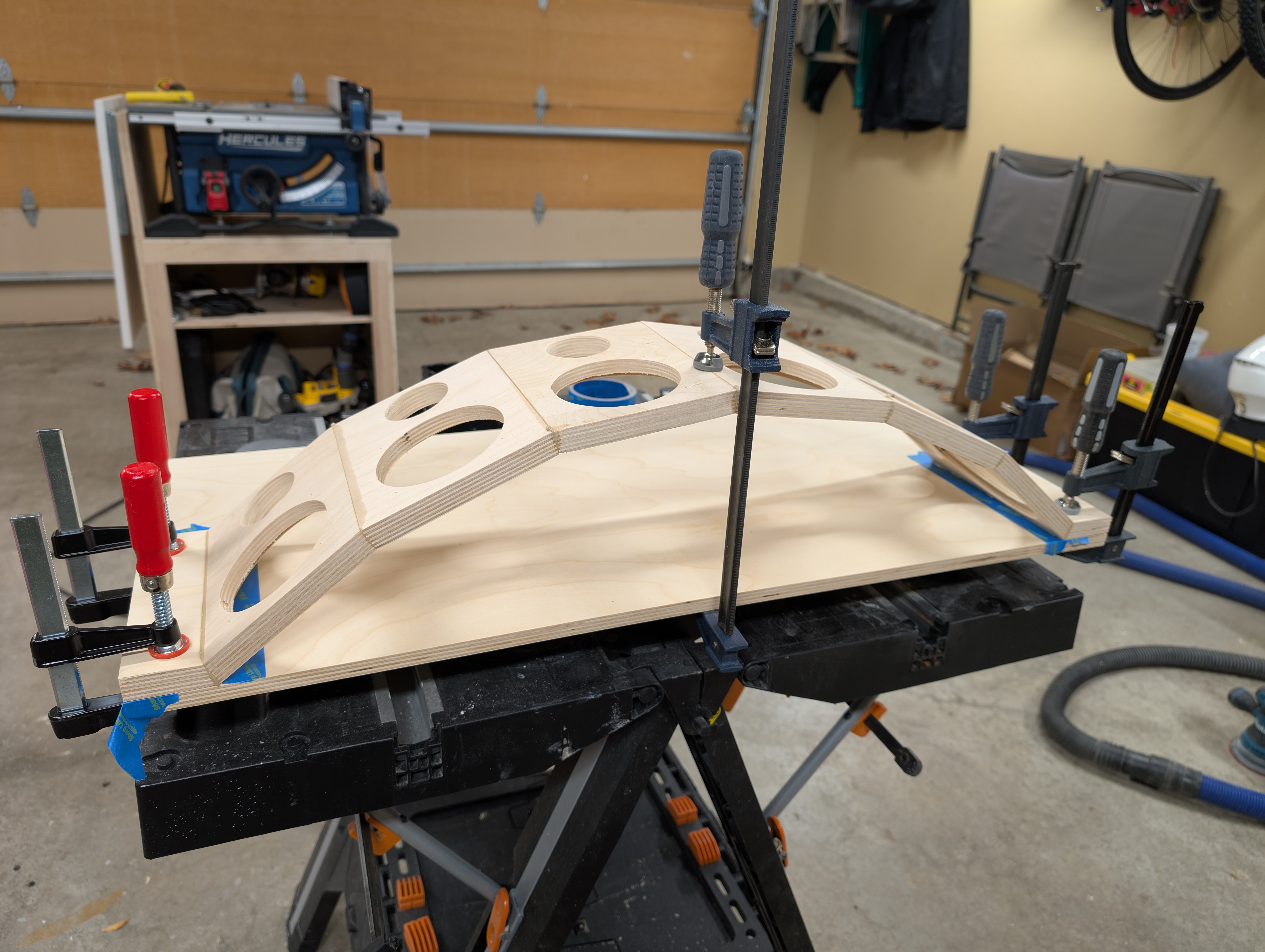

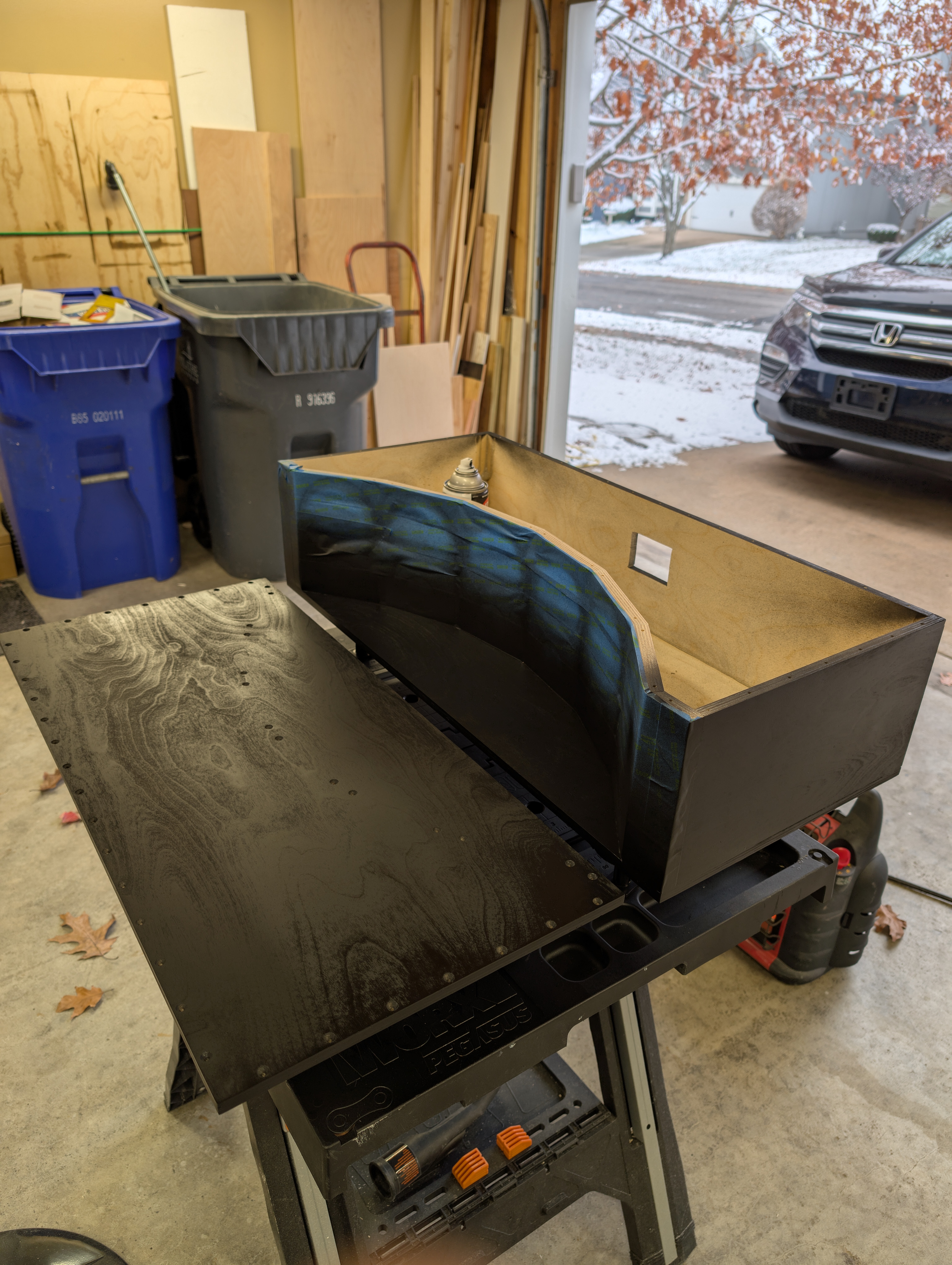

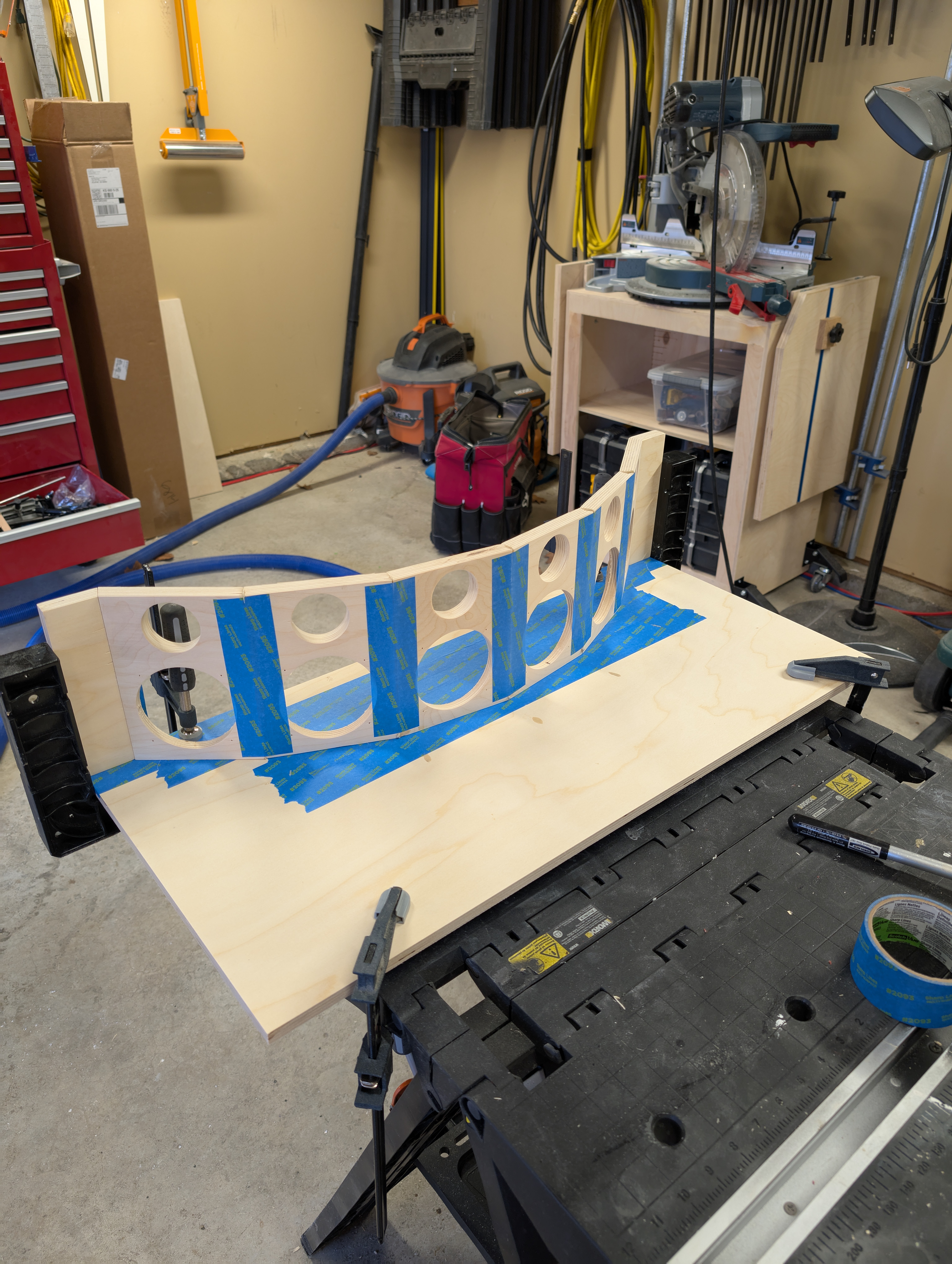

SLA curved center channel in taking shape...
I plan to stain/paint it in the same two-tone black and stain as the towers so they match.
shane2943
Posts: 263

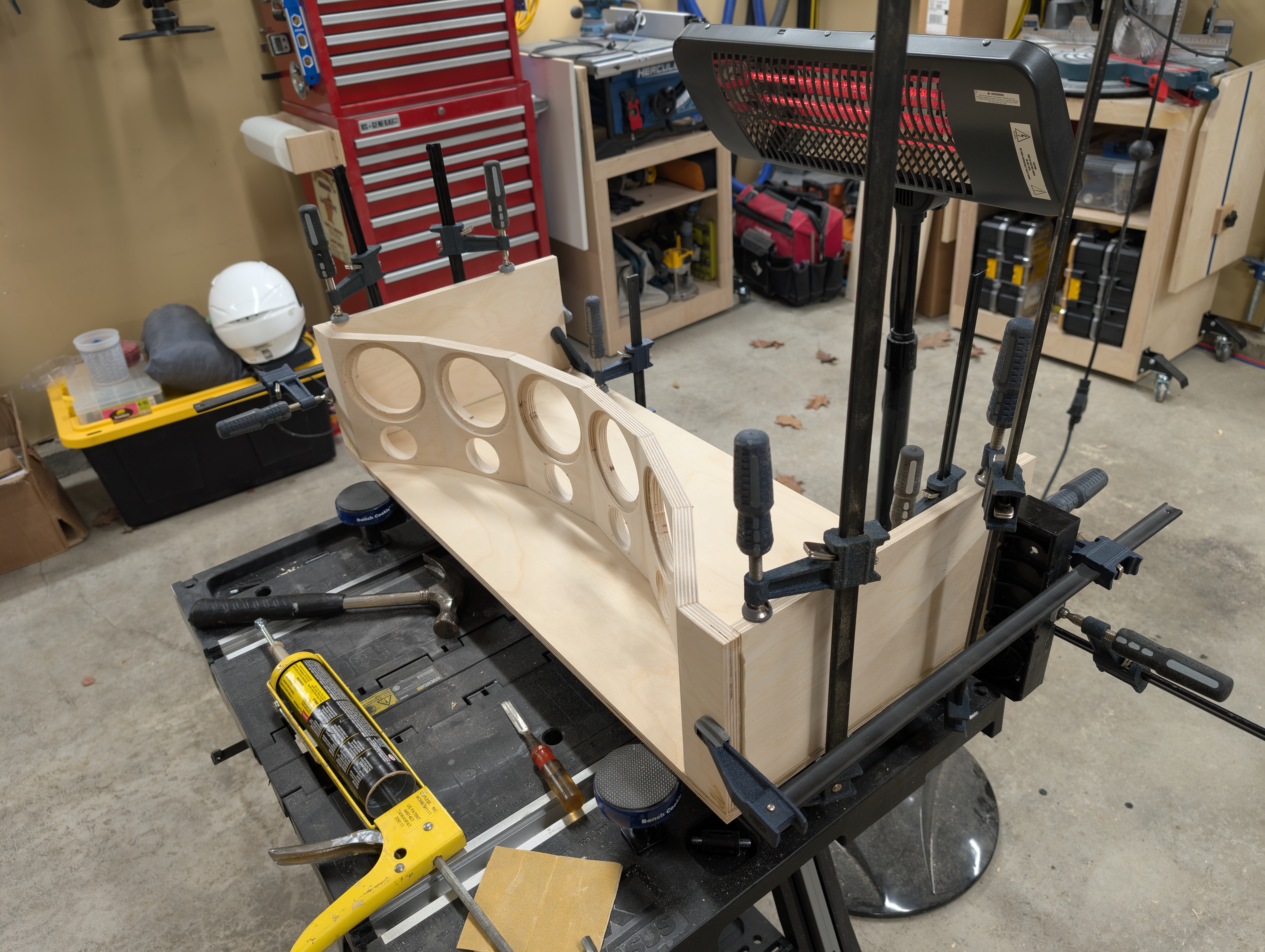

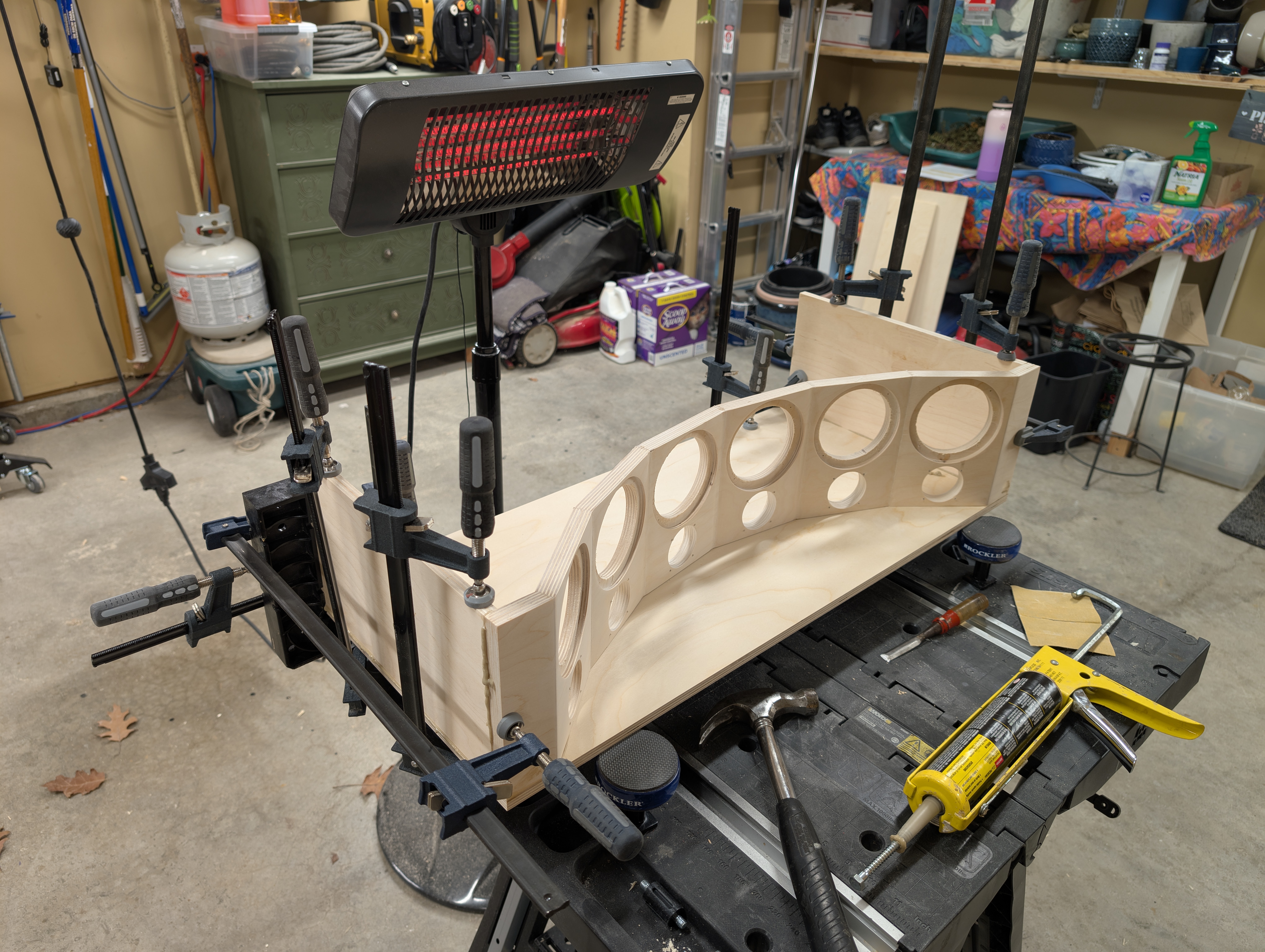

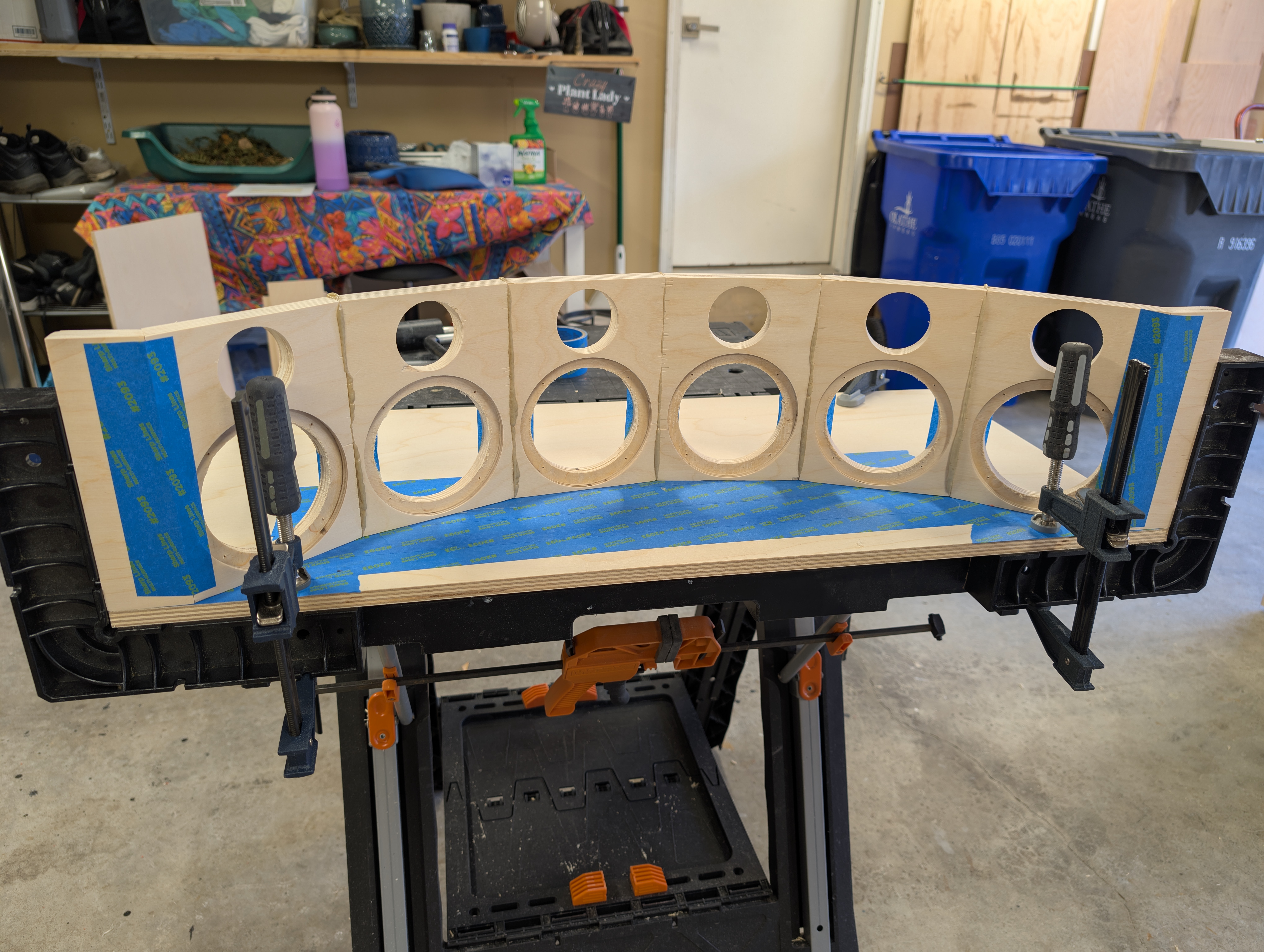

#27 Post by shane2943 »

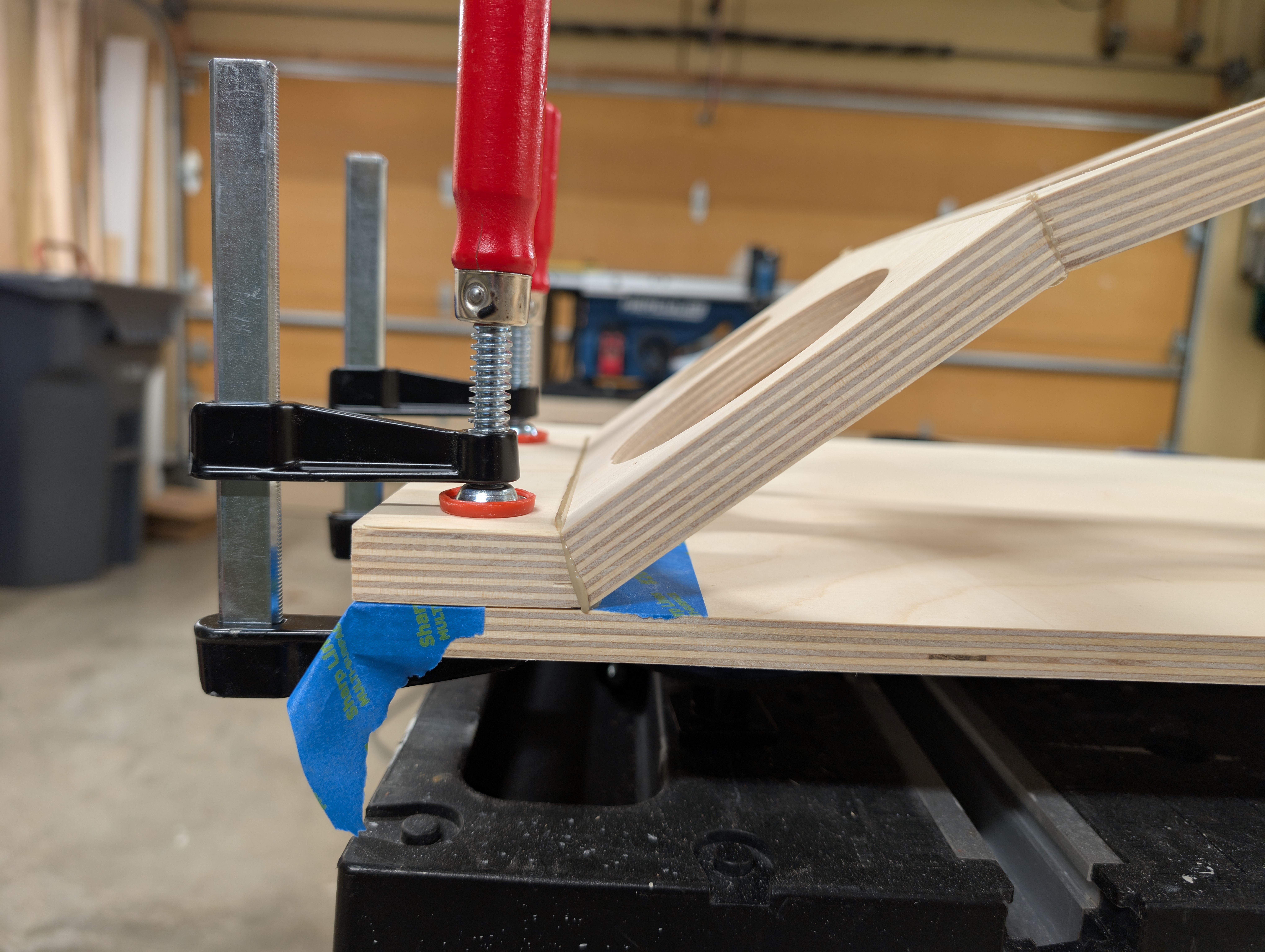

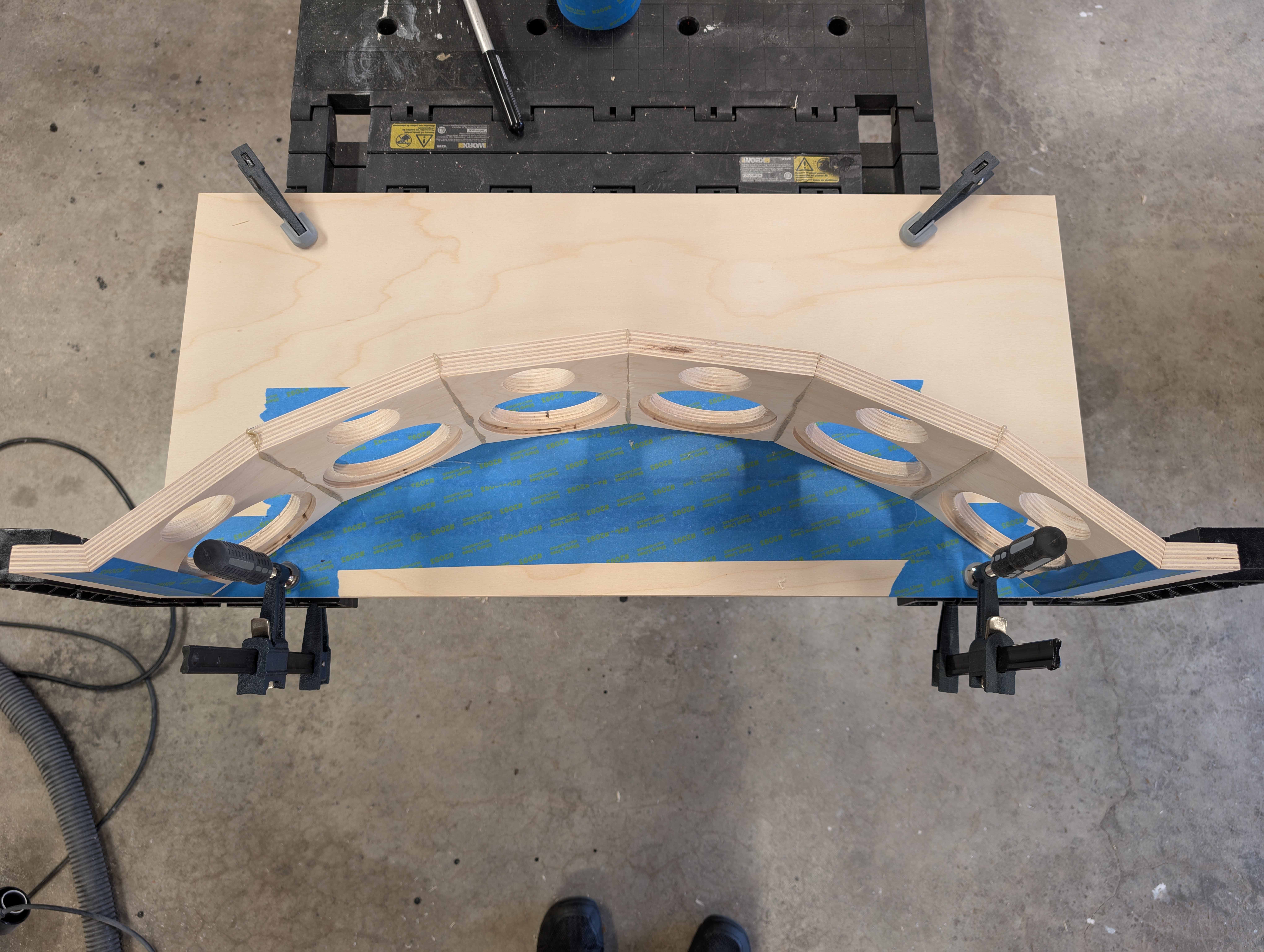

I found that using the tape method was easier to assemble and glue the baffle segments together than the method in the plans. I just used painters tape as "hinges" on the back side of the baffle segments, applied glue in the joints and then curved/clamped the whole thing in place. Was really easy and everything was perfectly aligned. I didn't have to use hot glue to hold the baffle in place when attaching it to the top.
I also elected to use 3/4" baffle segments so that I can recess the midbass drivers.

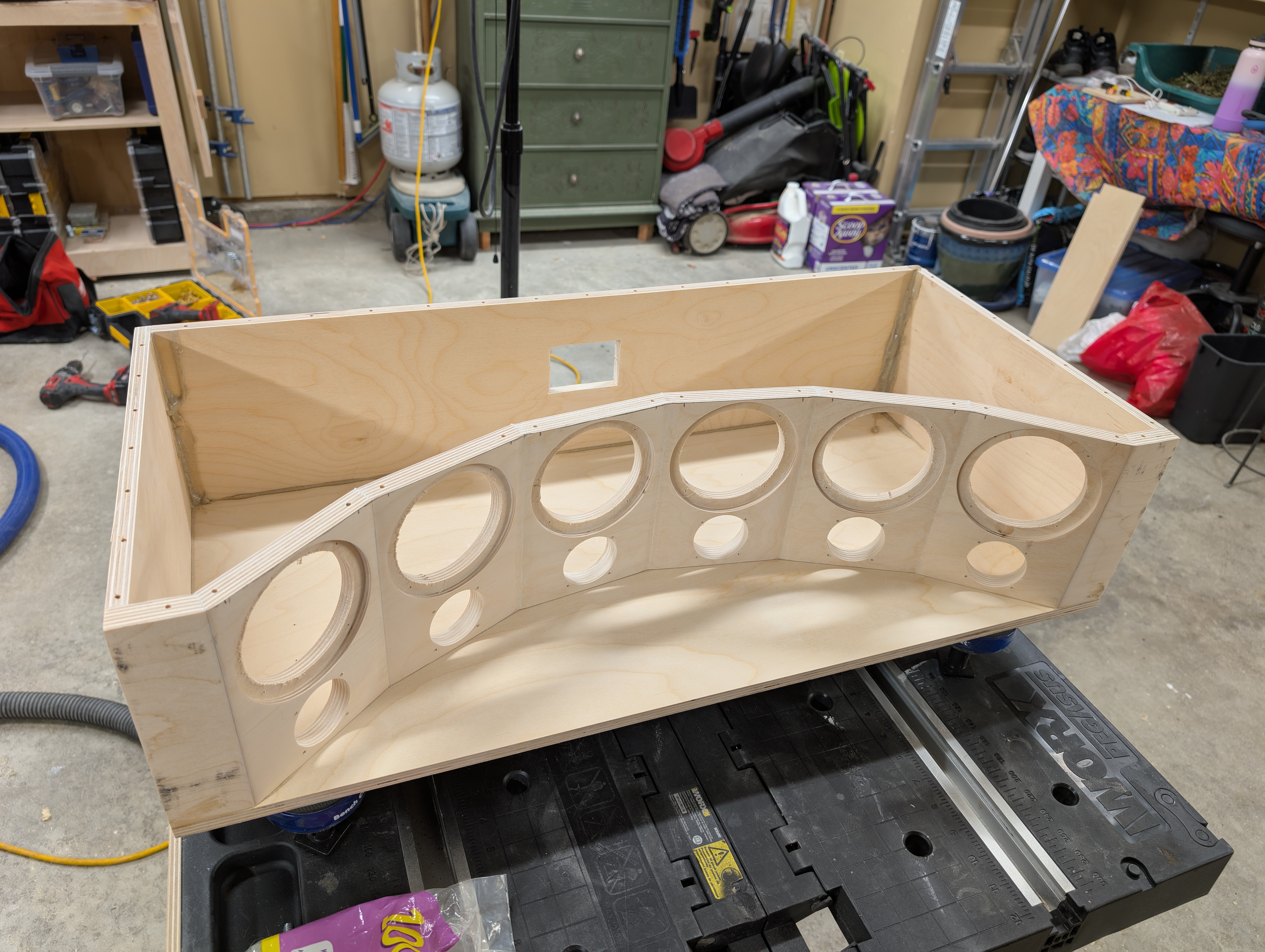

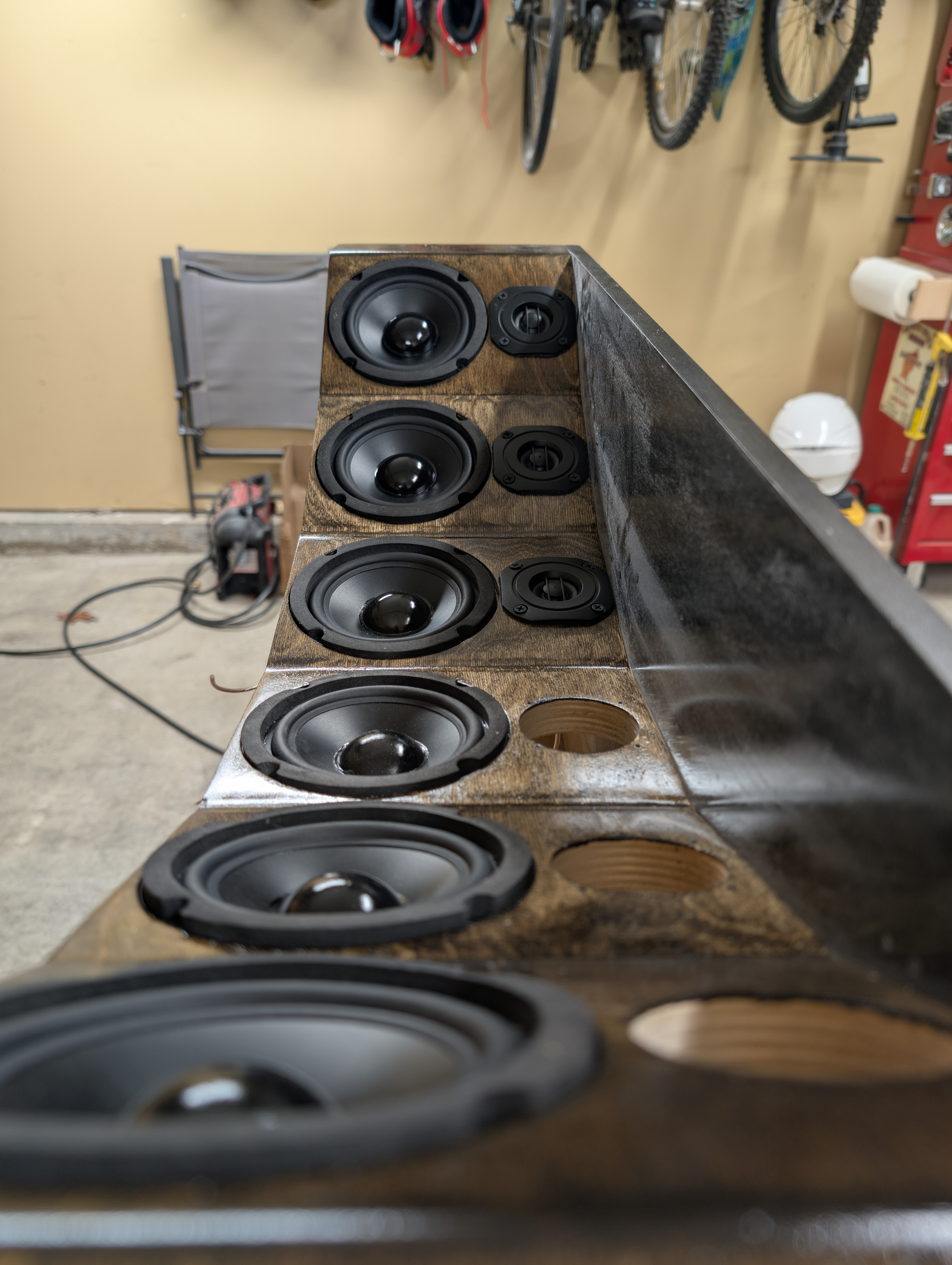

More progress!...
Posts: 3055
Re: 24" THTLP with TLAH towers and SLA curved center channel
#28 Post by Seth »
That's looking really good! Wow. Nice detail choice to use the thicker ply and inlay the drivers. Well done.

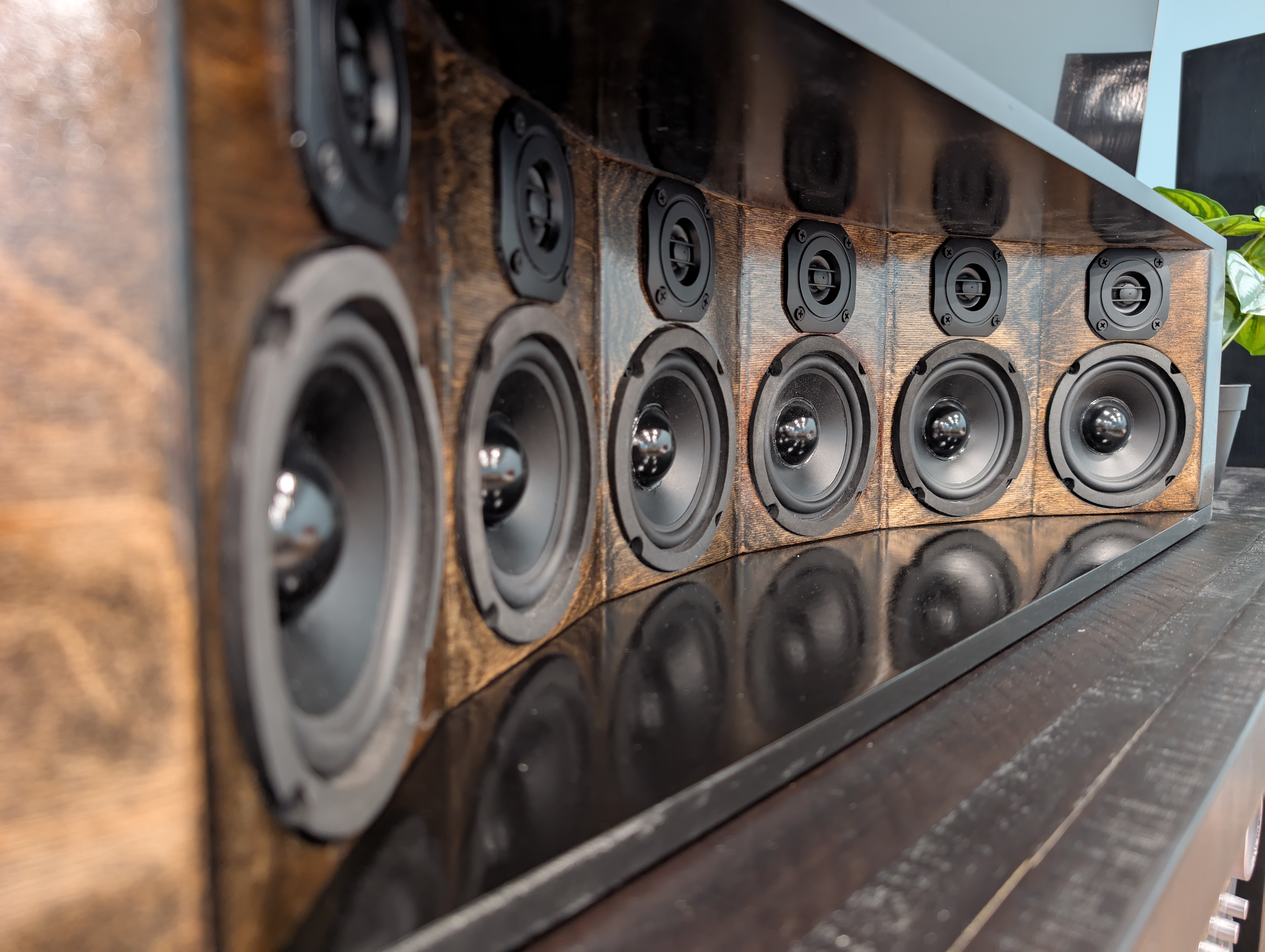

It's currently just about finished,but I'm waiting for a capacitor to ship from Parts-Express since I originally ordered the wrong one (stupid decimal placement) :bash: :bash: :bash: I'm impatient damnit! lol
shane2943
Posts: 263
#30 Post by shane2943 »

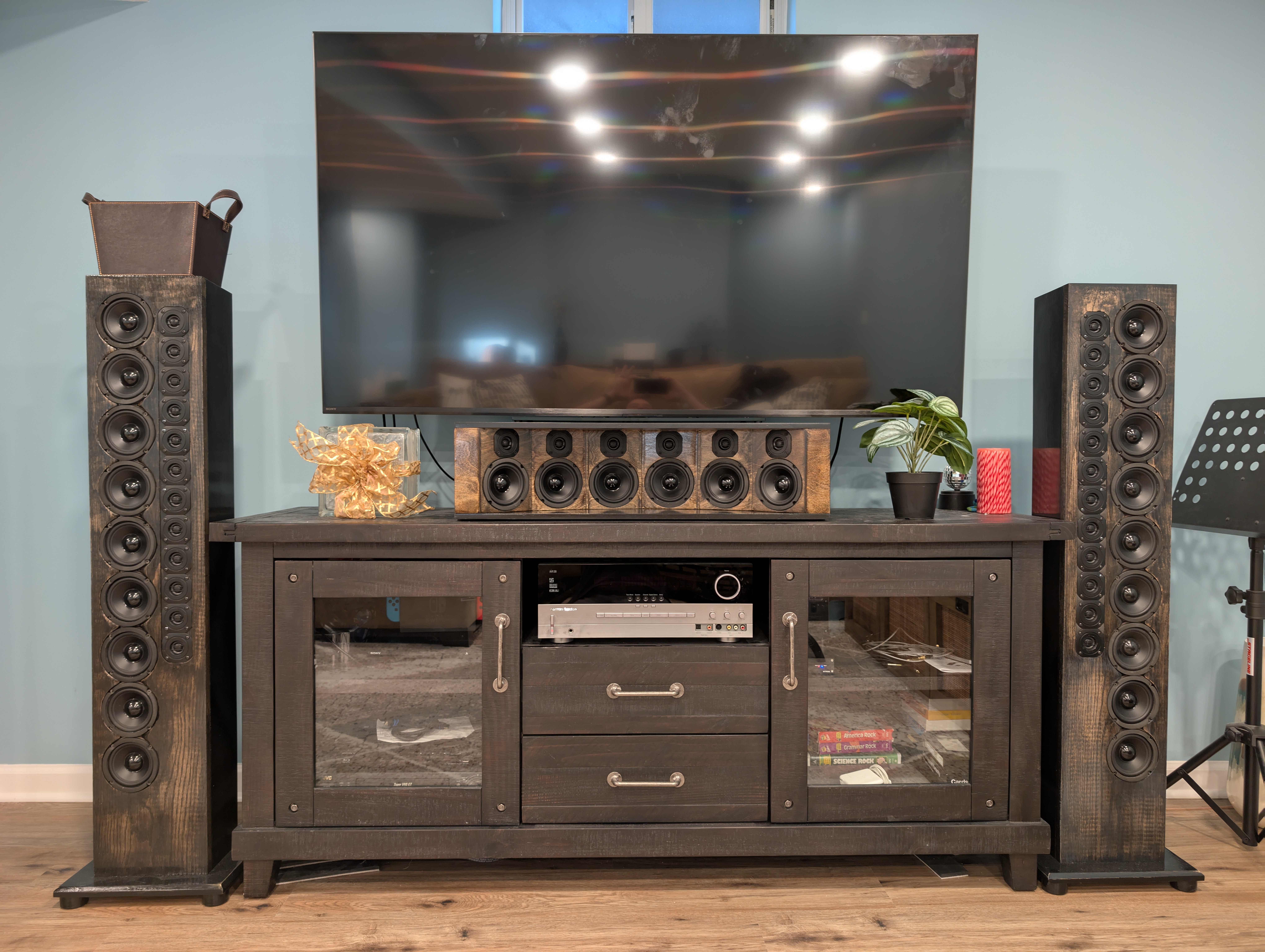

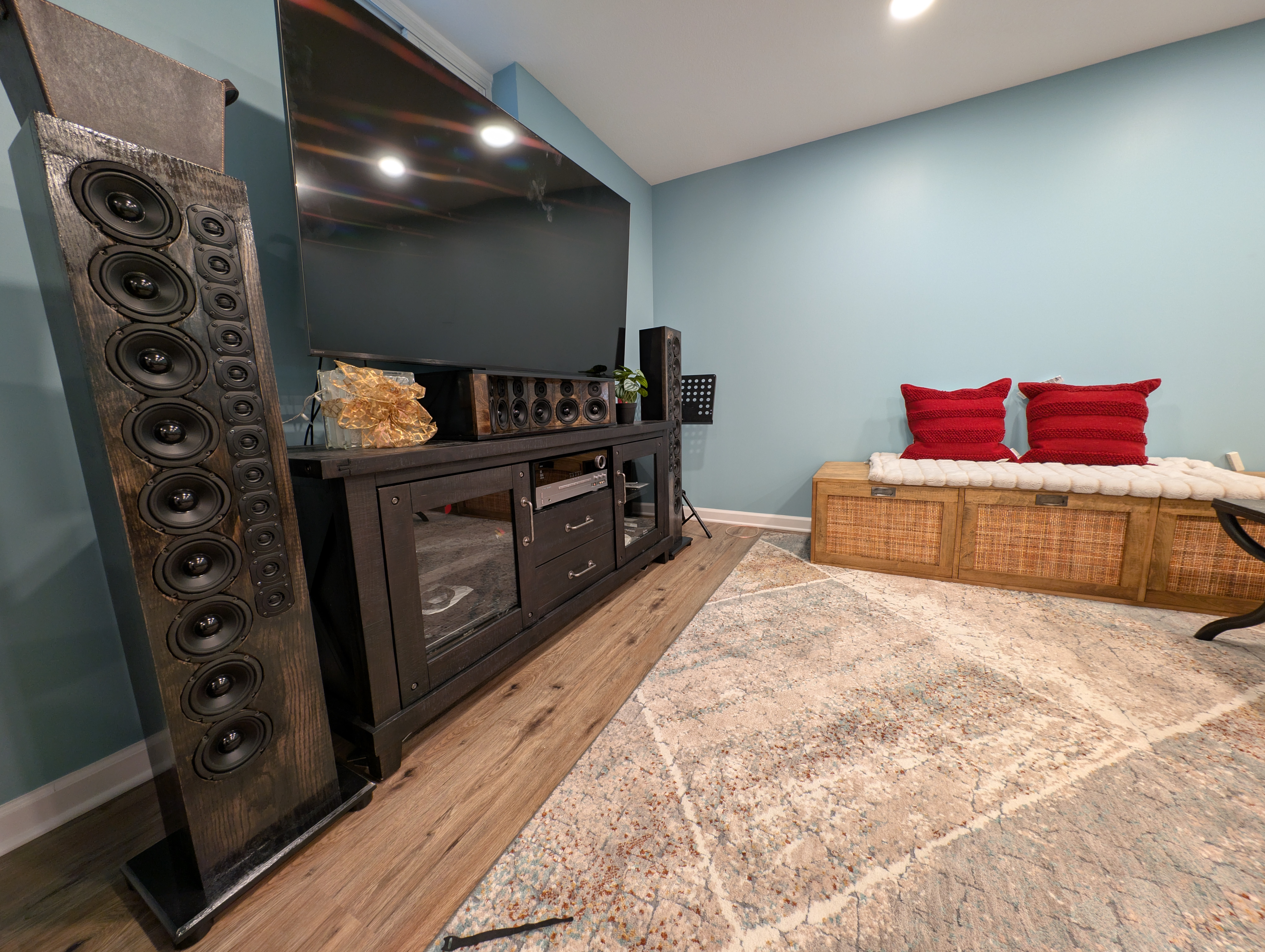

Got 'er done!! Pitchers attached.
I'm not sure I'm loving the sound though. It sounds hollow and kind of "clock radio" like. Going to do some testing with sine sweeps to figure out what mid bass frequencies are too hot. Not sure what I can do about them when I find them though.
It looks perty though 8)
