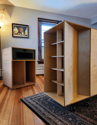

I just finished building a 36" wide TubaHT LP subwoofer. I am trying to blend it with my '85 LaScala speakers. I am new to blending subs/speakers, DSP, etc. I would like to ensure that my speakers and sub are time-aligned. Given their locations in relation to my seated position, I assume that I need to add delay to my LaScalas. If so, what is the best way to go about doing this without effecting sound quality?
Current gear chain:
Bluesound Node 2i --> VTA ST-70 integrated tube amp --> LaScalas.
Bluesound Node 2i (sub out) --> MiniDSP 2x4HD --> Behringer NX-6000 amp --> TubaHT.
I assume using my MiniDSP 2x4HD to add delay to my LaScalas would degrade sound quality (?) If so, are there higher quality options out there?
What would improve if my speakers and sub were time-aligned? Right now, the crossover is set to 100hz. I may go as low as 80hz.
