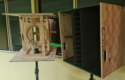

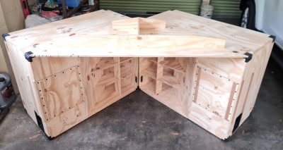

Yes, l can't read plans properly so l cut all the panels at 36", so it's a 37" T48! I'm lucky l have long arms, because l struggled driving screws into panel 9, l was up to my neck in the horn

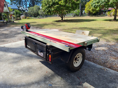

Yep, they're next! Just need to find one more LAB15 to build 4 Here's a conveniently accidental mobile saw table for when l'm on a chopathon away from the house

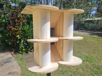

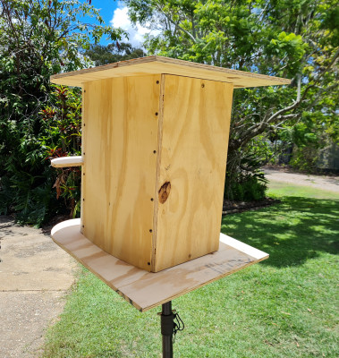

Great day for it lads, had time to do a bit this weekend, the piezo module kicked my butt last time.. we'll see how round 2 goes. Not including the finish & tune, feels like I'm over half way there. Hope you guys are doing well, cheers
Re: DR build questions
Great look'n birdhouse you've got there
