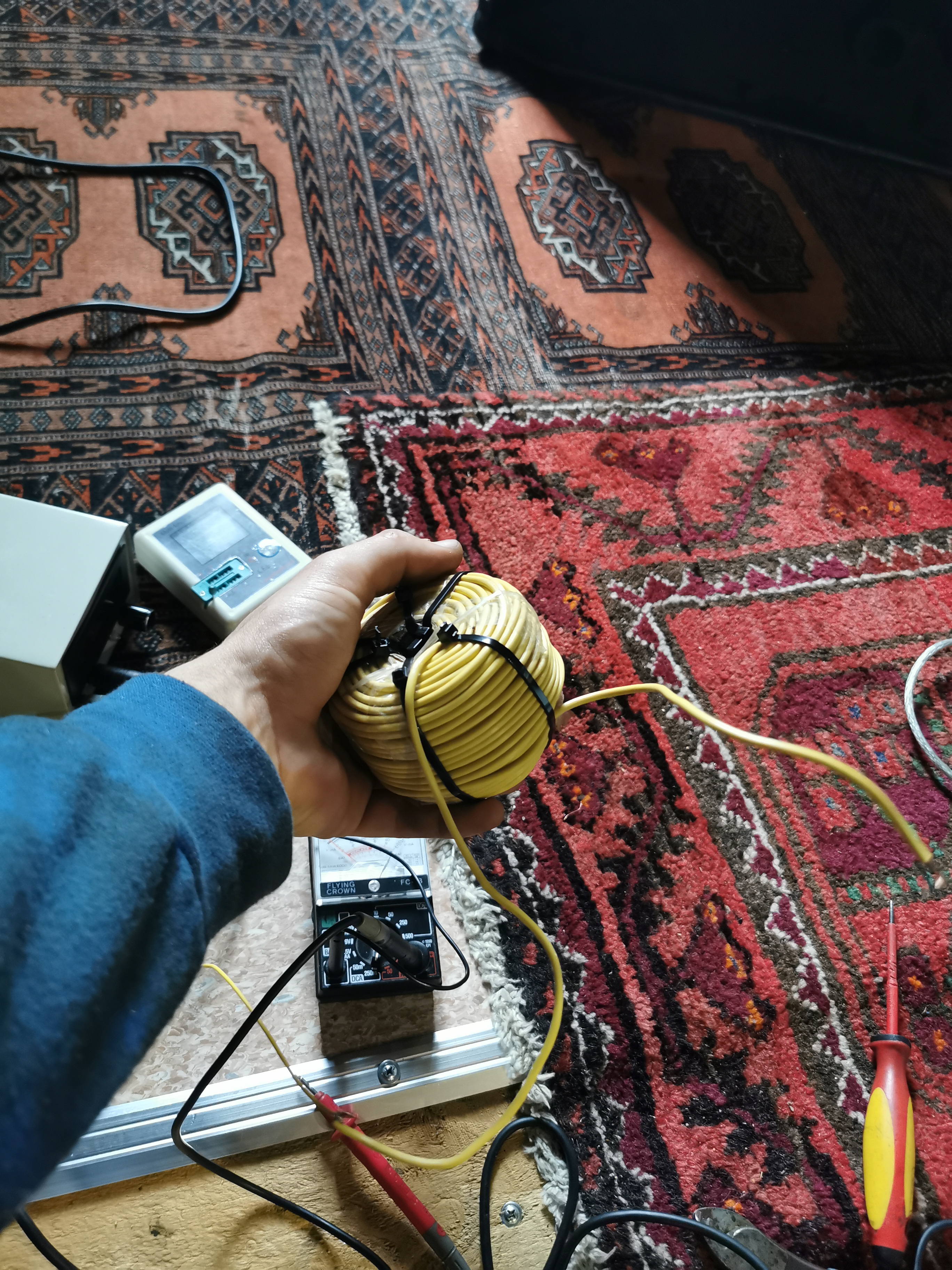

Hi!
Asking about making coils yourself, some People warned about fire risks if not using proper tools. It is easy to buy them but... Its more fun to make them yourself i think! :D
I picked up some enameled wire about 16 awg at a flee market and tore down every transformer i could find and made some coils, ordered a cheap inductor-meter and never got the ohms under 0.7. Watching some Youtube some months later made me double check them with ampere-meter and calculated and with that measurement they all seemed fine under 0.4! (apparantly the cheap tool isnt that good and perhaps the Mh is a bit off also but it seemed okay with coils i knew the inductance off)
So to my questions, i just picked up some ordinary "home-cables" (english?). Heavy plastic or silicone insulated awg from 13-16. I know The size will be huge and that i probably need more length to get to the right inductance but i played around today and made a coil from 14/15 awg multistranded(?) heavy insulated wire. A piece big as my hand and weighted a lot with an inductance of 1mh and 0.45 ohms air core.
Is this neccesarily a bad coil, not to be used at all?
How much better is litz or enameled wire, just considering quality of a coil with less copper, closer together?
Another tip i got is to use capacitors from industrial lamps, fluoroscents with approx 8uf 250v, thoughts?
I run biamped and use active crossovers so this is more educational for me but.. Is this nasty crossover-making? :lol: :lol:

I see, i was just curious what the cons would be and it looks quite.. Different, and it would be fun in 20 years when someone opens a speaker and find more kgs of copper than needed😆
but i honestly would like to know how it behaves electronically when the insulation makes the wires so far from each other, compenssred with larger awg for DC-resistance when using, what i believe, longer wire. Hard to find many sources online so perhaps It's just stupid? And mostly because i have a lot of that wire to play around with..

Camillo wrote: Mon Oct 02, 2023 7:10 pm ...but i honestly would like to know how it behaves electronically when the insulation makes the wires so far from each other, compenssred with larger awg for DC-resistance when using, what i believe, longer wire. Hard to find many sources online so perhaps It's just stupid?
Inductors store energy in magnetic fields for a short period. The proximity of the turns or winds exponentially increase magnetic flux, making the inductor work better.
The thin enamel coating allows the turns to be as close together as possible, increasing flux.
Household wires have larger sheaths as you've mentioned, increasing the distance of the wire in the turns, which decreases magnetic flux. It is also to heavy in AWG and physical weight terms, and not required for power handling of the inductor.

Oh! So Even with enameled wire the awg can be too heavy? If I remember correctly, an air core coil with less than 0.5ohms DCR would be around 16 awg for the 1.8mH one would need for the hf-section in some of the plans i have, that is thicker than i've seen in most speakers i have opened though.
Also, i've read that DCR should be less than 5% of driver impedance (?). When connecting 8 ohms in series -16-, could one then - theretically- use higher DCR in a coil? 1 ohm? (I know it still says 0.5 in the plans, just curious, as an example)

No need I understand, but is it bad to use heavier AWG? Low Q of the coil? I might order enameled wire and would it be bad to order a lot of, let's say, awg 13 to wind all the coils. 0.9 mH, 1.8mH, 2.2 mH and so on.
You will notice the values of components changes based on impedance the filter is for.
Yes, but does the DCR requirement theretically change, would a 2 ohm setup, that isnt in the plans, need lower DCR theretically?
