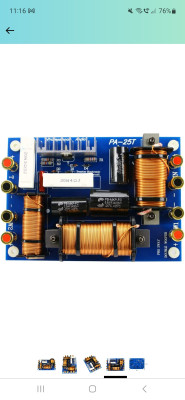

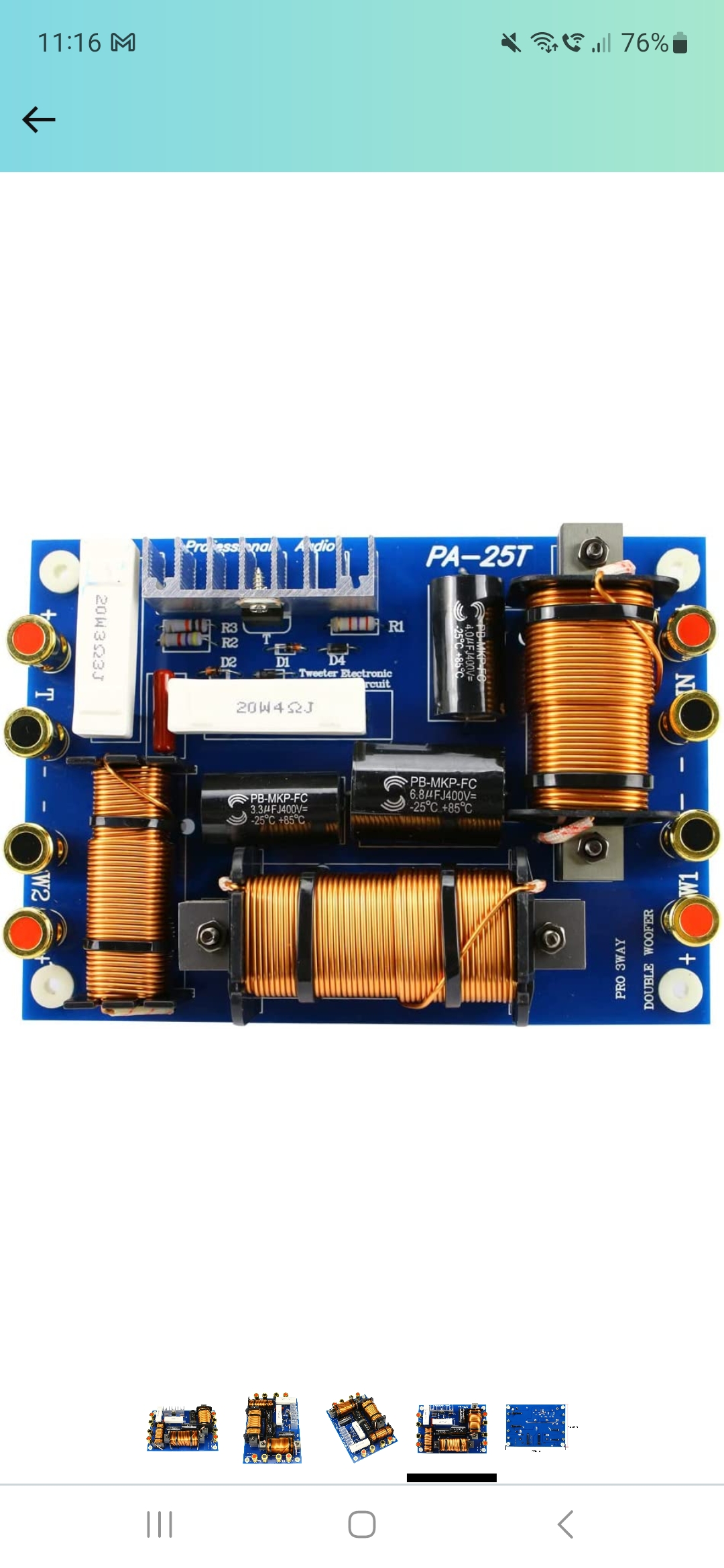

Hey all, after building my tuba 30s, I'm now in the process of building 2 omni top 12s. I'm using a faital pro 12fh520 as the woofer and 6 of the Goodwood piezos as the tweeters. The woofer is rated for 600w rms and the tweeters at 50w rms each. How would I go about limiting the cabs? Altogether the cab should be able to handle 900w? Or am I wrong in assuming this. Also I've seriously struggled to find crossover parts in perth, Australia after visiting multiple shops. I didn't want to pay 5 billion in shipping all the individual components from the USA so I've had to settle on a pre-built crossover I have found which has the same 2khz crossover point and 12db/octave filtering characteristics. The crossover comes with 2 woofer outputs but once again I'm assuming I can just use one of the outputs and not compromise power output and what not. I've attached a picture if that helps. Thank you!

That crossover will not work. Off the shelf crossovers are designed to work with the resistive load of a dynamic driver. Piezos are capacitive loads. There are no off the shelf crossovers that will work with them.

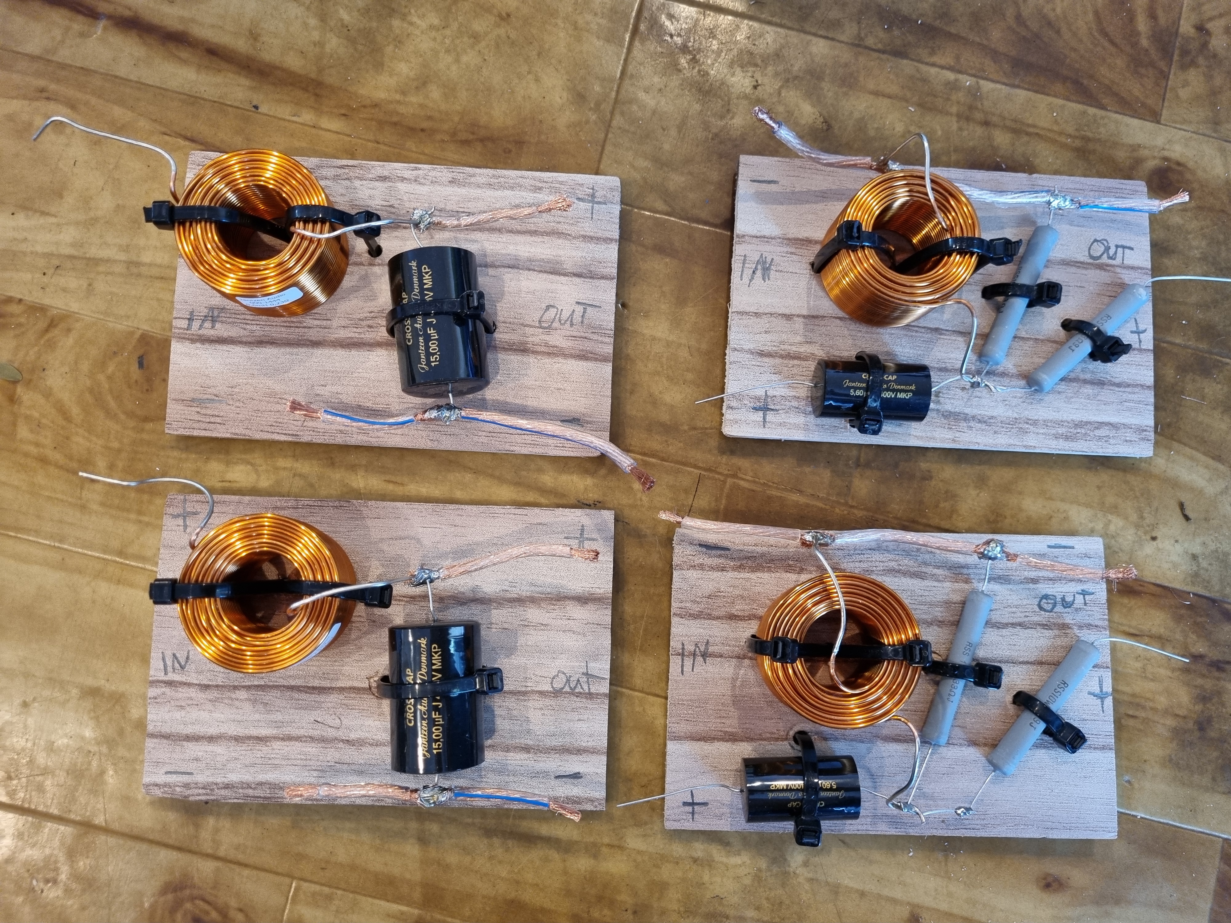

#11 Post by Bigrob1234 »
How's this looking?
Re: Need help with crossover/limiting omni top 12
#12 Post by Grant Bunter »
Looks good to me.
Next time, no need for such a heavy gauge inductor on the HF board...
