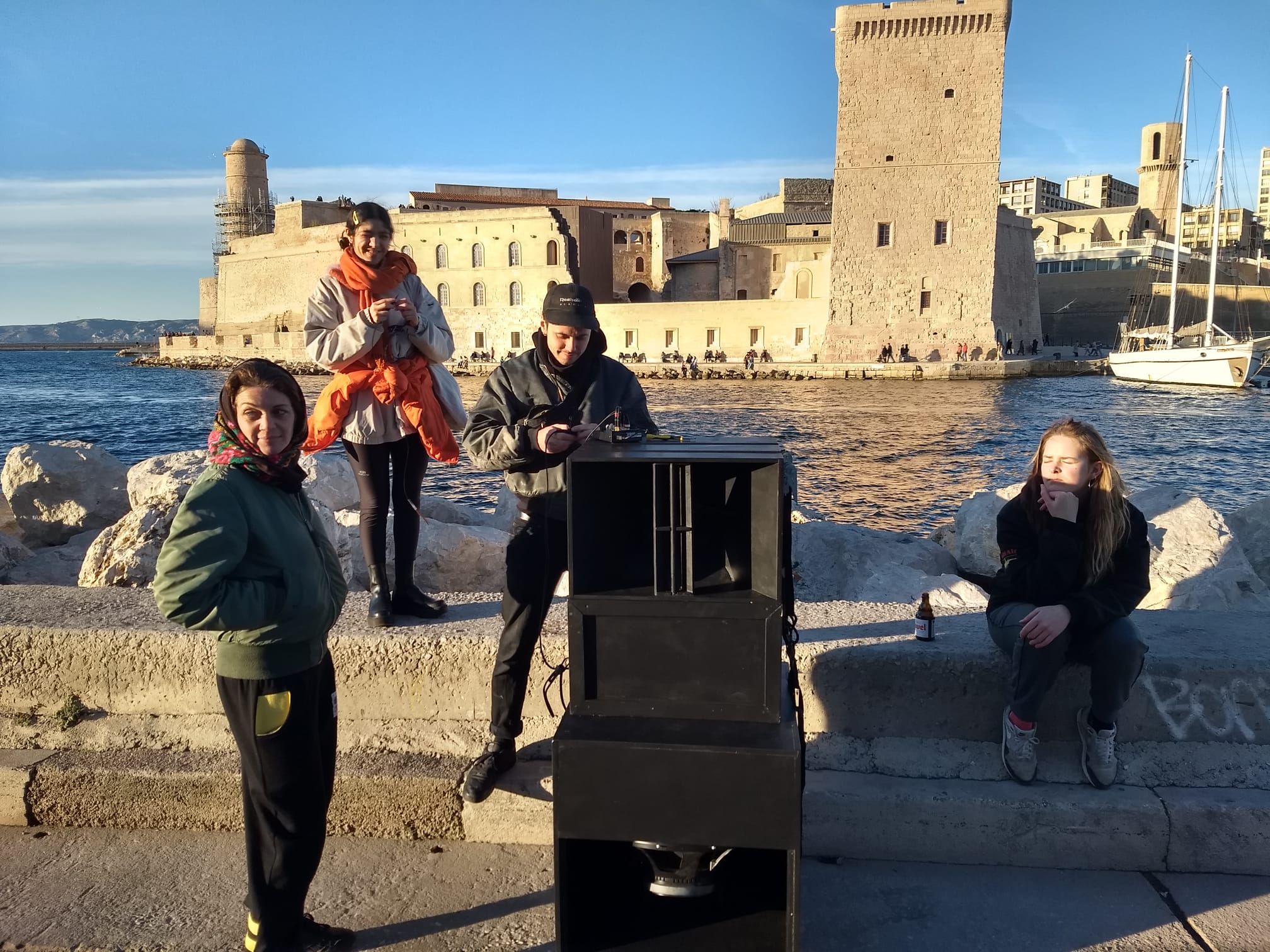

A little update on this thread. The OP and I had a bit of back and forth in PM's late 2021 into January 2022. He sent me this update last March...
hey seth,
Ive been meaning to write you for ages. Sorry for the delay. Thought i should at least let you know how it all went and what we ended up doing after you provided us with so much very helpful advice!
The project went great ! and we were all very happy with the result. I'll attach a couple of pictures of the portable system and its first few outings in Marseille.
Like you said the output from Omnitop12 was very suprising! and can very much overpower the Cubo15 sub. We ended up building the passive crossover as we had already ordered the components and they were actually not too expensive. ( we even wound one of our own coils but this was on some fruity advice from a friend of mine and was definitely not cost or labour efficient).
Although a good idea of yours, we didnt have enough time in France to sell one of our amps in aid of buying a DSP, but you were clearly right we didnt need that much power for just these two boxes! However biamping with those amps we had bought allowed us to get the levels right between the two boxes- in liu of a DSP. As we have extra power at our disposal we now have the plan at some point in the future - (when we are all back in france and theres more money/time for the project )-to build some extra boxes and add that DSP :).
As we had an old minimixer at our disposal we are using that for some crude EQing and like i mention we are using the gain on the respective amps to make sure the OT12 isnt getting carried away.
I really like the sound of the system but feel theres a little hole in the frequency representation around 120hz. no matter how we crossover between the two boxes (using the amps freq controls). Now, i imagine this may be because of the crude crossovering but i thought it couldn't hurt to add a kick cabinet 12 or 15 into the system (something like this? https://www.freespeakerplans.com/plans/ ... -cubo-kick What do you think?). The idea to add more came from the fact that as the design is modular and the system is actually not always being used in the bike trailer we could have this kick cabinet and another omnitop- without adding more amps - and that this could be the systems expanded mode for when being delivered to a single location with a vehicle. This also means we get possibility of stereo when the context allows it.
Anyway , it was a great couple of weeks. and the whole group learnt alot. i feel like i faked it till i made it, in terms of guiding the thing, and again wanna thank you for making that possible.

That's unfortunate. The Cubo 15 appears to be an attempt at a tapped horn, but not a successful one. The horn is too short to act as a horn, but rather operates as a tapered port. The result isn't even as good as a well designed ported cab of the same size.
The response issue he had at the crossover frequency was probably polarity.
