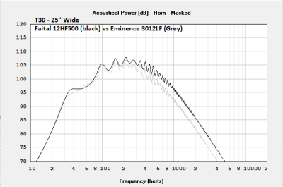

Will a Faital Pro 12FH500 work well in a 24" wide (internal) Tuba 30? Here are the specs:
THIELE AND SMALL PARAMETERS
Fs 45 Hz
Re 5.1 Ohm
Qes 0.26
Qms 6.9
Qts 0.25
Vas 87.3 dm^3 (3.08 ft^3)
Sd 529 cm^2 (82.00 in^2)
Xmax 7.50 mm
Xdamage 21.55 mm
Mms 56.0 g
Bl 17.5 N/A
Le 0.83 mH
Mmd 42.2 g
Cms 0.22 mm/N
Rms 2.3 kg/s
Eta Zero 2.93 %
EBP 173
Link to Datasheet: https://faitalpro.com/en/products/LF_Lo ... =151050100
Does anyone know how to graph the response on this combination? Thanks in advance

Yes, the driver is within spec for a T30, T45, and T48. Might be okay in a T39 too. Just barely out of QTS spec.
Disclaimer, the chart below was derived by reverse engineering the dimensions in the plans and entering them into the horn modeling software, HornResp. I believe they are close enough for the sake of driver comparison. Although, I wouldn't count on them being ultra accurate.
12HF500 vs 3012LF

Seth wrote: Tue Nov 29, 2022 2:32 pm Welcome to the forum.
12HF500 vs 3012LF
Thanks very much. Which part of the enclosure did you consider the throat? and how many segments did you use? I have hornresp but have never reverse engineered a design. Thanks again!
