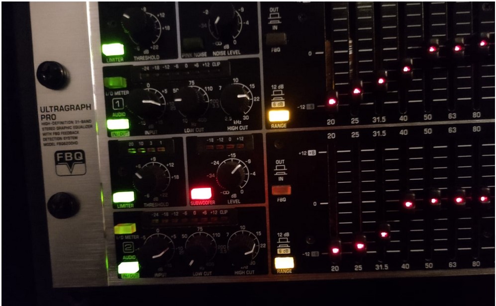

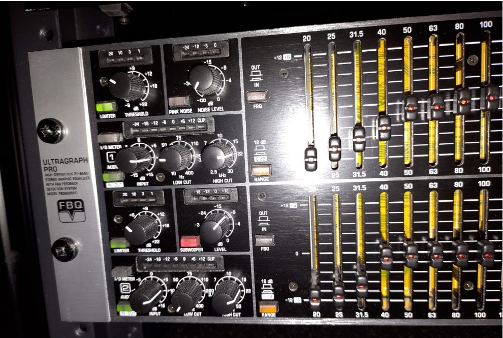

Here is how the settings look on the important part of the EQ with and without the help of a flash.
As you can see here, I did drop the frequencies below 50 Hz for the tops, even when the main tops have 2 12" BRs so they have at least some capablilty for LF. The second Tops are as of now just my home chinema Fronts (Monitor Audio Silver 500, running on a much reduced amplification to keep them safe. They are just used to help fill the room and reduce the directionallity from just one pair of speakers). My Yorkvilles are still in the move. Those also have a 12" and will hang from the celing while the main Tops are standing on the podium in the DJ booth.
Both pairs are powered by E800 T-amps: https://www.thomann.de/de/the_tamp_e800.htm (so one each)

Re: Yet another newbie, sorry guys
Read the FBQ6200 user manual Andre!
From it I got this: whatever you do on the front side of the FBQ6200 also does the same thing to the subwoofer output.
Having said that 40-50Hz isn't a bad place to start dropping down EQ.
There's a slightly floored thinking on your behalf in that the tops are helping the subs with LF.
They may not be, in fact, they may be hurting the subs output, because you should never use different designs in the same bandpass, ie, subs and tops.
That can lead to frequency cancellation do to differing phase response amongst other things.
In a arguably better world, you would feed the sub from source that lets you set it parameters, and the tops separately
What's the sub output filter dial set too?
How far are the subs away from the nearest wall?

@Grant: As far as I remember, all I have is the quick guide. Same thing that I can download at Behringer.com. Can't find a complete manual there.
In the quick guide I can't see that it says that the EQ settings affect sub and general range alike. Can you point in to where it says that?
As far as I was concerned, the sub has its seperate output with its seperate, quite limited controls (dial 24 and bottom 25). The output level vor the sub is nob 24 and it is set to something like -11 dB. I took the picture so that you can see the setting.
As for not being able to control the tops seperately, what is the function of high cut and low cut dials No 6 and 7 if not to determine what part of the incoming signal gets to reach the Ultra Graph channels 1 and 2 and therefore the power amps and ultimately the Top speakers?
It does say for the Low Cut dial: "The high-pass filter (18 dB/oct.) covers the range between 10 and 400 Hz". I should be able to use it to determine how much of the low frequency are reaching the Tops. If I set it to 400Hz, there should be not a lot low end coming to them at all. That should leave the low end to the sub out only. Depending on what I put dial 24, the cut off for the sub.
Should that not allow me to separate what freq is to reach to Tops and what is to go to the Subs?
This is really basic and I thought I had this, but if I don't please tell me.

manual:
Go to https://www.behringer.com/downloads.html scroll down to your model number in a drop down box somewhere in the middle, click it and all documents related to that model number will come up. You want the manual, not the quick start guide, which you have already.
That's where it says (under the sub out heading) whatever you do to will also affect sub out. So, eg if you set low cut/high pass to 400Hz, then you get no sub output.
Why is it there like that? Well, for example let's say you were using the unit after crossover system outputs. You might have a mid/high send for example, on one unit, where you want to make sure that the mid/highs aren't trying to reproduce what should be in the subs.
So use the low cut.
But you're situation is different. You don't have a crossover, you're trying to use the controls on the unit to try and make it act like a crossover, but it's not, or, if it is, it has limitations.
One way you could get more sub control if you use a mixer, is to feed the subs via an auxilliary feed.
I'm wondering if we should just give you some time to try all the stuff suggested so far. You get back to us when you're ready, tell us your findings, we move on from there...
