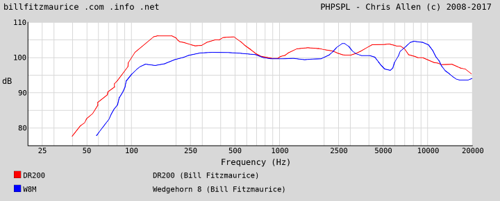

Yeah, I hear ya on that Anton. I know the sales page talks about that and it's also mentioned in the SPL charts section that they're designed "specifically to accentuate the vocal range from 250 to 800Hz".
However, the charts indicate a very tame response with a slight increase in that range. Nothing drastic at all and would likely require less EQ than a DR200

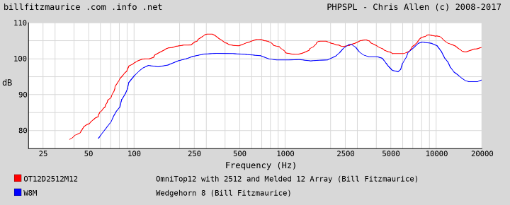

Here it is compared to an OT12. (there's no data in the chart tool for an OT8)
To my eye, the Wedgehorn 8 appears as though it would require the least EQ out of these 3 cabs.
That said, I have absolutely zero experience with the Wedgehorn 8, as a PA speaker or otherwise. So... take it for whatever it's worth.

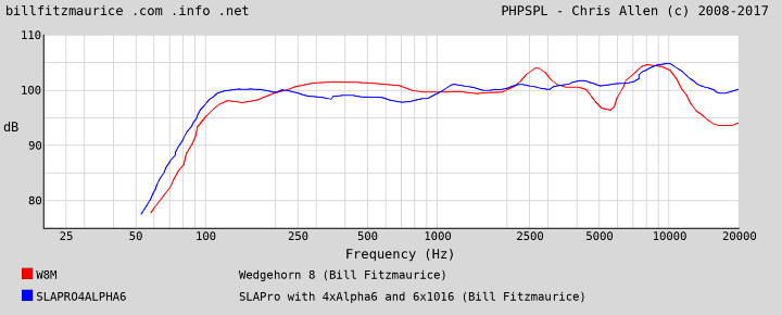

... matter of fact, it's almost as smooth as the SLA Pro's response

Well spotted Seth, I stand corrected. And I actually own a pair of both WH8 and SLA Pro myself. I have never attempted to EQ my WHs to flat response. My SLA Pro do require some and it makes them shine.

From 6000-8000Hz, that looks like a step of about 9dB. That's one hell of a jump to tame.
