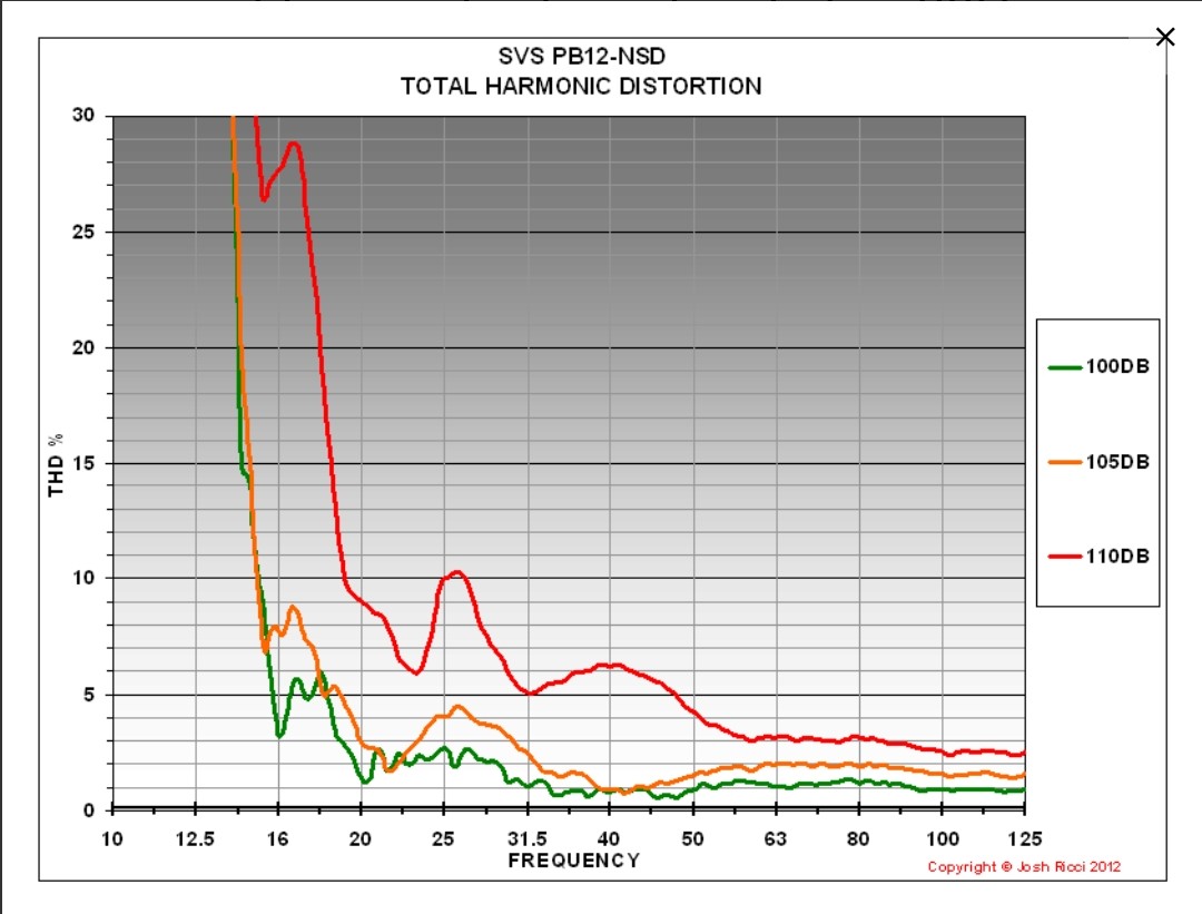

Attached is an outdoor compression measurement of the pc12 boxed brother, the pb12. They are identical in output.
And total harmonic distortion.
How would you the think the slim THT LP, will compete against this?

I know I'm in the process of answering my own question.
But: say I listen to movies at -20 dB, with dynamic EQ that adds approx 10 dB to the bass levels. And I run the sub 8 DB hot.
That's 115 - 20 + 10 + 8 = 113 dB.
If the SVS is only capable of 103 dB + cornor loading (9db) = 112 dB, I've actually already maxed it out? Theoretically, at the max possible output. - this is where the 10%THD sets in.
This is possibly why I think my TT sounds better, even though it has a few Hz less extension?
And, from the looks of it, it's not actually a true 18 Hz extended sub. That's more like a 6 dB drop from 25 hz, not even including the compression at the highest levels.
So for me, it looks like the THT will reach 25 Hz at nealy all levels with ease, and then decline from there. Not adding THD into the mix - and there for sound alot cleaner.
I guess true 25 Hz extension is better than strained 18 Hz extension.

Where THD and power compression are concerned the THT will beat any direct radiator of comparable output. Ever read this page? https://billfitzmaurice.info/THT.html
