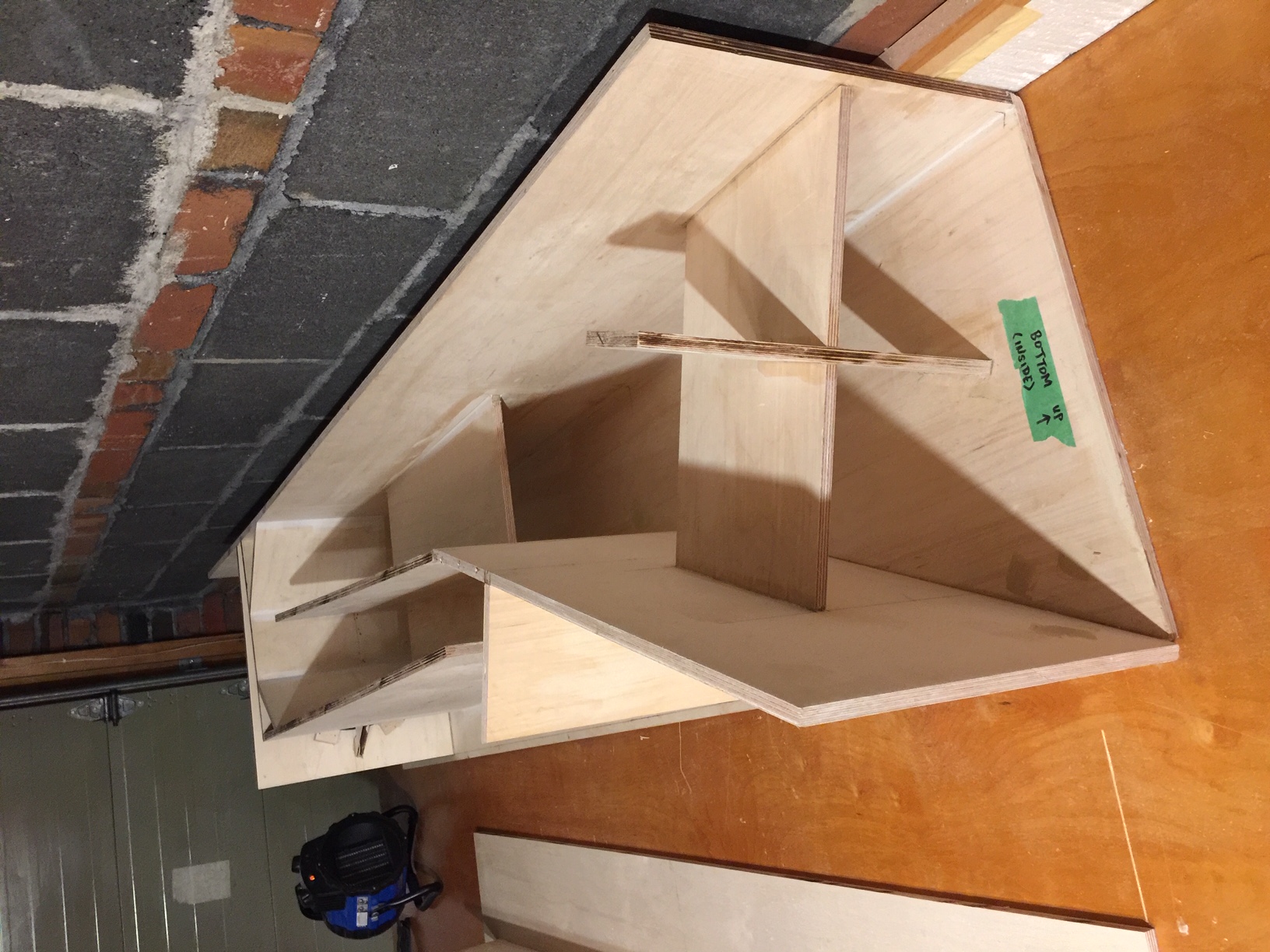

I began the day by installing panel 10. It's a small panel and installing it took hardly any time.

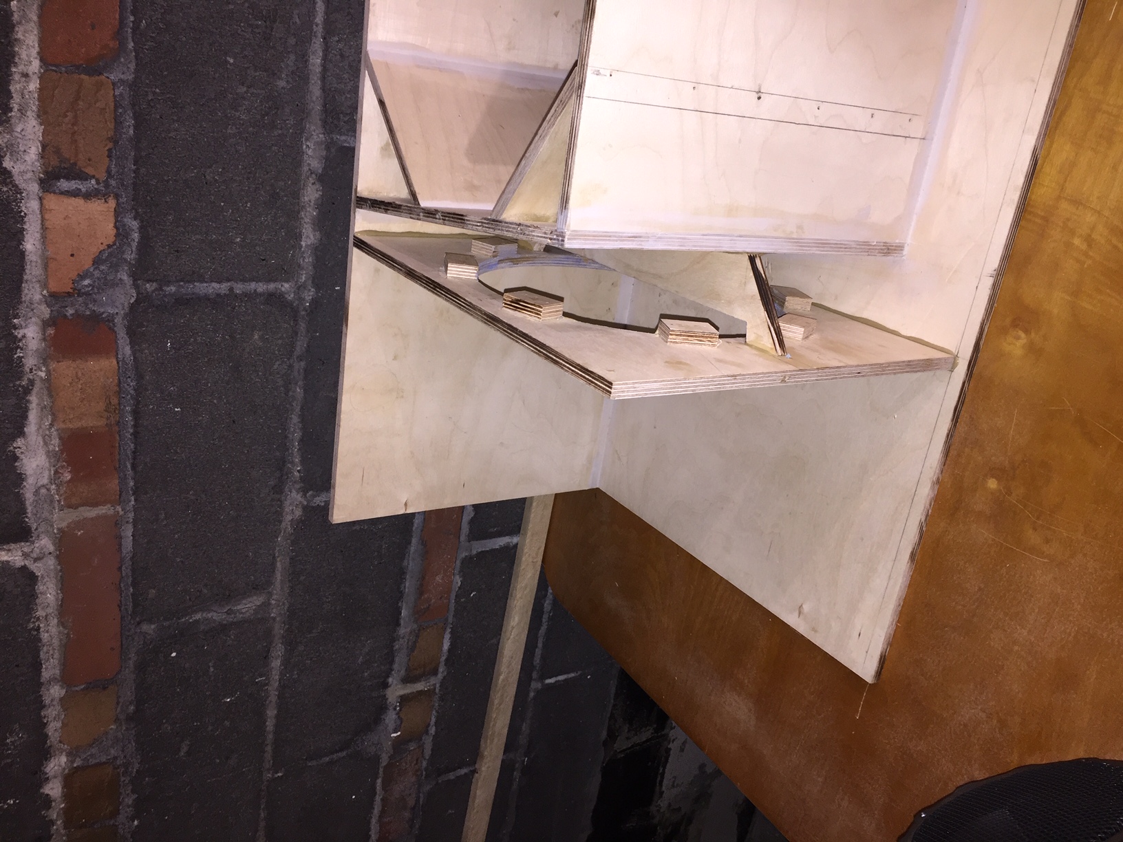

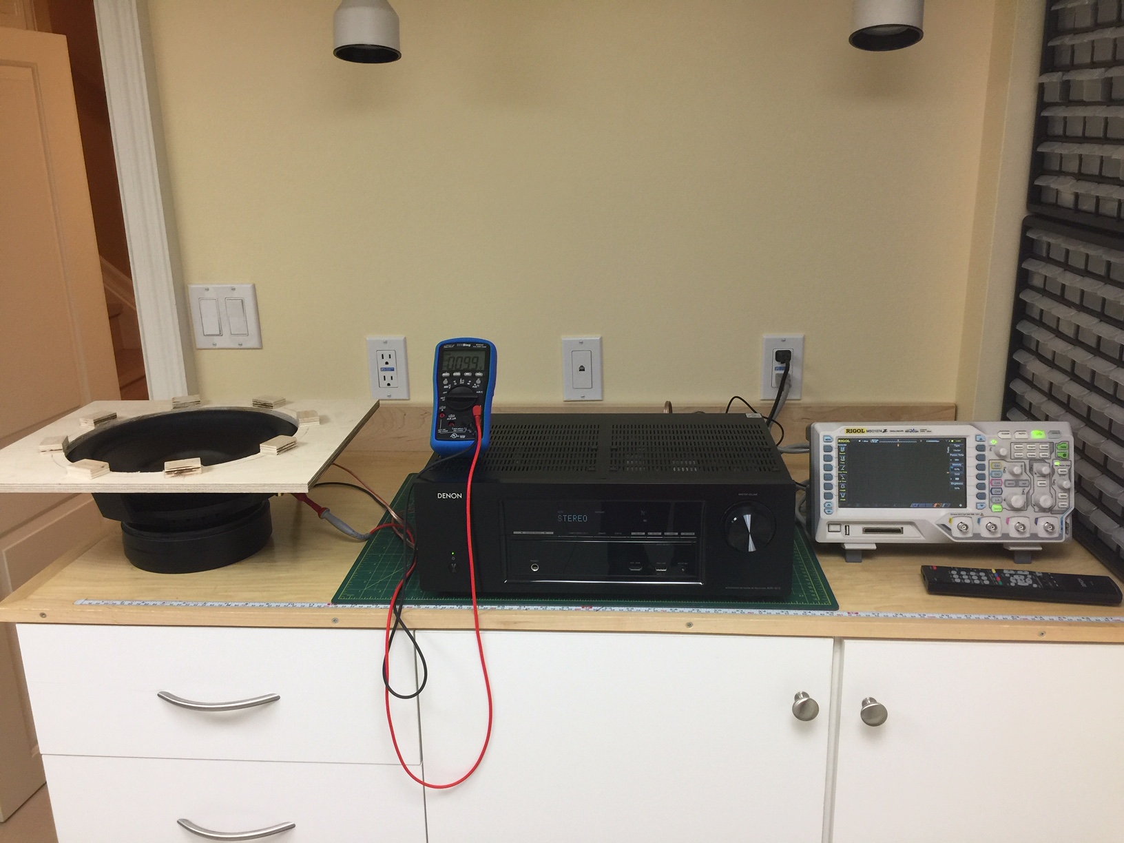

I mounted the woofer in the new baffle (panel 6) and tested it. I wasn't sure if there was sufficient clearance, so I followed Bill's suggestion and unmounted the woofer, put chalk dust on the baffle cut out, and then re-mounted and tested the woofer again.
To my relief, there was no sign of chalk dust on the woofer so that there must be adequate clearance.
I removed the woofer once again and took the baffle out to the garage to install in the THTLP. First, I installed the brace. I measured where on the baffle the brace would need to be mounted, and tested the positioning of the baffle and brace with respect to panel 2. Once I was happy with the fit, I fastened the cross brace (with PL Premium and brads) to the baffle. I was then able to attach the baffle assembly (i.e., panel 6 and the brace) without any difficulty.

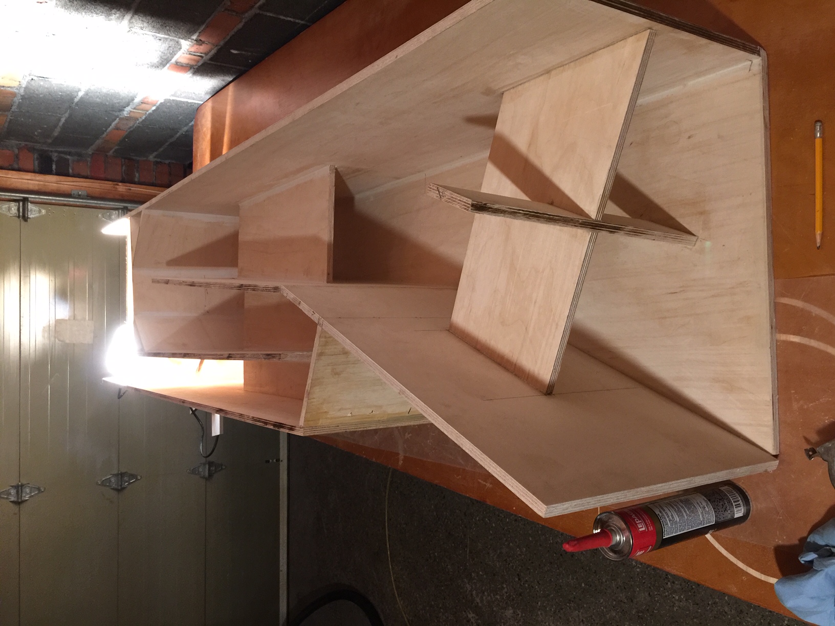

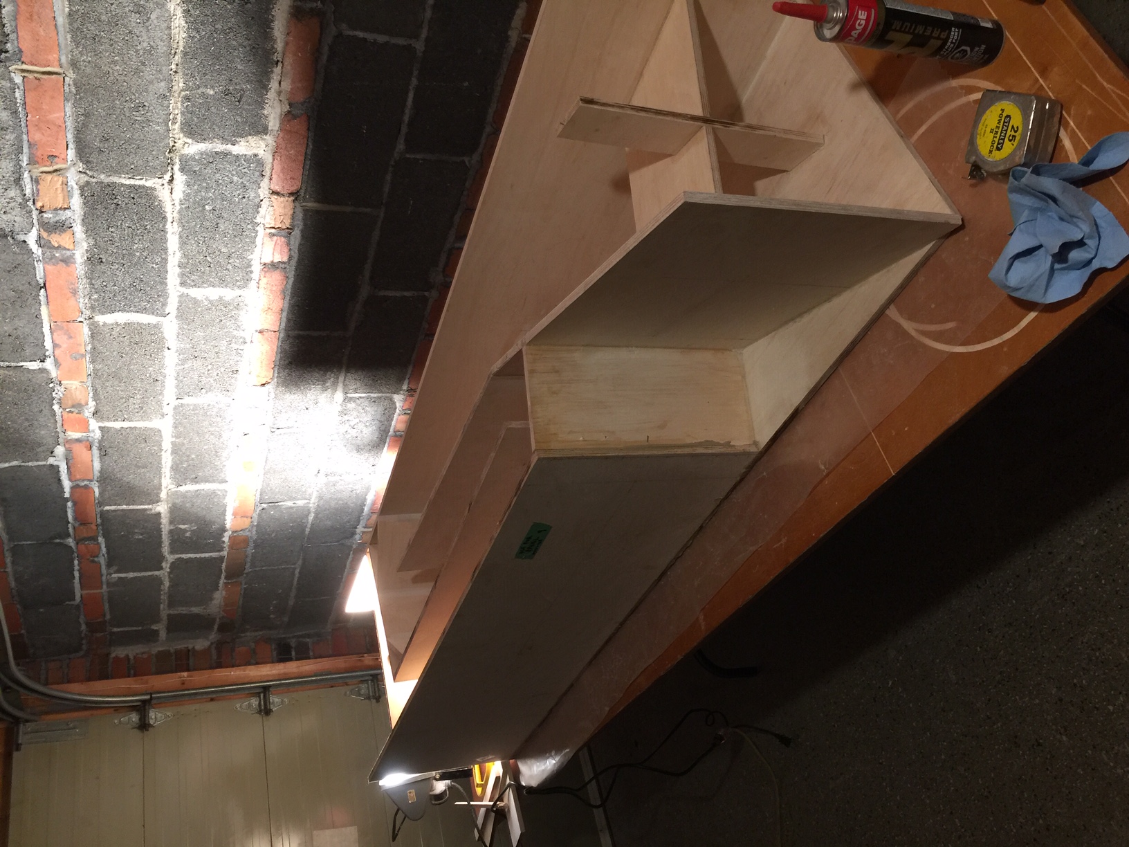

Today the weather warmed enough to do some more work on my THTLP project.
As usual, I started by scraping the PL Premium squeeze-out from my last glue-up and then caulking the joints.
I then cut all of the remaining pieces for the THTLP:
  • 4 x cover flanges
  • 8 x driver chamber braces
  • 1 x chamber cover (left oversized to be trimmed when installed)
  • 2 x cover braces
I was able to cut all of the parts for the THTLP (including one panel that I had to remake) from just two 4'x8' sheets of plywood. I still have about a 2'x2' piece of plywood left over.
Since I'm building the smallest-sized THTLP (only 15" wide), I have a couple of challenges to sort out:
  1. if I install the driver chamber braces as indicated in the plans, it won't be possible to install the woofer. To remedy that, I plan to install half of the braces as per the plans (wide part at the baffle and narrow part at the rim), and the other half the other way round. I picked up that idea from searching on this forum.
  2. I'm not sure if there'll be room for two cover braces or just one. I'll know when I get to that stage.
I also installed the last panel (panel 9). It took a little effort get get everything to line up and to straighten out some warping, but I think it turned out OK.
Here are some photos of the current state of my build:

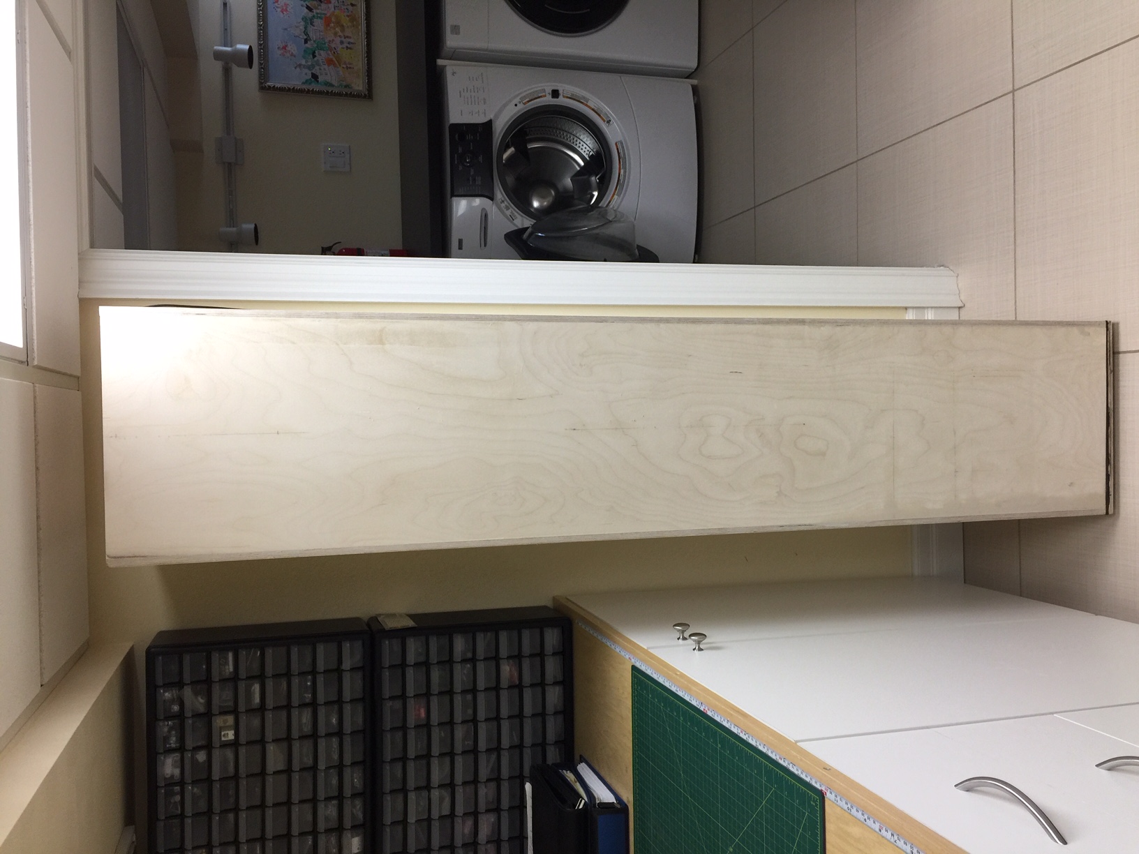

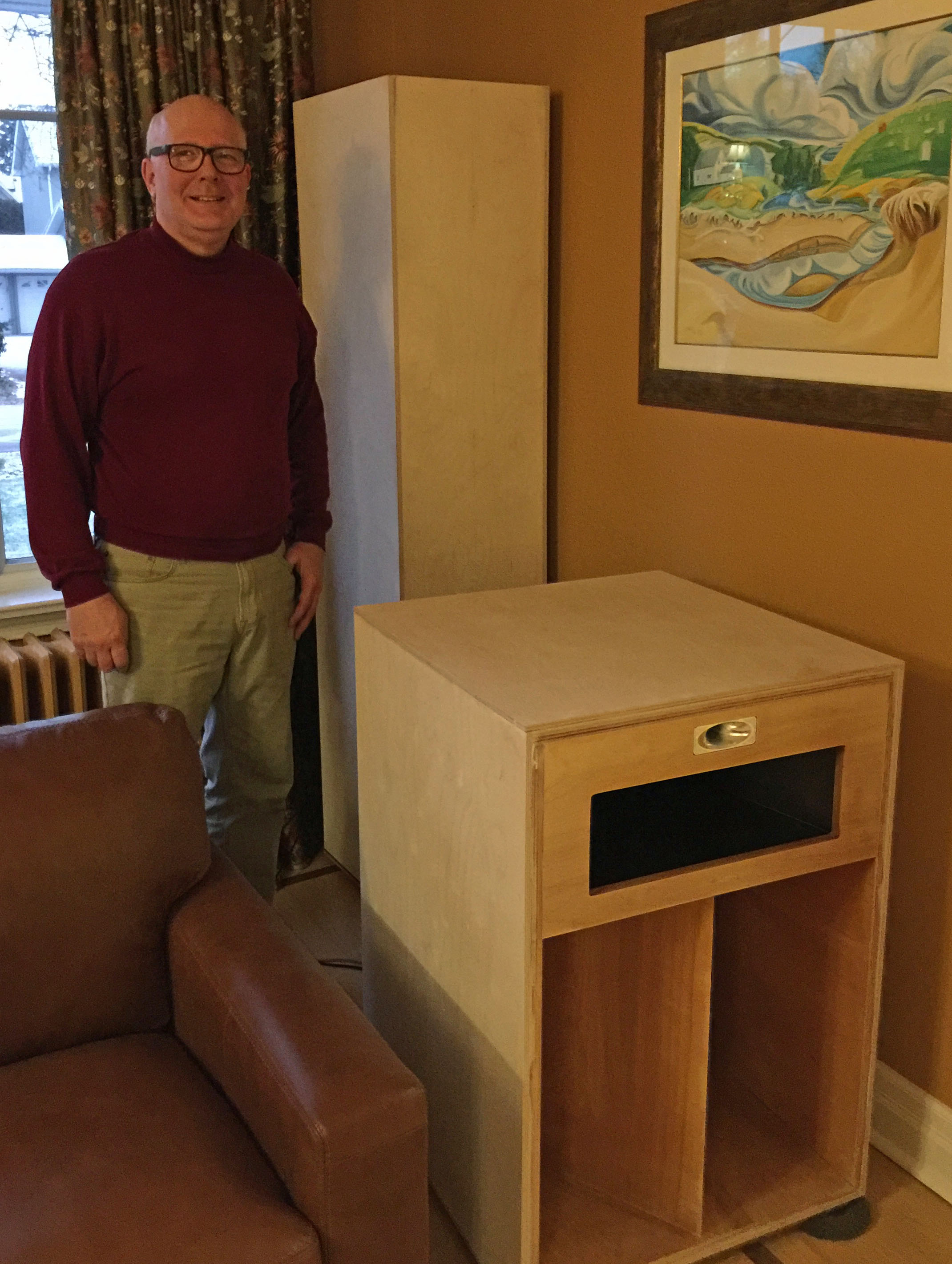

2022 is looking better already. Yesterday I completed my THTLP build.
All I need now is the plate amplifier for it (on back-order but expected to arrive by the end of the month).
Right now the THTLP is in my basement workroom (much better than my unheated garage). I'm eager to move it up to my living room and connect it to my sound system to hear how it sounds.
The plate amplifier (a Dayton SPA250DSP) has a built-in DSP, so there'll be lots of opportunity to "tune" the THTLP.

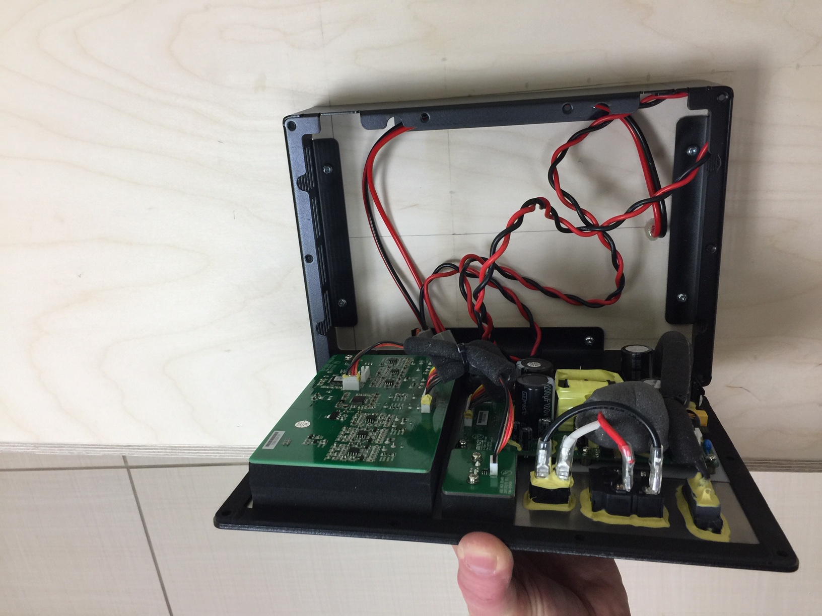

The Dayton Audio SPA250DSP plate amp that I've been waiting for was delivered today.
I was keen to try this amp because of its DSP capability. I'm hopeful that the DSP will allow me to "tune" the THTLP to address some of the peculiarities/deficiencies of my room and my speaker placement.
The amp comes with a power cord and a USB cable so that the DSP can be programmed from a PC (only a Windows version of the GUI is available).
I had purchased an enclosure for the plate amp so that I could mount it on my THTLP. Both the plate amp and the enclosure had gaskets pre-installed so that all that's needed is to measure where to put it and screw it in. I used 1/2" #8 screws to mount the enclosure to the THTLP.
The enclosure didn't provide a lot of space, but I didn't have any trouble wiring it up.
I used Jago lever nut connectors https://www.amazon.ca/Lever-Nut-Connect ... B07871V4L8to mount the speaker wire to the amp.
Here's how the THTLP looks with the SPA250DSP installed:
