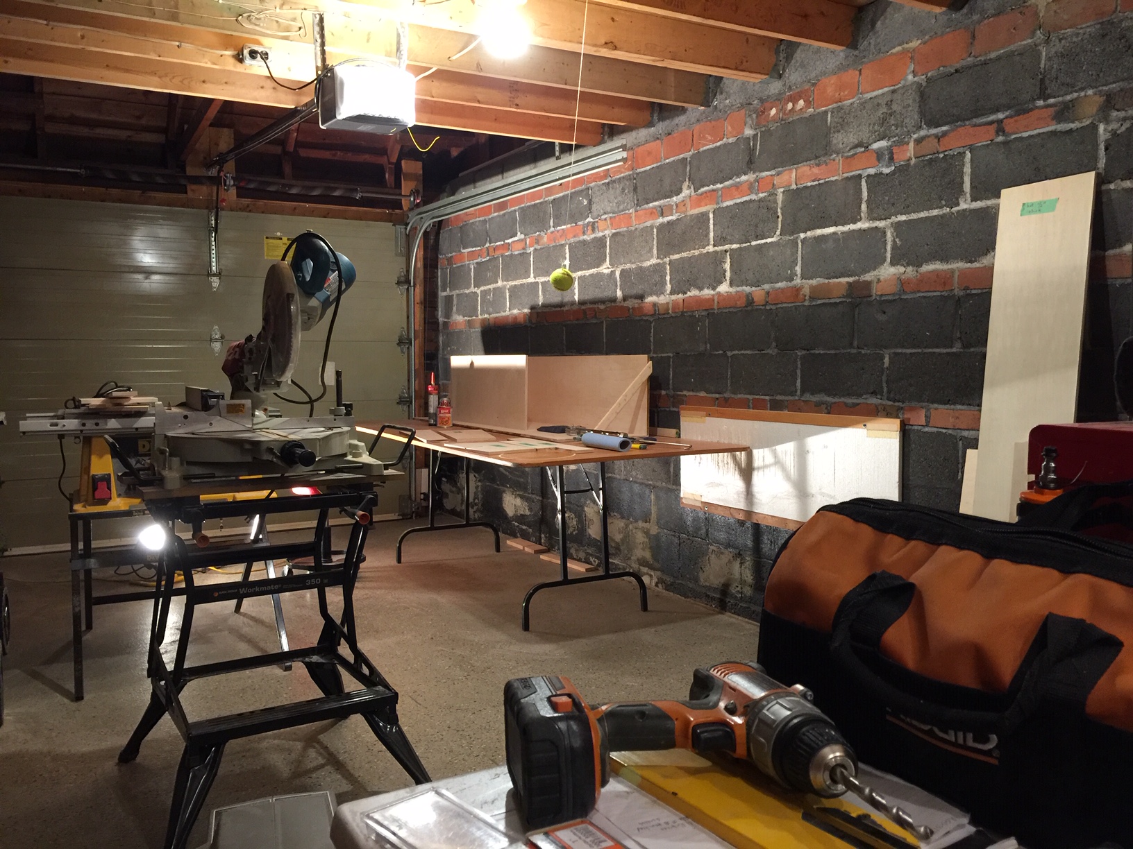

I am planning to build two powered THTLPs. Each THTLP will be built with a Dayton RSS315 HF-4 12" woofer and a Dayton SPA250DSP plate amplifier. I have the woofers, but the amps are on backorder and won't arrive until the new year.
I'm building the first one now; the second one may have to wait until spring when the weather warms up. The builds rely on PL Premium construction adhesive which is only rated for use in temperatures above -7 degrees C (19 degrees F). Because I live in Canada and work in an unheated garage, I'm racing to finish the first build before the temperature gets too cold.
Also, my wife wants my tools out and her car back in the garage before the snow comes!

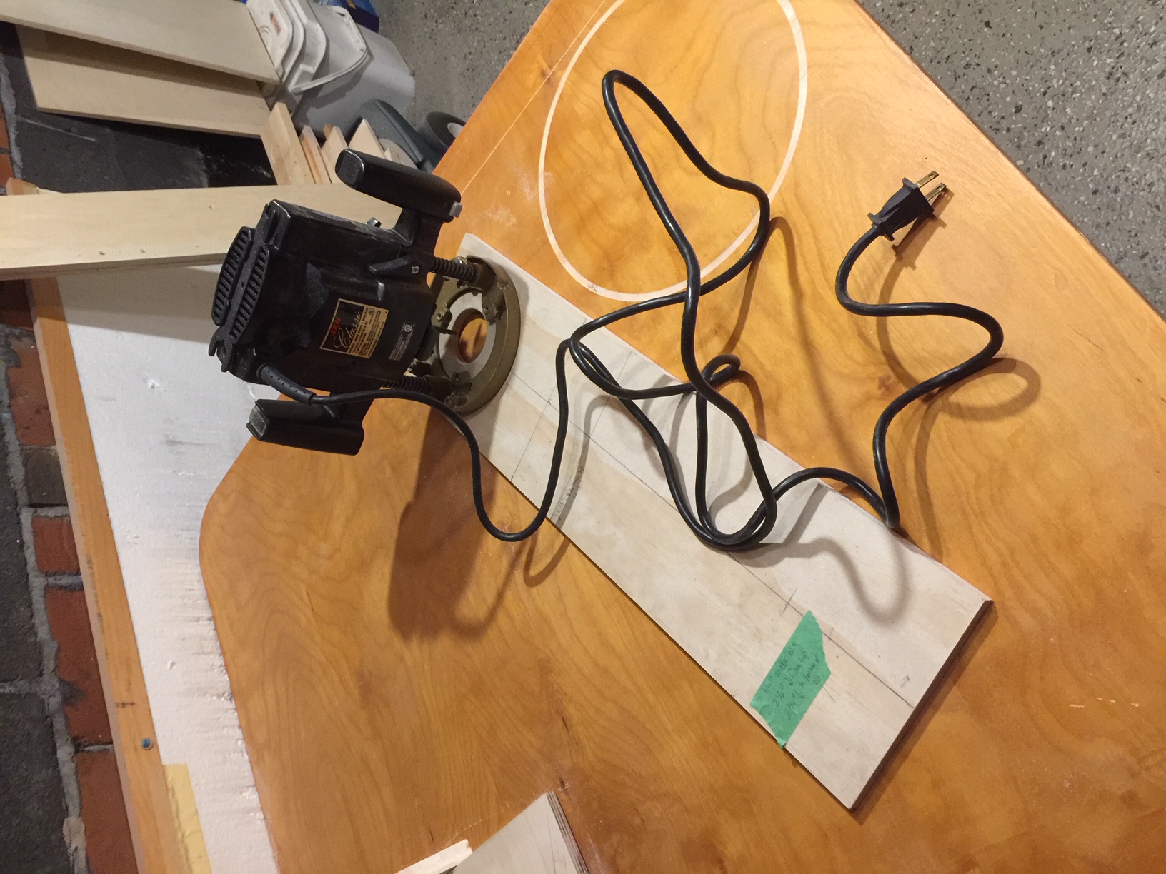

2) I used scrap lumber that I had laying around to build a number of jigs from the plans that Bill makes available. They've been invaluable. If asked, I would recommend making more of the panel jigs and circular saw sleds so that some could be dedicated to the different angle cuts that must be made.
Bill's didn't provide plans for a circle cutting jig, but I built one based on some I'd seen on YouTube.

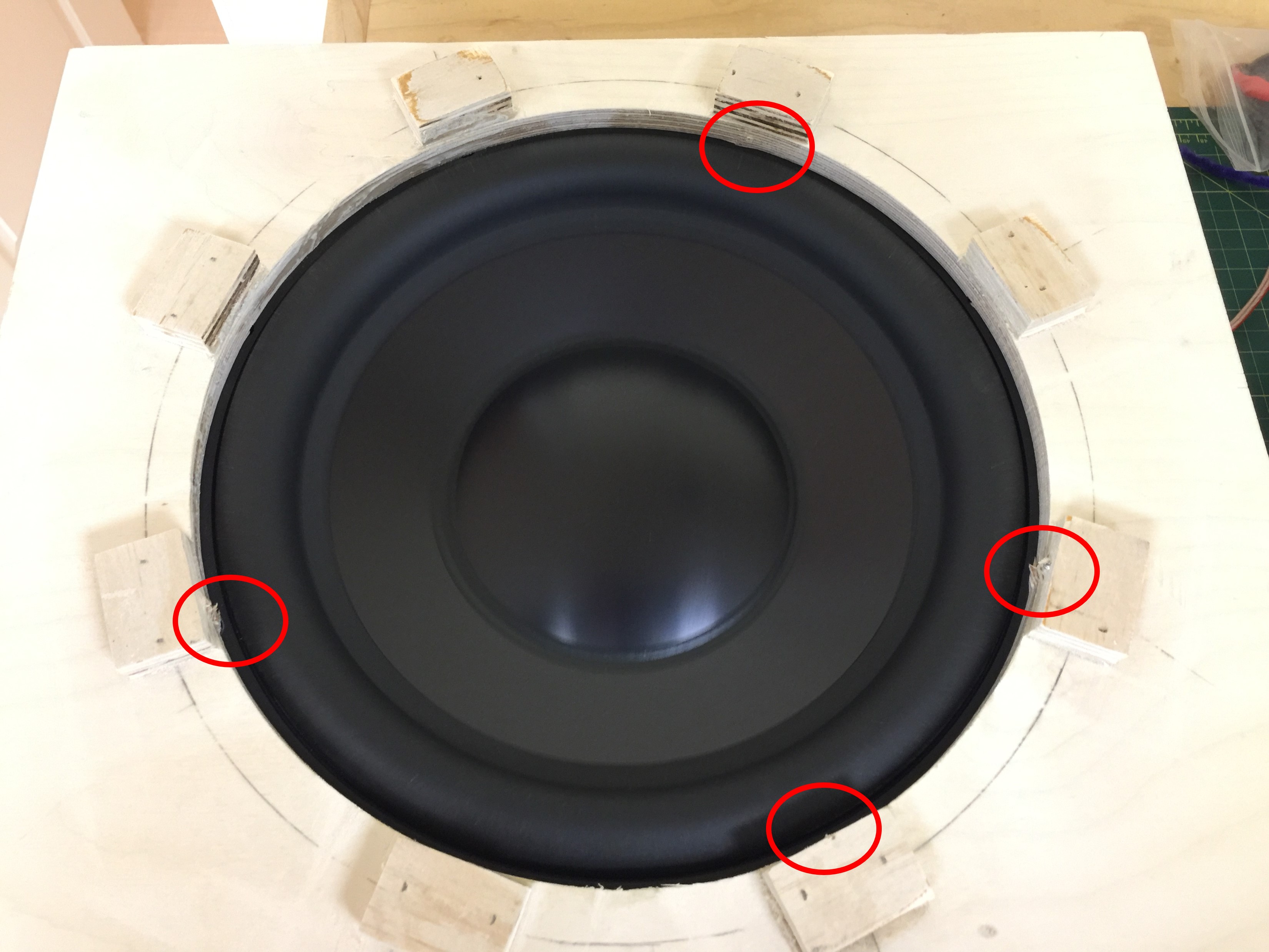

I hoped that the mounting blocks would be sufficient to hold the screws and salvage the panel, but I was concerned that there was insufficient support for mounting the woofer.

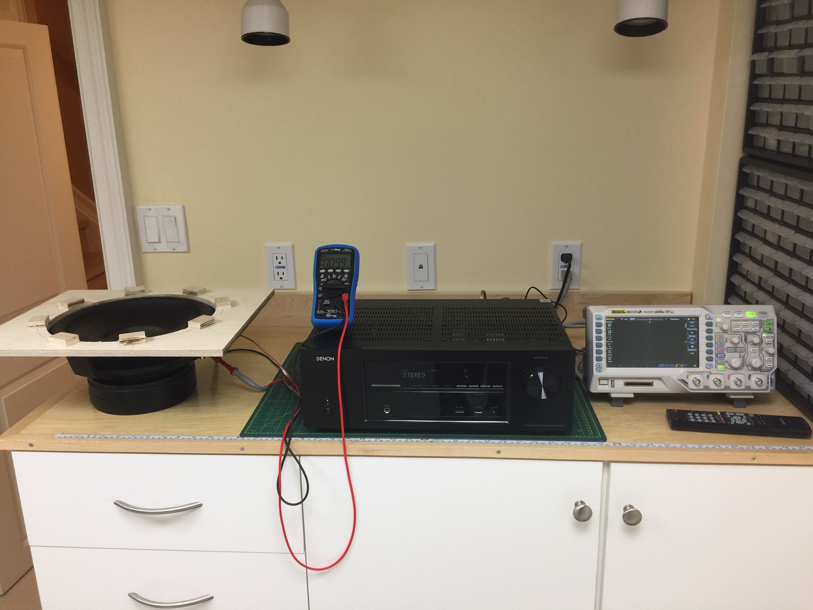

7) While i was sorting out what to do about panel 6, I ran a test on the woofer (in the soon-to-be replaced panel 6) to ensure that there wasn't any interference between the woofer and panel 6. After that I ran the woofer for 12 hours for burn-in. Here's my setup:
I'm using a signal generator to send a 1 Vpp 30 Hz sine wave to an AV amp via a BNC-to-RCA cable. The amp is connected to the woofer with speaker wire. I stripped enough insulation off the speaker wire so that I could connect my DMM. I turned up the volume on the amp until the DMM showed 10Vpp (RMS) at the woofer. I let that run for 12 hours.

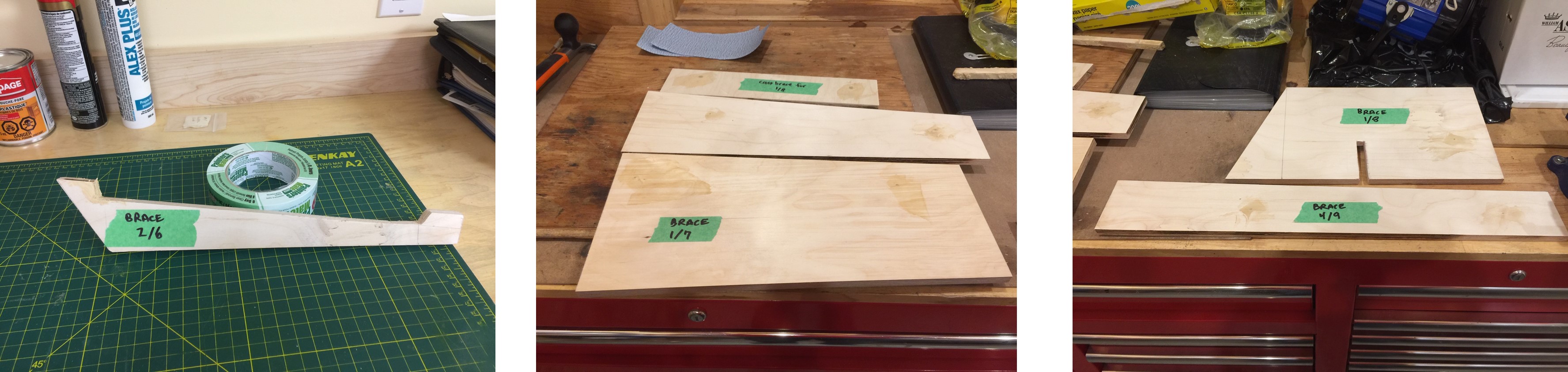

Because my THTLP will only be 15" wide, I only needed one of each brace. I made them all at once.

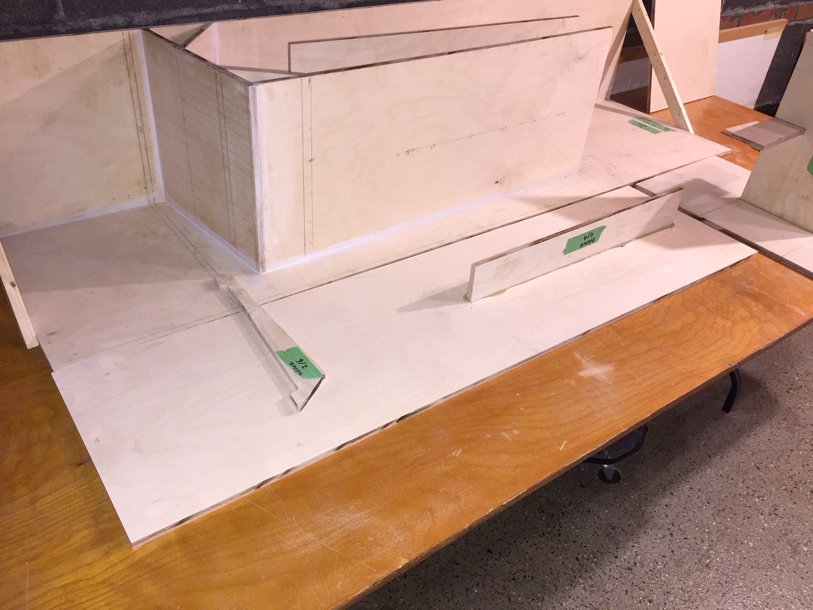

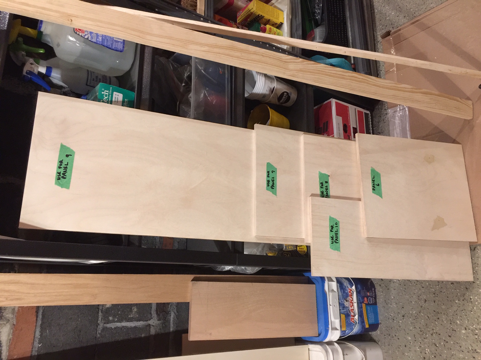

I also rough cut the remaining panels (panels 6-10).
I'll cut them to their final dimensions as I go about installing them .

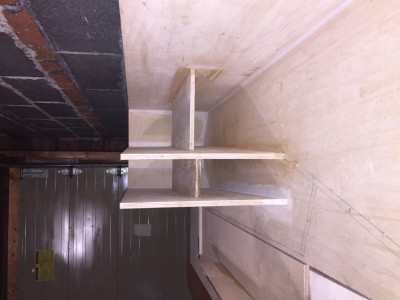

I figure that I'm about 1/3 of the way through the build. There's not much to see at this point; the photo shows the THTLP with one side and panels 1-5 installed:

Wow Dave! Great writeup :thumbsup: And good for you, taking it on yourself!
I find that when I'm building my cabs, I get in different moods. Sometimes it's a meticulous perfectionist mood. And sometimes it's a F#*@ it, let's just get it done, mood.
I really can't say which direction I'd take with the baffle if it were me. It would depend on my mood. But, re-doing the baffle IS absolutely the right thing to do.
Yes, there's concern for the holding power of the screws, but there's also the added potential for leaks through the screw holes in the driver flange being uncovered, even on locations that didn't breakout. Could they be reliably sealed up? Maybe. Quite possibly, even. But, the right thing to do is remake the part. I commend you on that choice.
When you don't have to put the basket in the cutout (like your situation), you can intentionally size and make the hole a bit smaller (say 1/16" radius,1/8" diameter smaller hole than the driver gasket ID) to give you a little more meat there for the screws, then sand down and soften the edge on the driver side of the baffle to give you clearance for the surround if needed.

I used my garage as my shop for three years, ended up building a shed workshop in the back yard when the garage wasn't big enough anymore.

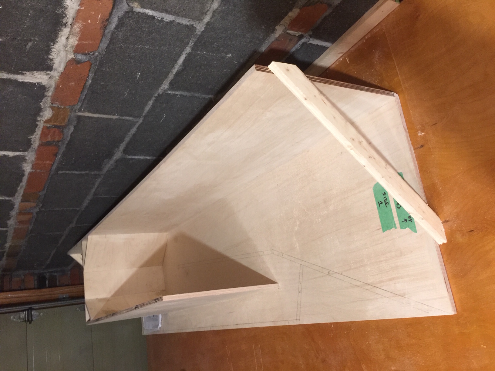

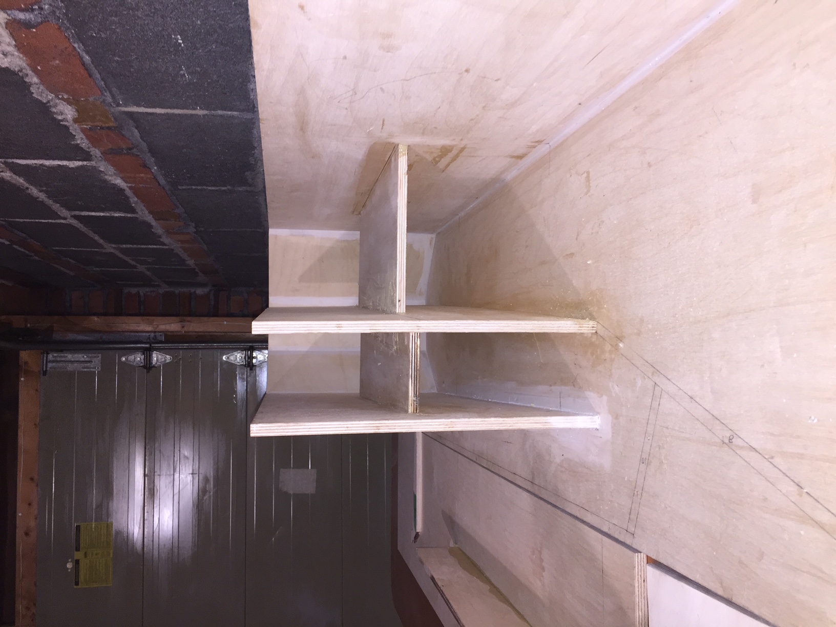

I started by cutting panels 7 and 8, which were a bit tricky since they need to be cut at a 9 degree angle, and because they are a bit large for my table saw. But that went smoothly. Since I had already cut the braces, I moved on to install panel 7.
It should have been simple. But it wasn't.
The instructions said only "Cut and install panel 7 and the 1/7 and 7/4 braces". I installed the panel easily enough but installing the braces was a mess. I tried running a bead of PL Premium on them and sliding them in place. All that did was make a sticky mess all over. I couldn't get the braces in the right position, let alone level. Getting one brace in place would throw off the other.
It was obvious that I wasn't going to be successful with that approach, so I took out the braces and panel 7 and cleaned off all of the PL Premium. It took a scraper, some Varsol, and a lot of shop towels, but I was able to get both the panel and the braces clean.
I decided to try attaching the braces to the panel ahead of time, and then installing that assembly as a unit. That worked OK for panel 7.
With that success behind me, I fastened the brace (and cross-brace) to panel 8
I wanted to let the adhesive dry on panel 7 before trying to attach panel 8 to it, so I'll install the panel 8 assembly tomorrow.

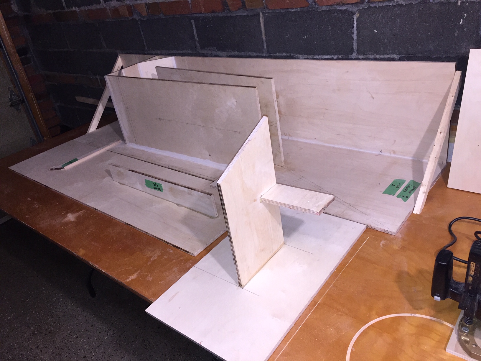

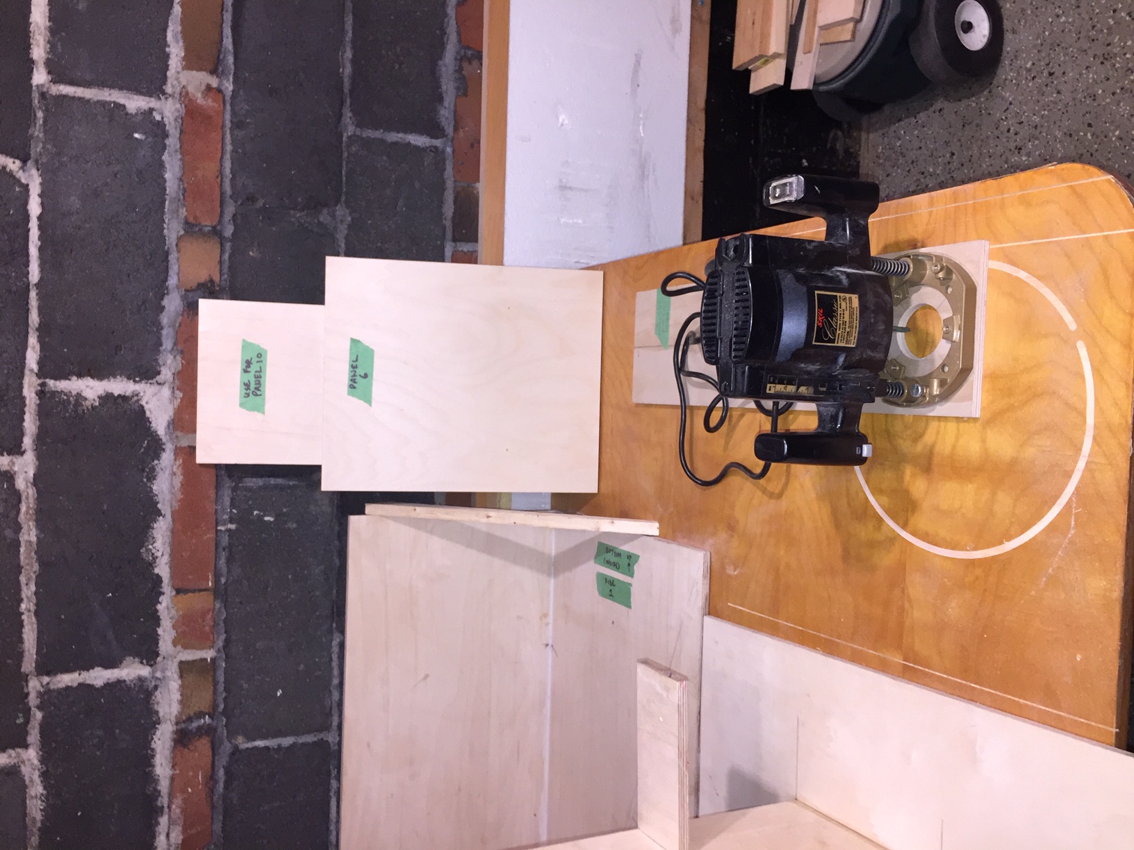

Although I've cut panel 6 to size, I haven't yet routed out the hole for the woofer. I'll try again with my router and the circle cutting jig I made for it.
Wish me luck!

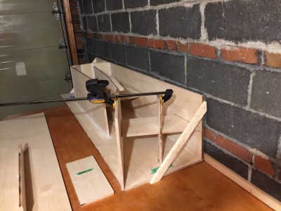

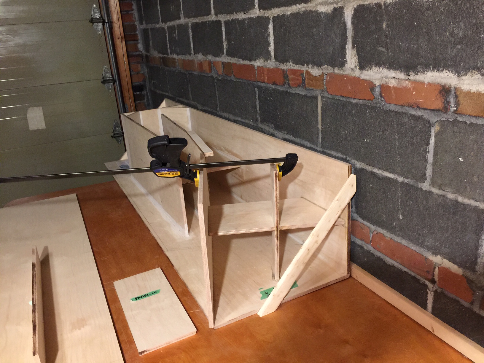

I made good progress on my THTLP build today.
1) I cleaned up all the squeeze-out on panel 7, and applied caulking to all joints --- just in case --- so that everything will be air tight.
2) I installed panel 8 and its brace and cross brace.
  • Panel 8 was a bit warped so that the joint between panels 7 and 8 didn't line up perfectly. I was able to force a reasonable fit using a temporary brace to pull the two panels together.
  • The cross brace wanted to warp so I put a clamp on it to pull it back to square.

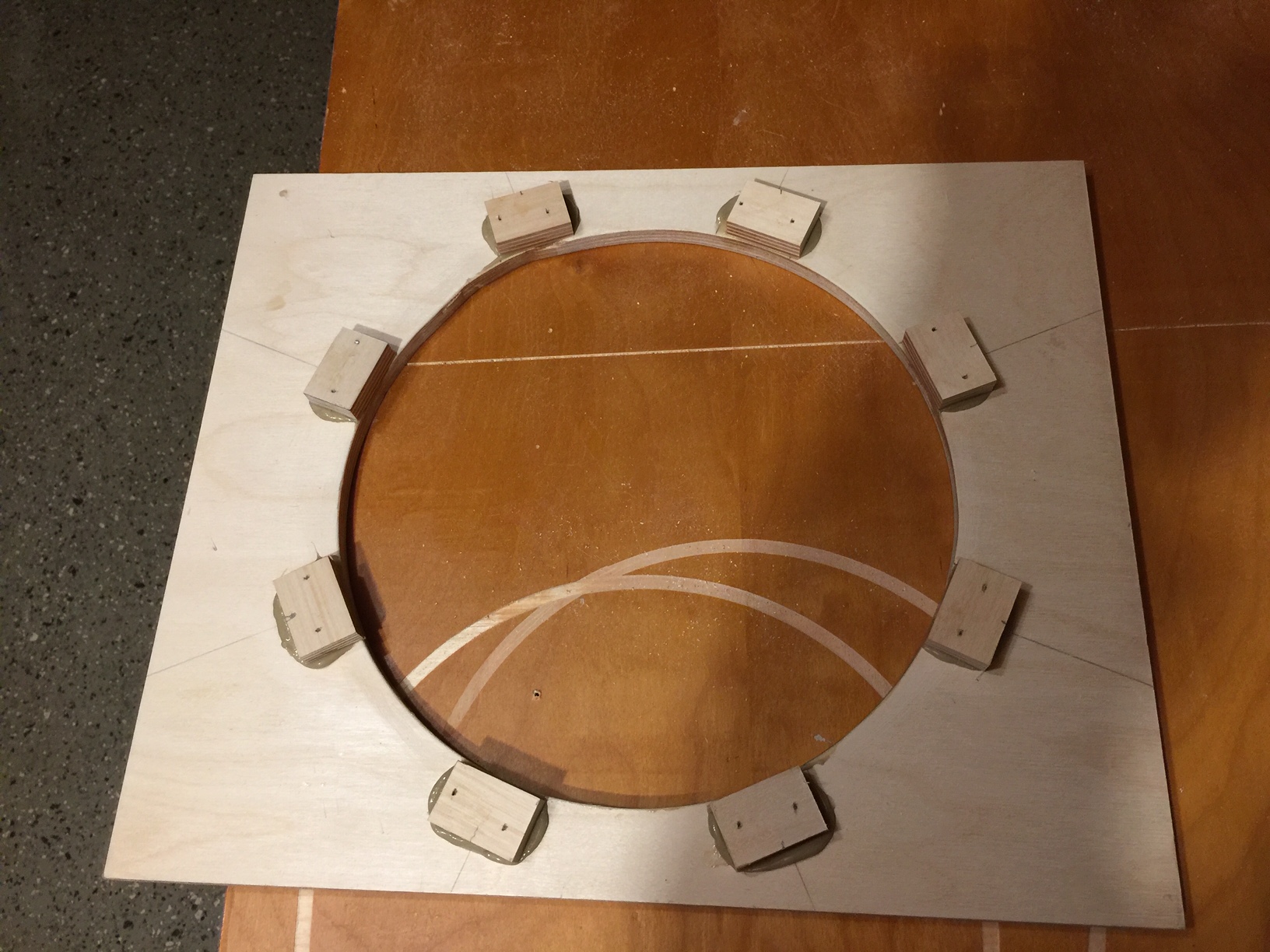

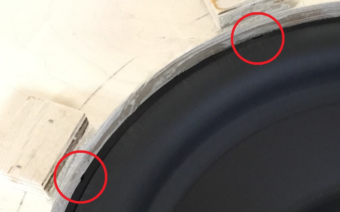

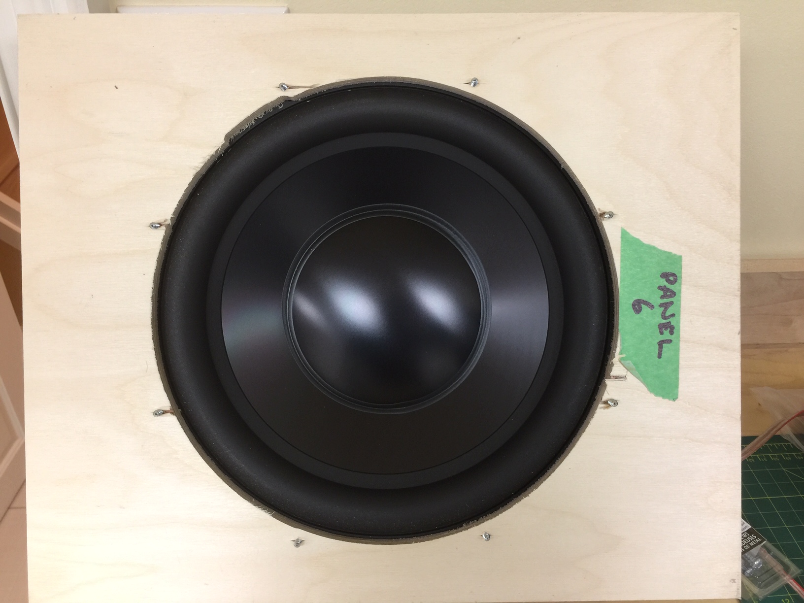

3) I cut another baffle for the woofer (panel 6). This one should be OK.
  • I changed the radius I was using on my circle cutting jig by a tiny, tiny amount --- likely less than the diameter of the finishing nail I was using as a pivot. That resulted in a slightly smaller circle which meant a closer fit to the woofer and more room for the screws.
  • I used #8 screws to mount the woofer to the baffle instead of the #10 screws I used the last time. I think that the tolerances are so tight that using the smaller diameter screws made a great deal of difference.

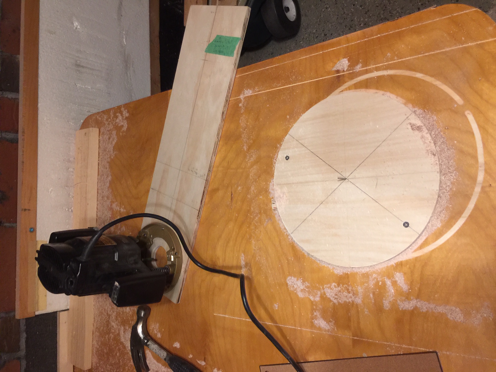

The cut-out isn't perfect, there is a small section that is gouged in. That happened because, when I fastened panel to my work surface, before attaching the circle cutting jig, I only fastened it inside the circle to be cut out. I should have fastened it there and in the area that will form the baffle (i.e., outside the circle) too. Because I didn't, when I took my last pass with the router, the circle was cut free and the rest of the panel moved into the router bit. Fortunately, that mistake seems to be of no consequence.
My home-made circle-cutting jig worked, but was a pain to use: it was hard to mount it on the pivot point (a finishing nail drive into panel 6) and it was hard to make tiny adjustments. I've ordered a commercial circle cutting jig. Although it'll be too late to use on this project, I'll have it when the time comes to build my second THTLP.
4) I added the speaker retention blocks to the new baffle.
