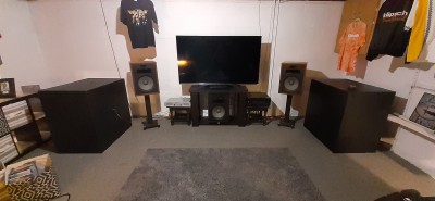

Last weekend I purchased two THTs that were built by member Rowan611. I demoed them at his house (actually we listened to the four that he has).
Absolutely nuts! I've had 5 different SVS subs, Outlaw Audio, Hsu and also four 15" Peavey Black Widow THX pro subs. The THTs are in another dimension. I'm still working on dialing them in but so far so good. I'm using a Crown X1000 pro amp to power them. The rest of my setup is Klipsch.
Anyway, just wanted to join and say hi!

Is there a link or area that discusses proper placement? When I demoed the THTs at Rowan611's place he said they should be 18-20" from the wall behind them, mouth facing the wall behind them. He also said to place them firing straight into the wall, not angled.
They sound amazing where I have them placed but I have to admit I haven't tried moving them around at all to experiment.

I figured someone would have posted some direction for you by now... I'm not into Home Theater Audio at all. But from what I've read around here, more times than not, placing the subs in opposite corners (side of the cab against one wall, mouth firing into the corner about 18" from the other wall) provides the most even sound throughout the room. And the only way to tell is to experiment.
There's also "the sub crawl", where you place the sub at your primary listening position, play a low frequency sinewave, and crawl around the perimeter of the room, listening for (or measure with an SPL meter) places where the the sound is loudest. Theory is, if you place the subs in those "hot" locations, the sound will bounce around the room in reverse of the test and you'll get the best performance in your primary listening position.
But really, if they sound amazing in their current location and you're happy, there's no need to fiddle unless you're just the type of guy that's inclined to experiment with stuff.
There is a thread on sub placement and there's good information in it, but it's aimed more at pro sound applications.
Rules for Subwoofer placement and stacking
