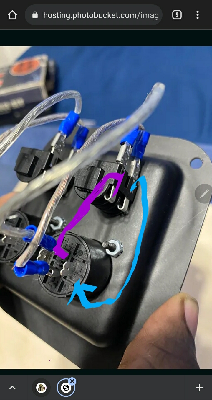

Decided I will start some pre-wiring, but I will need you guys help. I am familiar with wiring the basic speakon cable, but have never tried to
wire a combo jack. Can someone tell me if this is the proper way to wire these type of jacks. This is the D01K Jack Plate Kit
2 Speakon 2 1/4" from speakerhardware. I searched online and found a descriptive comment from a person who says they wired there speakers
in a specific way. This is what he wrote:
"When we use these jacks in our speakers we connect all of the positives (tips and +1) together. Then we connect all the negatives (sleeves, and +2) together.
This makes the jack plate "fully parallel." Then we connect the positive from the speaker to one of the positive terminals and the negative to a negative.
This means all the jacks work as an input or an output to add another speaker in parallel."
So do I have this right or is this wrong? Here is a pic.

Close.
You want to use the +/- pair of #1 or #2 on the speakon jacks.
Usually the default is 1+/1-
On the 1/4" jack the "tip" should be + and the "sleeve" should be -

Bill I bought the combination dual 1/4" + dual speakon jack plate. Not all my audio interfaces use speakon connections. I wanted
the option to use one or the other. I could just wire up the speakons, but I have more 1/4" cabling than I have speakon. Kevin I
appreciate the diagram. I kinda knew something was off when I was only left with -1 and -2 connections.

Other than what's been mentioned, one minor issue I found with those 1/4" jacks is that they're not air tight. I can't imagine it being a huge deal breaker. But, just the same... If it were me, I'd choose SpeakOn's and make a 1/4" to Speakon pigtail adapter to use with 1/4" only gear.
Neutrik also makes a SpeakOn/1/4" combo jack. But, IIRC, it's only compatible with 2 pole SpeakOn plugs.
Corrected quote...
"When we use these jacks in our speakers we connect all of the positives (tips and +1) together. Then we connect all the negatives (sleeves, and -1) together..."

Thanks Seth. I did wonder about the air tightness of the 1/4" section. The manufacture included in the kit a set
of black pluggers that insert into the open jacks when not in use. Not sure of the effectiveness yet, though. Appreciate
the correction on the quote. It makes more sense now.
