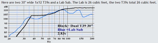

Seth wrote: Mon Sep 13, 2021 12:41 pm
Bruce Weldy wrote: Mon Sep 13, 2021 12:36 pm
Seth wrote: Mon Sep 13, 2021 11:35 am
I don't think so (scratching my head though). If anything, using that trace and subtracting 6dB could be slightly generous in the lower end, making the LAB12 look a little better than a true 1 cab response chart. It seems to be completely reasonable method to identify a single cabs response, given the lack of a chart for a single cab... to me anyway.
Are you seeing something I'm not. It's completely possible I'm overlooking something (again LOL).
I think you missed his point......the black line on the graph is for a BFM speaker. The blue
line is for a Danley Lab sub - not a BFM speaker with a Lab12 in it.
The black line is what I used. The blue line is (obviously) of no use to the conversation. Or, at least I thought is was obvious. I should have been more specific. My mistake.
Here it is within the context of where I pulled it from
Two 30" LAB12 loaded T39's...
Subtract 6dB to identify the values for a single cab. No?
Wait... Aw Shit! It doesn't state that the T39's are LAB loaded... Crap.
You're guys are right again. Another oversite on my part.
Bill, what driver is in the cab in this comparison?

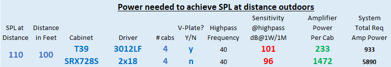

This spreadsheet calculation illustrates 4 v-plated 30" T39's (3012LF loaded) compared to 2 JBL SRX728S. It indicates that the T39's will meet the required output all the way down to 40HZ and the JBL SRX728S's will not.

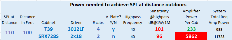

And someone might be interested in knowing the required power to reach their goals, especially if they are limited to a single mains power supply circuit. If they were considering the JBL as an option, it would take 4 cabs to get the required power under the RMS power rating at 1472 watts per cab to meet the same SPL/distance requirements... 5890 watts total. I'm not entirely certain a single circuit would handle that without popping the breaker. While the 4x T39 option requires less than 1000w and still has about 2dB headroom before the limiter ( I think more is ideal. But, just for the sake of illustration) and the JBL is just about at it's RMS rating with only 0.4dB to spare.
That's eight 18" drivers on nearly 6000 watts to match the output of four 12" drivers on less than 1000... further demonstrating the "power" of cab sensitivity.
And, yes... this calculation does not take into account the effects of power compression. But, I'd venture a guess that the T39's at about half their RMS rating would suffer less than the JBL's essentially at their RMS rating. Just a hunch though. :)

Seth wrote: Mon Sep 13, 2021 12:48 pm
Bill, what driver is in the cab in this comparison?[/size][/b]
Because these were done years ago, I would assume the graph is of 3012LF cabs as the Labs weren't an option then.

Bruce Weldy wrote: Mon Sep 13, 2021 2:57 pm
The LAB's had to at least be an option on the market when that specific graph was made. Otherwise, the LAB Sub wouldn't exist to compare to. Maybe before it was an option in the T39 plans perhaps.
Still curious what driver it is. It doesn't resemble the other 3012LF T39 traces. The closest thing seems to be an S2012. I'm going to hold my breath until I get a confirmation! LOL

The LAB 12 was only added to the T39 and other plans as an option when neo prices went through the roof and for a time it was cheaper than the 3012LF. The LAB Sub design went back at least ten years before that.

Bill Fitzmaurice wrote: Mon Sep 13, 2021 4:59 pm The LAB 12 was only added to the T39 and other plans as an option when neo prices went through the roof and for a time it was cheaper than the 3012LF. The LAB Sub design went back at least ten years before that.
Good to know :thumbsup:
So, which driver is loaded in the T39's for this trace?
