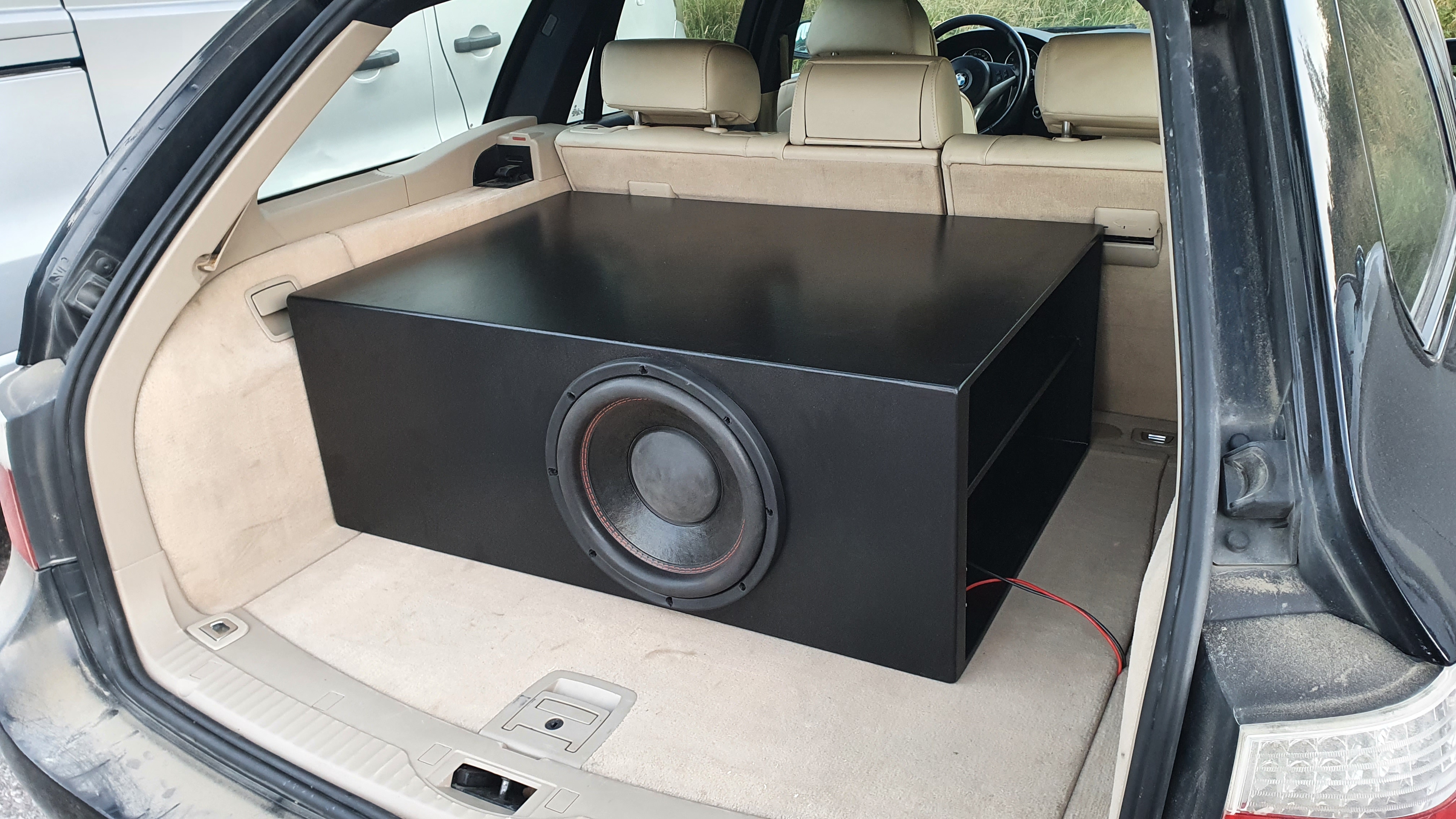

I am really enjoying my 20" wide GZTW loaded AT, but now im looking for even more bass.
Its in my BMW E61, amp is Massive Audio N2.
I actually did a 14" wide TRT and loaded it with a 12" driver that i had extra, it had good specs and its sounds OK, a real beast below 60hz but does not have the same type of lovely punch, sound and transient response as my AT, but in SPL it outperforms the AT with the same power between 15-50hz.
(Sorry that i broke the plans hehe, i didnt expect it to perform but it did and was a fun build, and a friend of mine borrows it and he is in love with it, he cant stop telling me how good it sounds)
I did try this same 12" driver in a sealed and in a recommended ported box in my car and i would say its useless that way, sounds so bad i wouldnt even use it if i got payed!
The slim GZTW 10F got updated this year and now it has a QTS thats way off, so now i wont be able to do a 2x10 AT with the GZs :( the LS10 and alot of other 10" drivers would fit great but they have lower VD.
(The GZTW have seen some serious abuse and does not bottom out with 23v at 1ohm, and i measure with music around 125-126dBc where my head is, and up to 129dBc 44hz at the windshield) it is still healthy.

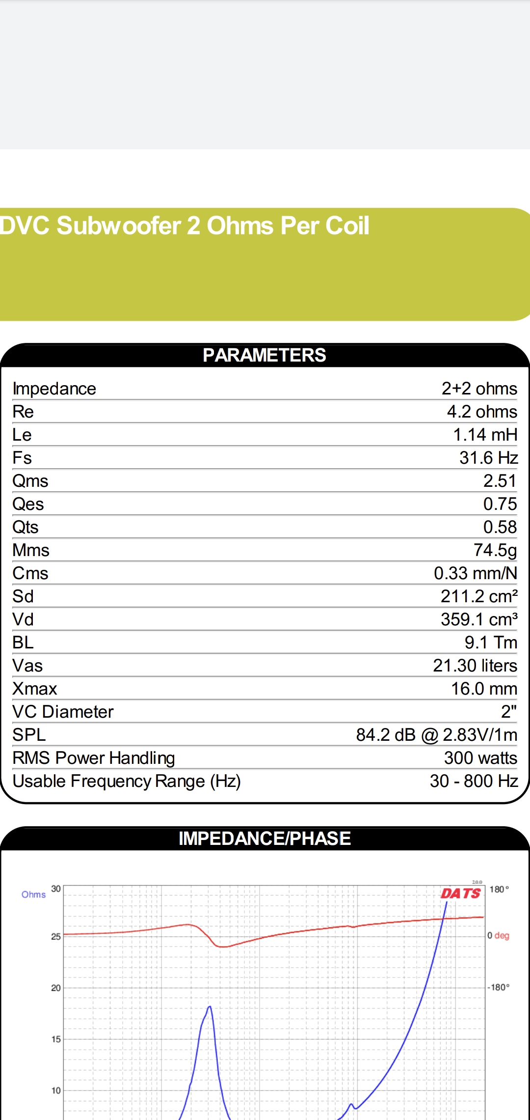

Im wondering if the Dayton Ultimax 8 would be a good choice for a quad loaded 44" wide TAT? (Maybe build two dual 22" wide)
The UM8-22 does not perfectly fit the required specs thats in the plans, but will it do any good? The VD is great!
Can i reduce the driver chamber to make it work better in some way? How will the sound be with the specs that are somewhat off? Does the specs make it fit better with say a very slim cab or a wide cab?
Its specs are with the coils in series, it will be in paralell and then series to make a total of 1ohm with 4 drivers.
Will the paralell-series-paralell wiring do anything better with the QTS?
The more use the driver will see, the lower the QTS will be, Dayton does not write how they broke in the driver, or for how long. What could i expect?
Wow thats alot of questions and im sorry if its hard to understand me :lol:
The specs is in the picture attached

Qes is far too high. It's a driver made for a sealed box, not a horn.

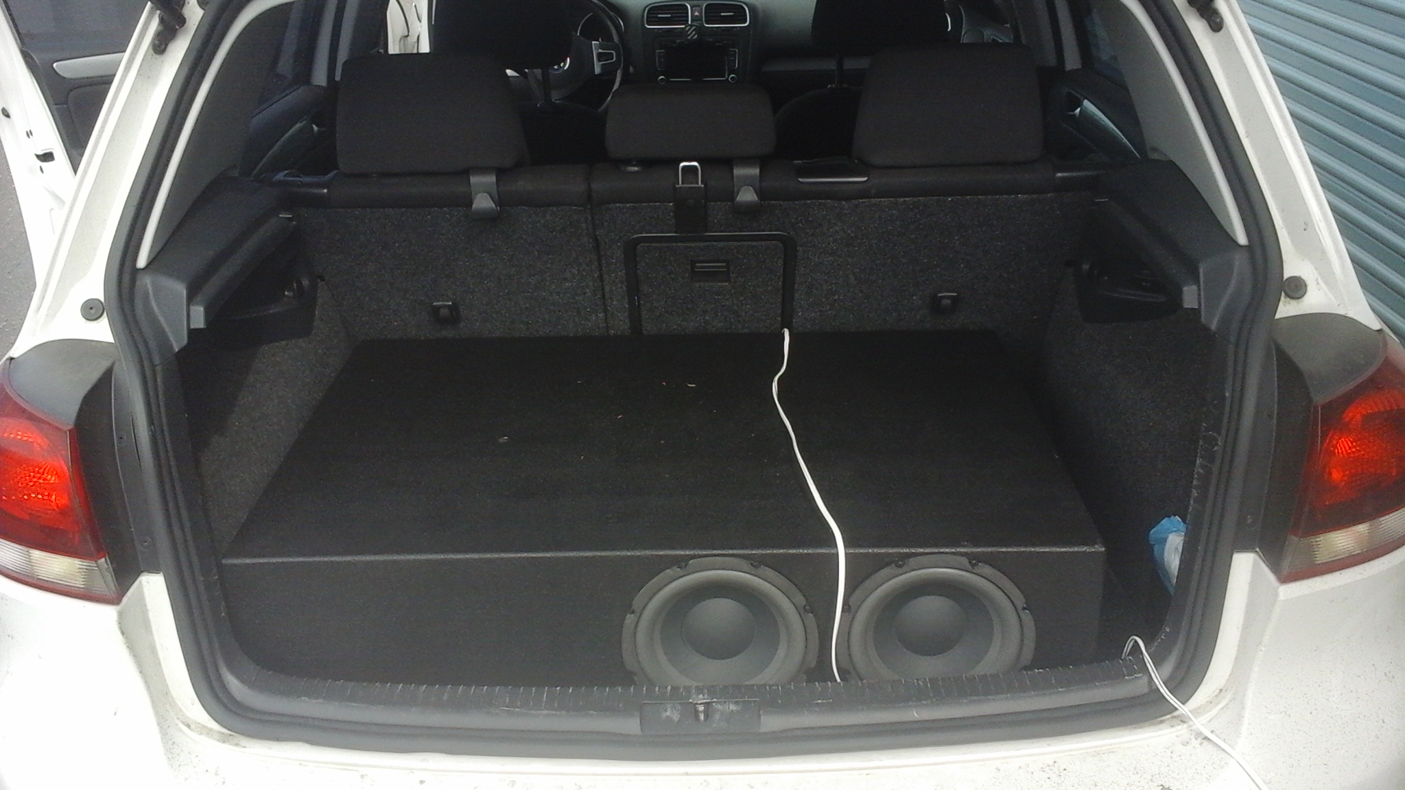

Line92 wrote: Fri Sep 17, 2021 9:20 am ...Off the record: i personally would love to see a horn designed by you, suitable for car audio with a tilted back end so it will fit most station wagons like mine better, there is almost 6" of room between the box and backseat at the lowest point, would be cool with a slightly bigger/longer AT formed that way with even longer throat to load even lower 8)
If you lay it down flat, you can modify the panel 9 side of a Truck Tuba to accommodate the contour of the back seat angle. After mocking up and measuring how much space would exist at the bottom, remove half of that number from the top and add the other half to the bottom's dimension to maintain the internal volume of the horn section. Put the drivers in panel 1 and you should be all set.
I didn't modify the panel 9 side in mine, but will if I ever build another. Four 8's and as wide as the rear seats are tall would be fun!

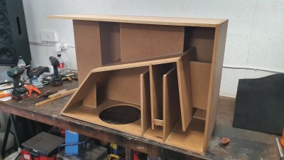

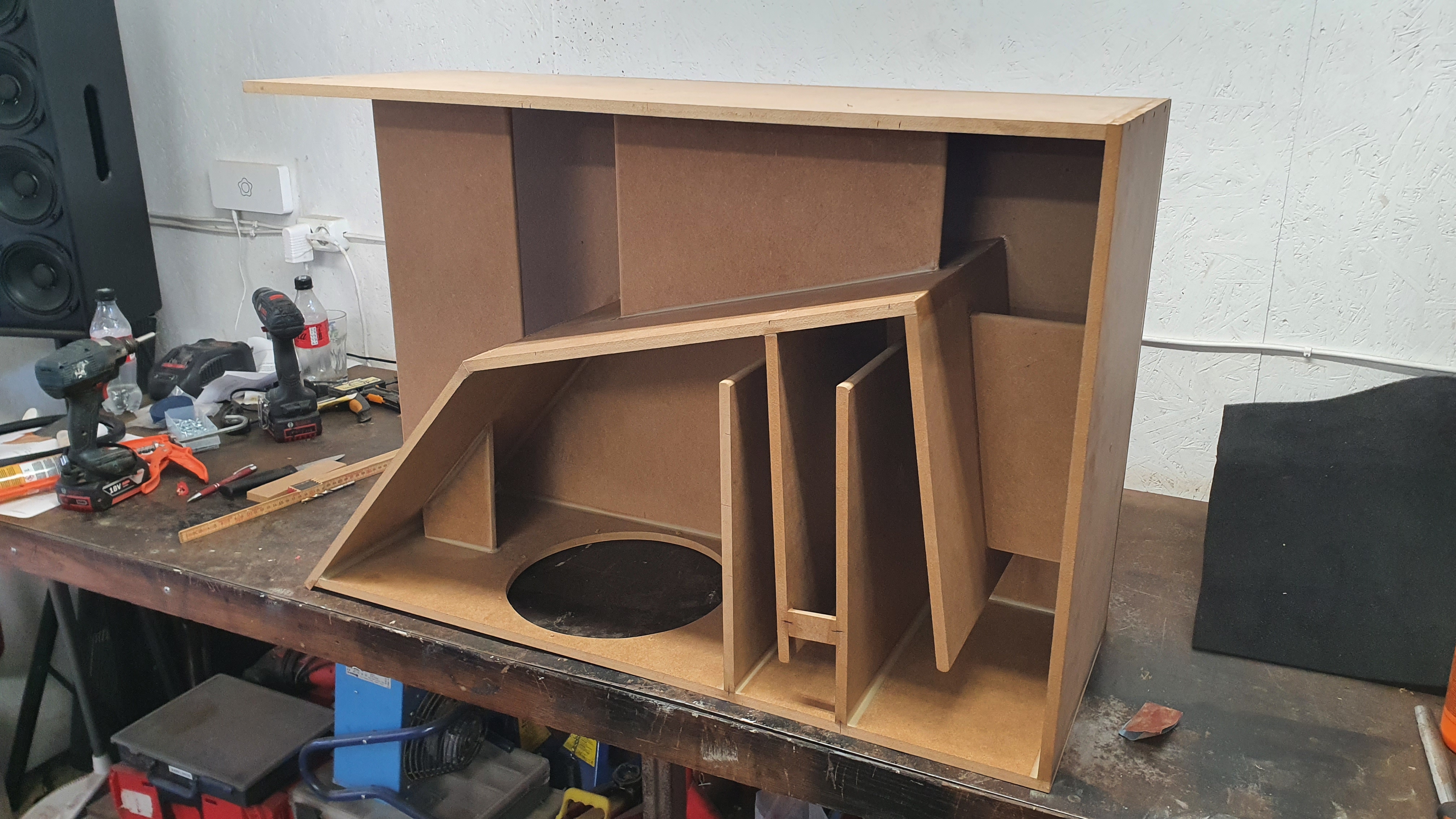

Throwing up a pic of my slightly oversized experiment TRT
