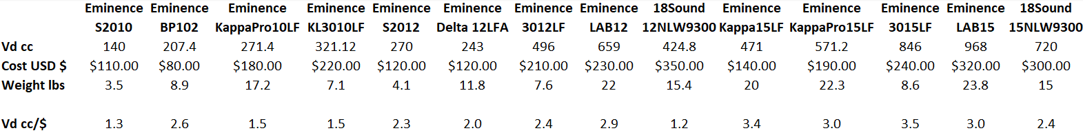

Here's a full quick reference cheat sheet for anyone interested
Interesting Stats Prices are either Amazon or Parts Express, whichever was less... except for the 18Sound drivers. I could only find them for sale on ebay (new).
Looks like the 3015LF in a T48 is about the best output for your money.
Maybe I'll get around to factoring in the lumber cost sometime too.

Scanning the chart, I happened to notice that the Vd/$ is the same as Vd/pd for the 18sound15. Thanks, though, for your effort.
Re: What's to chat about?
You're right Tom. Fixed and re-uploaded the pic. Thanks for pointing that out. I 10-keyed all the stats in there like a pre computer era credit card accounting agent. There could be some fat finger mistakes. If you guys see anymore, please point them out.
