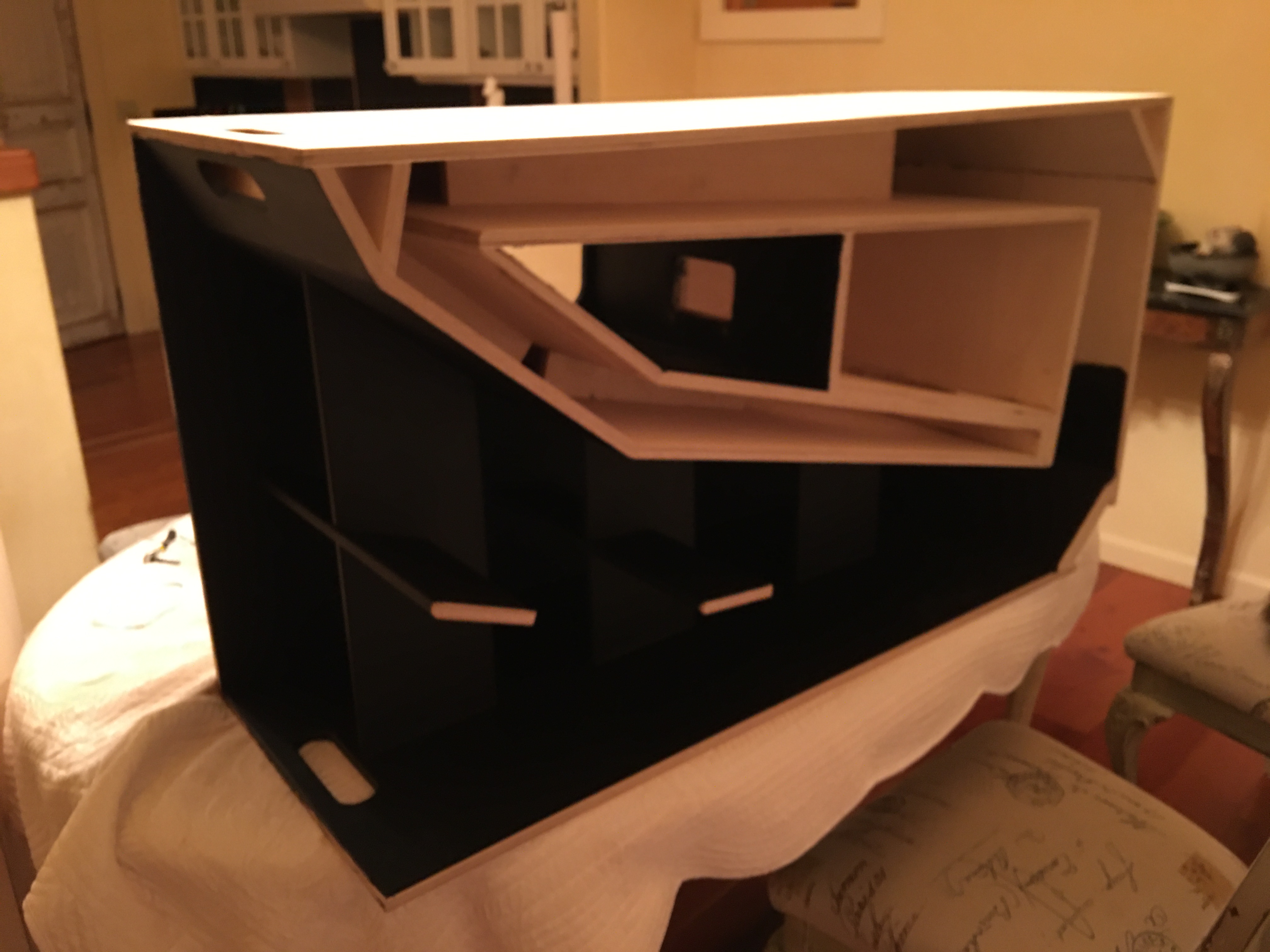

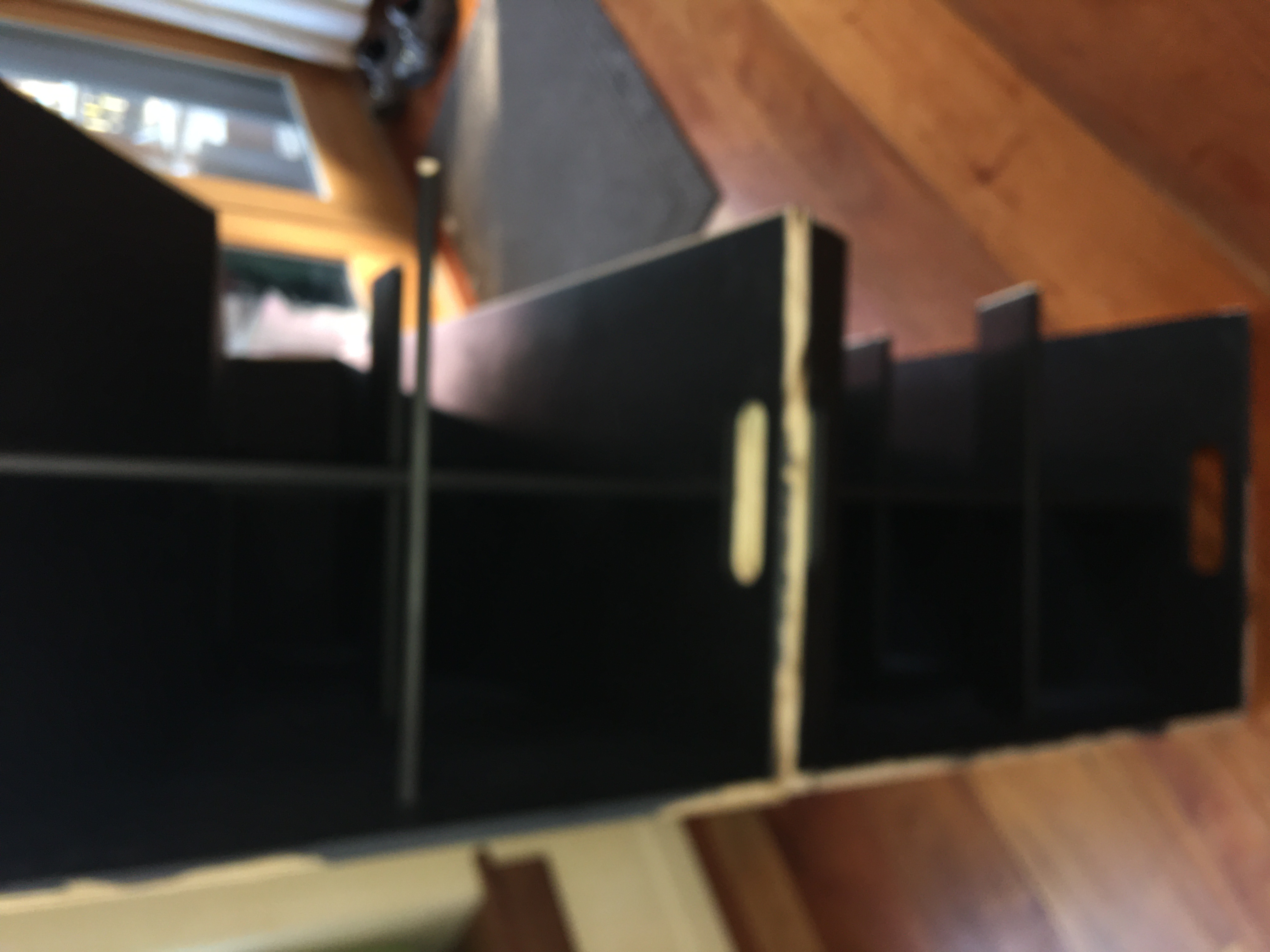

Paul and Rob... that's looking really good.
What a great job. The build quality is very apparent in the photos. I really hope the results meet your expectations, given the few modifications to the plans.

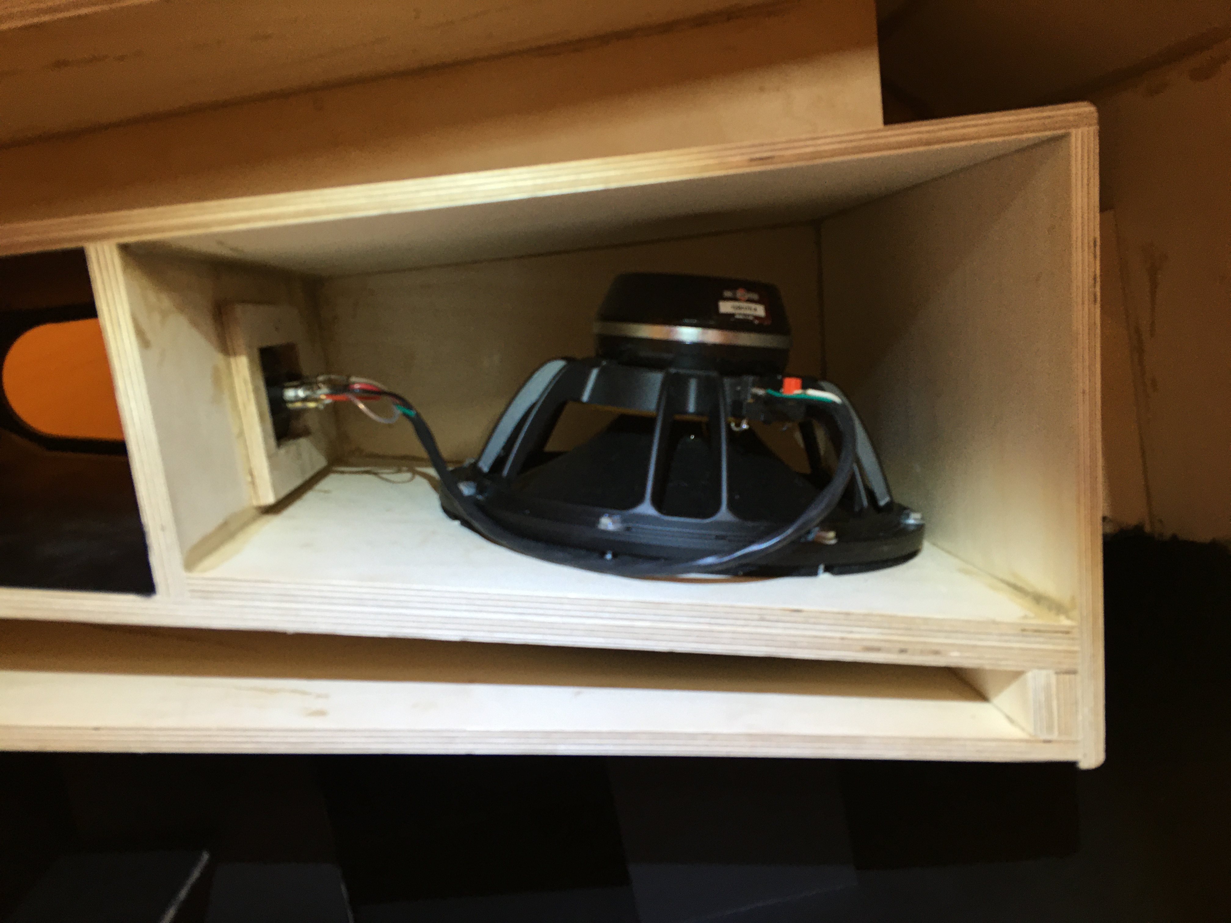

One thing I thought I'd mention... it's not something I've experienced personally, but it's come up in conversation a time or two. You'll note that the plans advise screws to secure the drivers. IIRC, the plans were modified a few years back to screws and retention blocks, from bolts and hurricane nuts because they hold better without backing out as much and they wont cross thread, push out the back side, or strip and spin as easily. I was thinking thread locker would be good to keep them from backing out, but it could also contribute to spinning the inserts at a later date. What's done is done, and I'm sure you'll handle it appropriately if it ever becomes an issue. Really, I just mention it for the benefit of casual viewers/future builders to be aware of.
Other than that little tidbit... I'm super excited to hear of your impression once they're all buttoned up, painted, and tested/in service.

Yes, we went with the double baffle and 1/4" lag bolts. Torqued them to 5.5nm. They do not protrude through. They should hold fine as long as the gasket on the woofer doesn't shrink...
