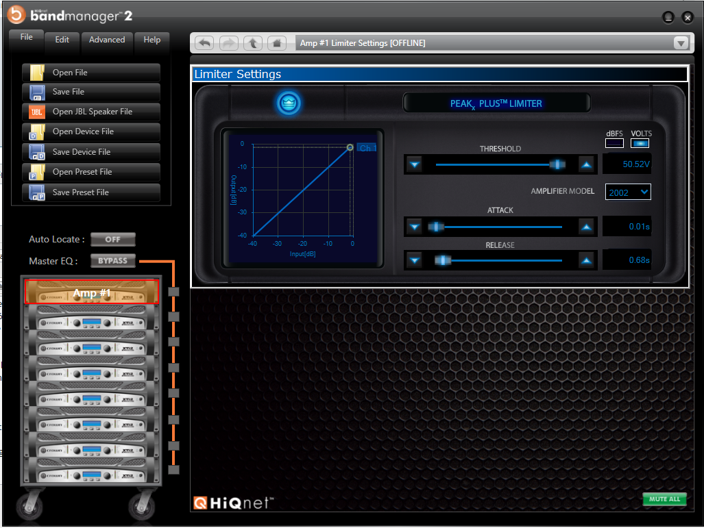

I remember someone else having questions about the Xti series and looking into that with you a little while ago and really liking the PC app and Graphic User Interface, "Band Manager". From what I recall, I wanna say it did have an appropriate peak limiter.
Just downloaded the app again and looking at it's limiter options, it should be suitable. Attack can be set as low as 0.01s and the limit can be set as either dBFS or voltage, which is handy.
Looks to me like it's a valid option. But, I too would like to have one in my hands with a meter on it to verify before pointing people in that direction. Or, at least have a conversation with one of their techs about it. I do love the interface though. Darn cool.
