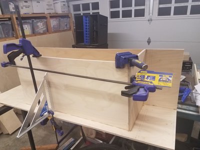

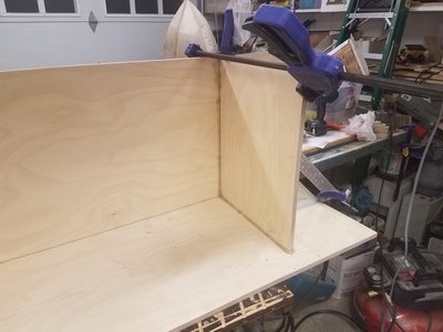

I'm finally getting going on my TLAH and SLA ccurve build. All of the panels are cut, the TLAH boxes built, and the plywood is ripped for the TTLS - I just need to do some cross-cutting and of course cut the angles for the braces.
Here are the TLAH boxes getting started:

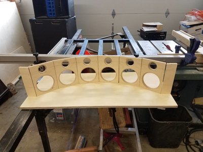

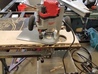

After discussions here about the best way to make the woofer holes, I tried:
  • A holesaw
  • Router, up-spiral, jasper jig,
  • template and pattern bit
I decided that the jasper jig was the easiest, as I just need to drill a 1/8" pilot hole through the baffle (and into a backing board) and then use the jig.

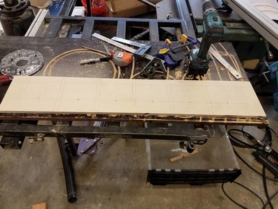

First I tacked the curved SLA baffle to my work table with a few brads, nailing in the 1/2" wide strips that would be cut away:

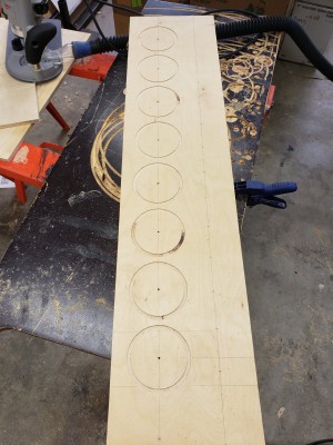

Then using the router, spiral bit and jasper jig, cut the woofer holes:

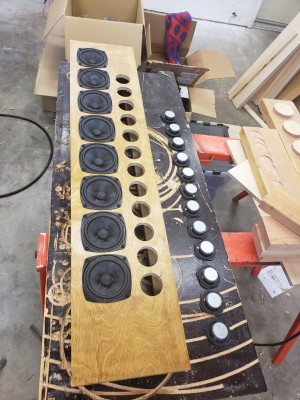

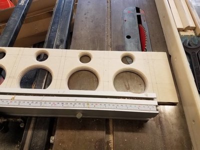

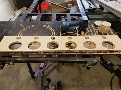

I used a Forstner bit for the tweeter holes - it makes a very clean cut. Here is the baffle with all 12 holes:
Next I changed out the plunge base for the regular base, and mounted the 3/8" round-over bit and rounded off all of the holes:
The final step was to make all of the angled cuts in the panel, leaving me with 8 pieces. Here is a dry fit of them standing up:
A careful reading of the instructions reminded me that I now need to sand and finish these pieces before I glue them together. I also need to make the jigs that will allow me to make symmetric pilot holes for the mounting holes for the drivers. Tomorrow while the stain and polyurethane are drying, I may try to get the first couple TTLS panels assembled.

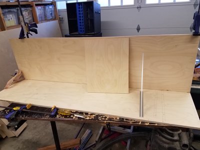

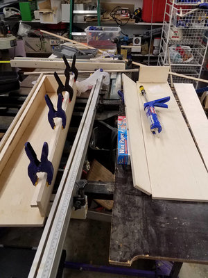

I'm making a little more progress - I started on the TTLS.
Here are the first 3 panels installed:
I also have panel 4 in. Now I need a driver before I can go an farther. Perhaps I'll order it today. I'm leaning toward the 10" Dayton.

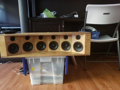

Only 2 1/2 years later, I am finally making progress on this build again! We are doing a major house remodel, and I want to set up our new den as a home theater (or at least have really good audio when watching TV)

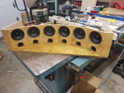

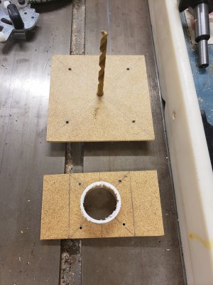

One of the things that took forever on the curved SLA was the decision to rear-mount the drivers. I needed to build templates to accurately place the 4 mounting holes for the drivers. Here are teh jigs I built:
After drilling mounting holes and mounting drivers, it is starting to take shape:
The woofer template uses a wooden disk to center it, while the tweeter uses a bit of 1 1/2" drain pipe. I also went through several iterations before settling on 5/8" long screws.
Here is the finished speaker:

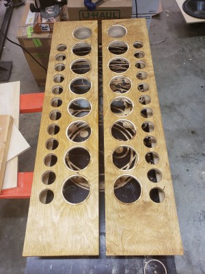

I decided that for the TLAHs I would front mount the drivers. I also changed course and decided to use the Dayton driver instead of the Goldwood. It is lighter, and (in another thread) Bill recommended it. It has a built-in gasket on the back, but needs an annular ring for the gasket to sit in. I used the router and Jasper jig to rout out rings 4 1/16" in diameter and 1/16" deep:
Next I routed holes 3 11/16" in diameter. I needed to clamp a piece of scrap inside the enclosure to hold the disks that were being removed and keep the router centered. Here are the first set of holes:
The tweeters fit nicely in 1 15/16" holes made with a Forstner bit. Here are teh two enclosures drilled and stained, ready for poly:

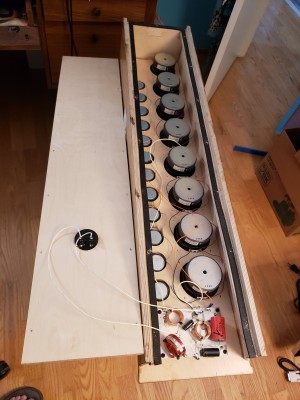

I have finished my pair of TLAHs. Now if the contractor would just install the roof on my addition!

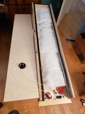

First I mounted the woofers - the annular ring fit pretty well, but could have been a 32nd deeper:
Next I installed the wiring:
Then I added batting. Ordered on Amazon, 2 yards x 48" was just about right for a pair:

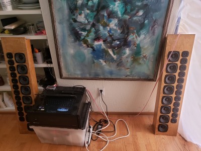

Then with two of them, and my eBay 16 channel amp, at last a test:
They sound quite good, although there is clearly bass missing. I didn't try dragging one of my Titan39s up :)
