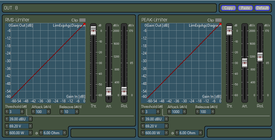

Hi to all, soon the T60's will be finished :). I have a question about setting the limiters, for the LAB12 and LAB15 drivers, in the plans it says, that the voltage limit for the 12 is 50V and 15 60V. I will have a class d amplifier driving each box separately, the amp is rated 1000w 8Ohm peak, it has a built in dsp, with RMS and Peak limiter, should I set them both to the voltage limit?, or should the RMS limiter be lower?
Best regards
Posts: 8715
Re: T60 Build, limiter settings
#2 Post by Bruce Weldy »
Set 'em both to the correct voltage.....BUT, also put a volt meter on the outputs and check them before ever connecting a speaker. If you don't know how to do this, we can tell you how.

Bruce Weldy wrote: Thu Jul 16, 2020 10:22 am Set 'em both to the correct voltage.....BUT, also put a volt meter on the outputs and check them before ever connecting a speaker. If you don't know how to do this, we can tell you how.
So, RMS and Peak both to 50V (Lab12) and 60V (Lab15). Yes, I know how to meausure voltage, I will feed them with an 50Hz sinewave, because I don't have a true RMS meter.

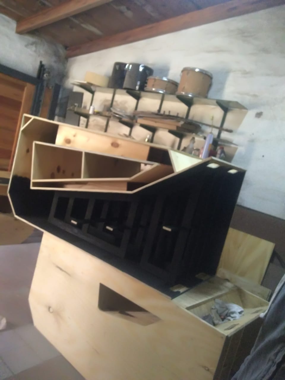

Here some pics, almost done :)
