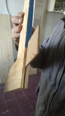

I could make them like this, what do you think?

#17 Post by Grant Bunter »
They are braces, use another type of glue.
Or make the braces without joints at all, from a sheet of ply.
My concern would be, if it’s not holding the braces together, it’s probably not holding the panels to the side either. So you need to find that out...

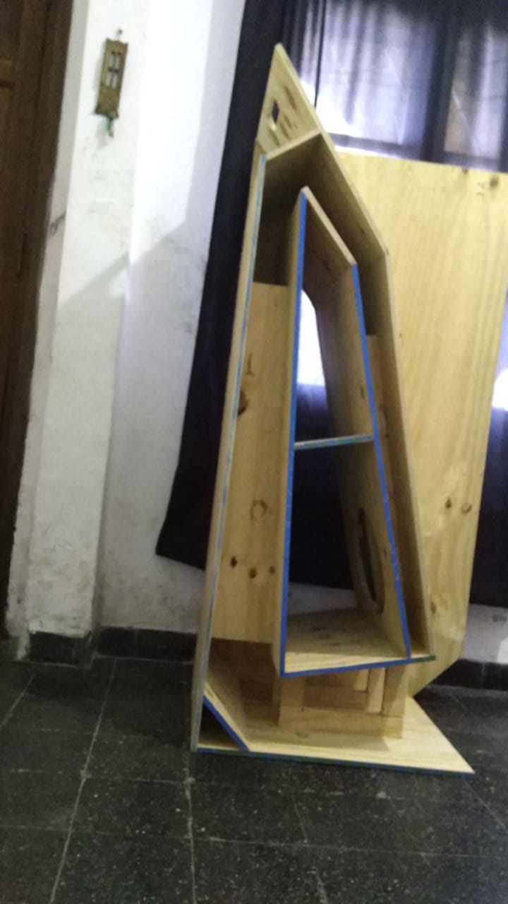

Hi, the other panels are glued ok, no problem at all, i't might be that is too little surface area so they snap easily (braces). I attach one picrue.

jimbo7
Posts: 875
Location: St. Louis
Re: T60 Build, problem with braces
#19 Post by jimbo7 »
I assume you are trying to save weight. Could you cut the braces using a full piece of plywood and then plunge cut the holes out with a jigsaw? Or use a hole/cup saw and make a bunch of holes?

jimbo7 wrote: Thu Jun 25, 2020 4:16 pm I assume you are trying to save weight. Could you cut the braces using a full piece of plywood and then plunge cut the holes out with a jigsaw? Or use a hole/cup saw and make a bunch of holes?
Hi, yes I could, but I have already cutted all the pieces, and to do that I'll have to buy more plywood.
I will show pictures of the finished braces soon.
