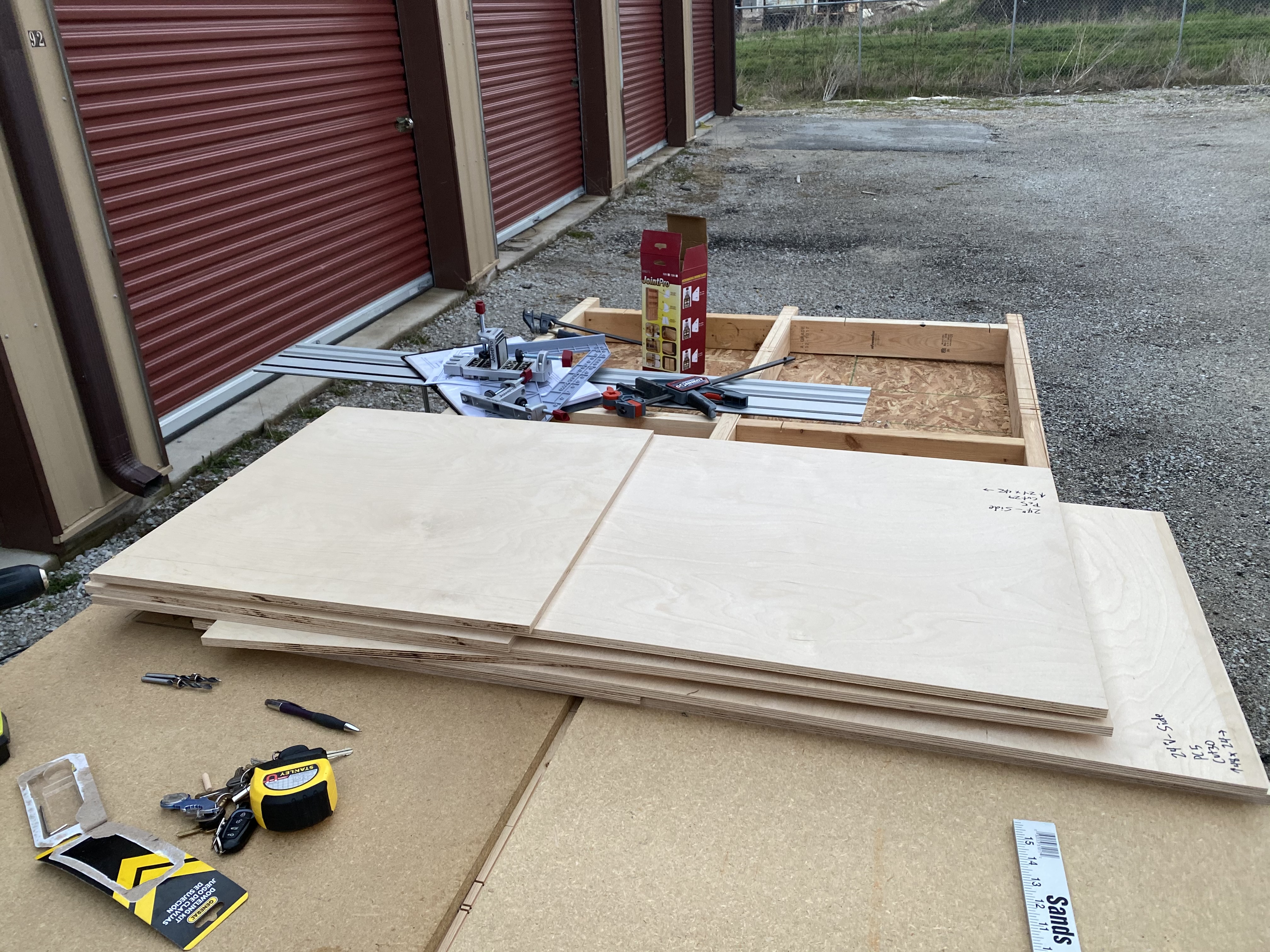

Build Session #4 - Time .. about 1.5 hours
OK..it rained most of the day so I didn't get so much done.
I cut the last sheet today. Easy.
Trimmed all panel 1s then drilled out all the dowels from side to panel 1.
Used dowel jig for the panels. That is it for today. Hopefully glue those up tomorrow!

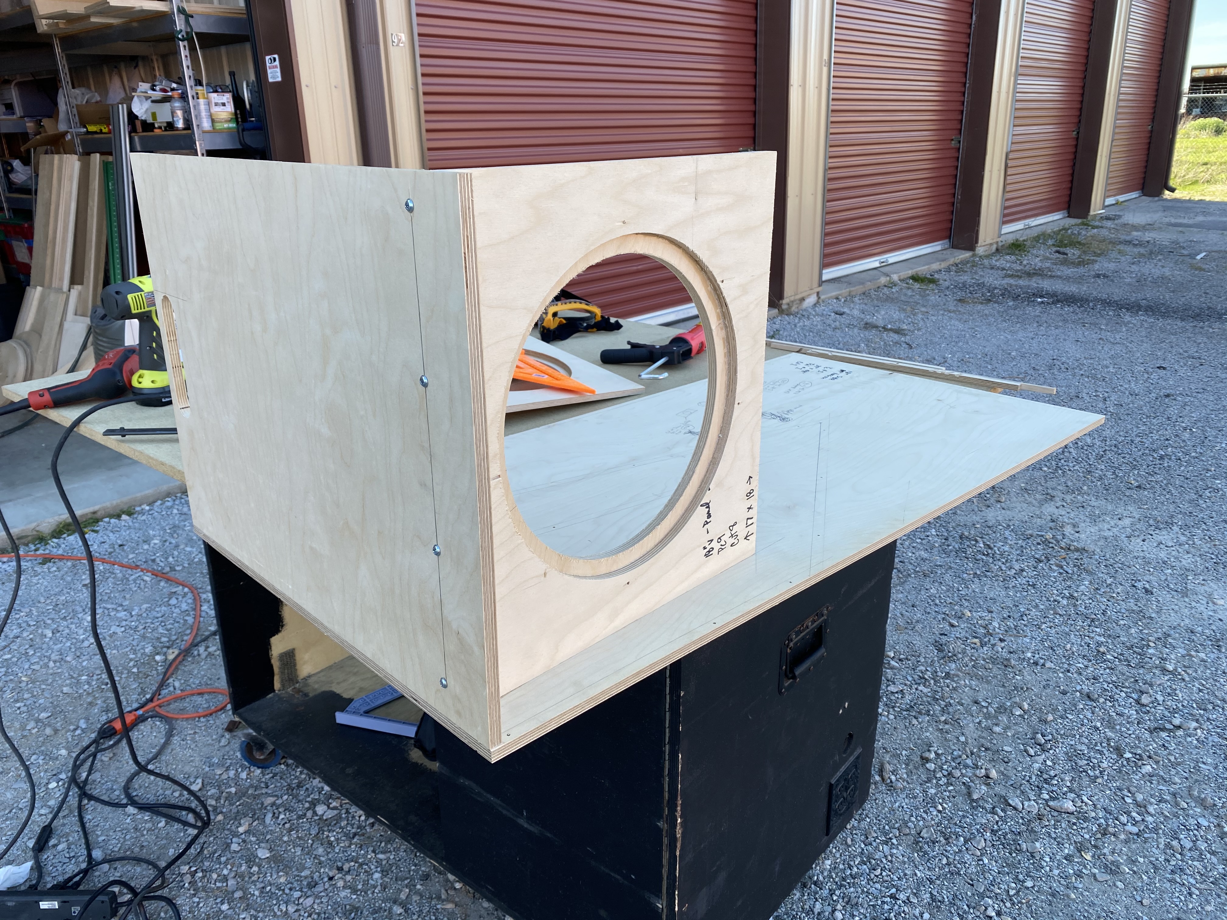

Build Session #7 - Time .. about 3.5 hours .. Total time so far 18 hours
Ok.. cutout the anchor plates, routed the holes and attached some baffles.
I did not bother cutting off the corners on the anchors. I just sanded panel 4 a little bit on the corner to make them fit tight. This is where I had wished I new where my brad nailer was. I actually found it the next day!! I had to use screws on the baffle/anchors because I didn't have enough clamps for all 6.

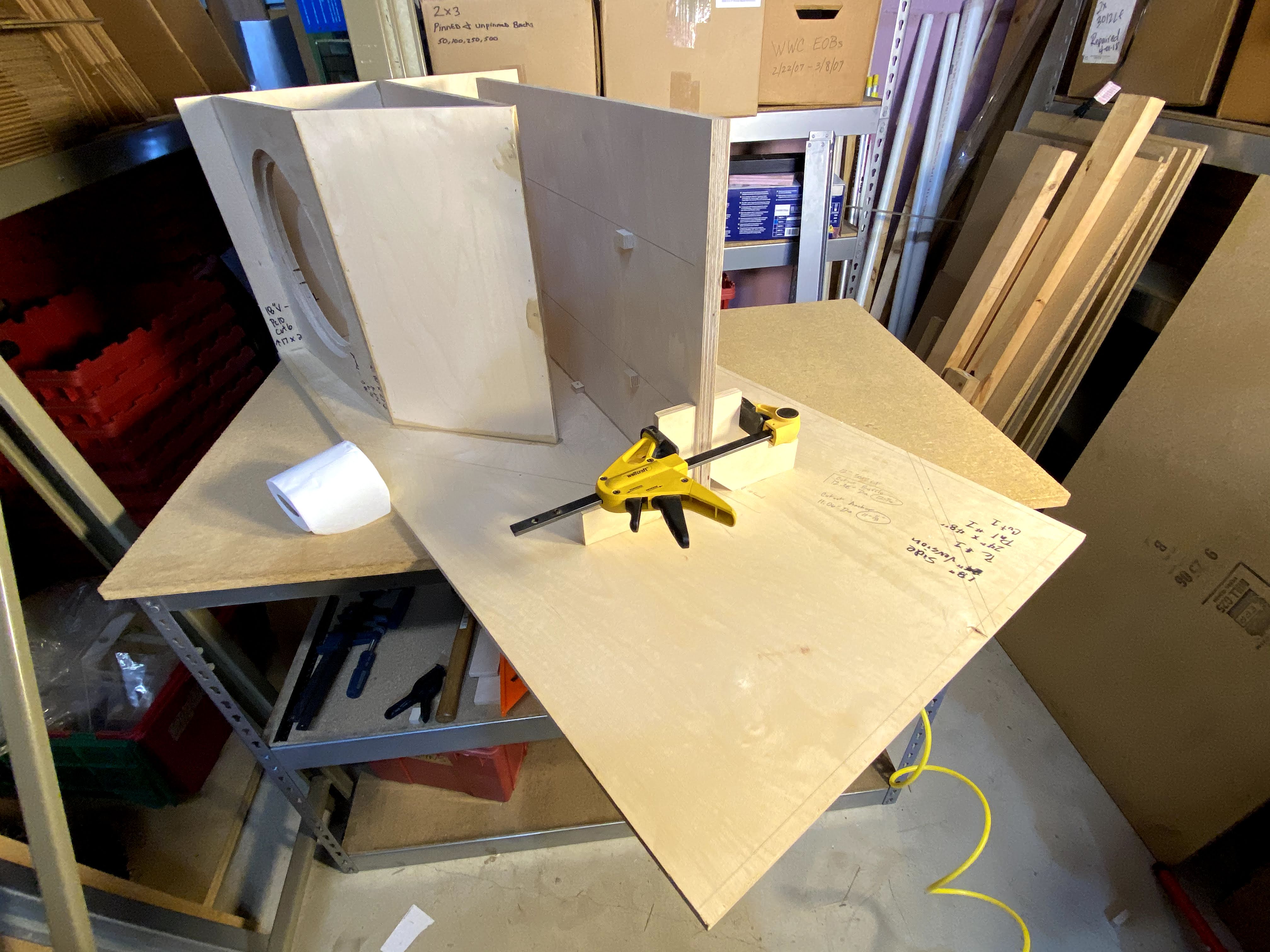

Build Session #9 - Time .. about 4 hours .. Total time so far 26 hours
Today I finished up the panel 3s and panel 4s.
I learned from panel 3 that you should used a scrap pc to make a measure jig to cut the panel to final dimensions. I just looked at the book and cut them to that size and they were all about 1/8" too long. I was re-reading the plans again and noticed it says that the numbers given are estimates and you must measure your own build to accommodate your own specifics. From panel 4 on will be totally accurate using this method.
I just took a scrap pc and cut the angle on it then placed it on the side to mark where to cut the panel to final dimensions. Worked great.
I nailed scraps to the baffle to hold alignment for panel 4. I used a couple screws on the panel 3/4 joint to get a good bond and nailed everything up. I accidentally used 1" nails on the scraps and they shot through a little. I just patched it up with PL and used 3/4" from then on to hold scraps. I also put 2 scraps on the inside of panel 4 line to hold into place.
